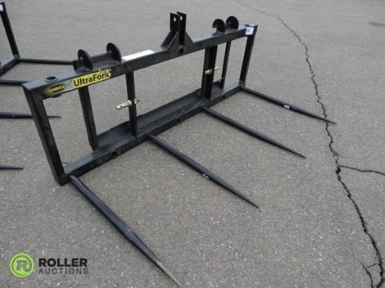

Good build. :thumbsup:
I lucked on to a Speeco UltraFork on craigslist several years ago. The guy sold it because with the 31" long spears, it wouldn't hold a 5x6 round bale.
I added a longer bale spear, by bolting the base to the center top hole and 3 point toplink bracket.
Now it works greatly on the front and rear. :D

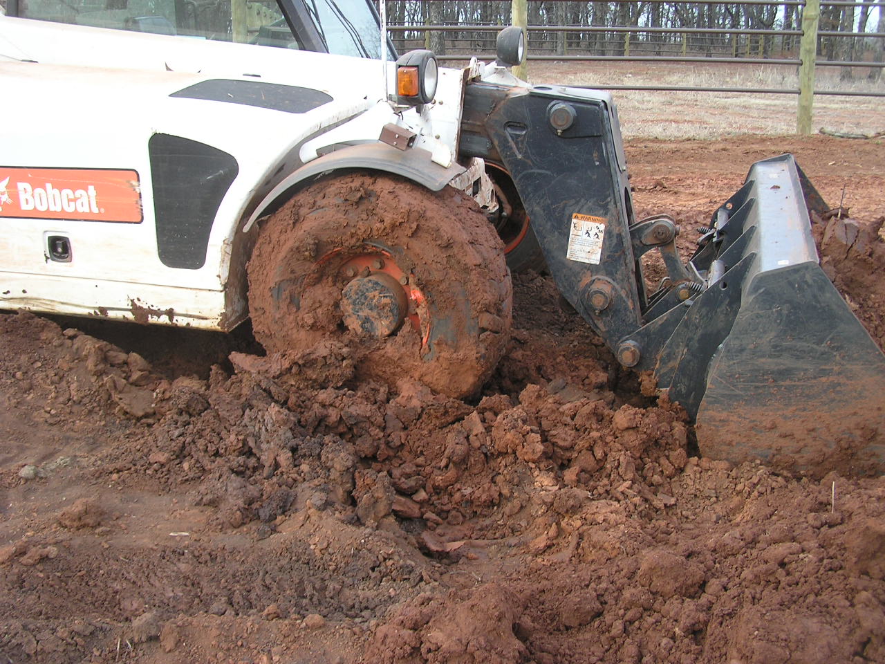

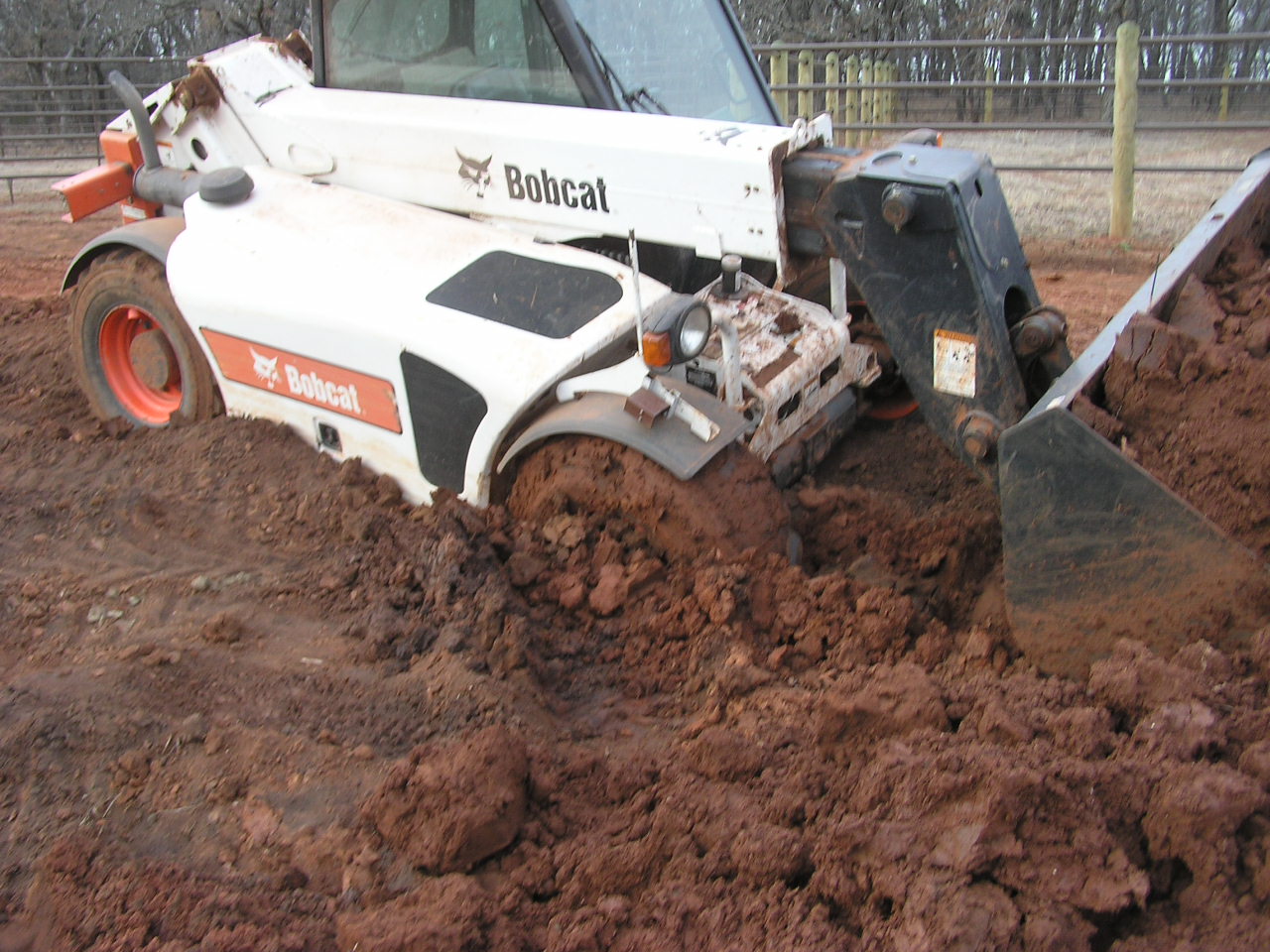

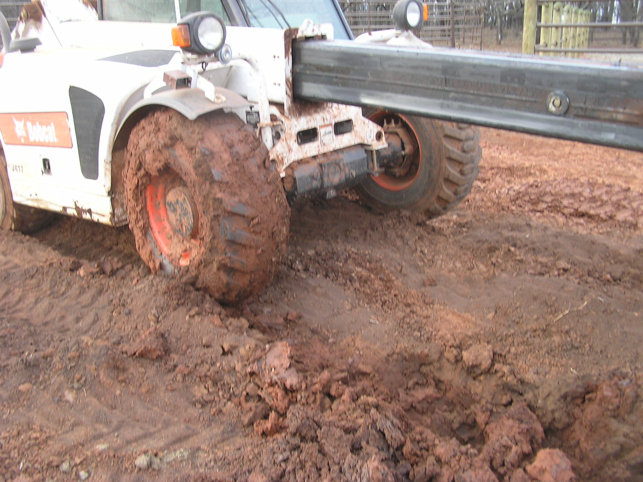

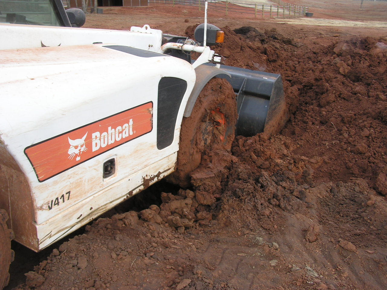

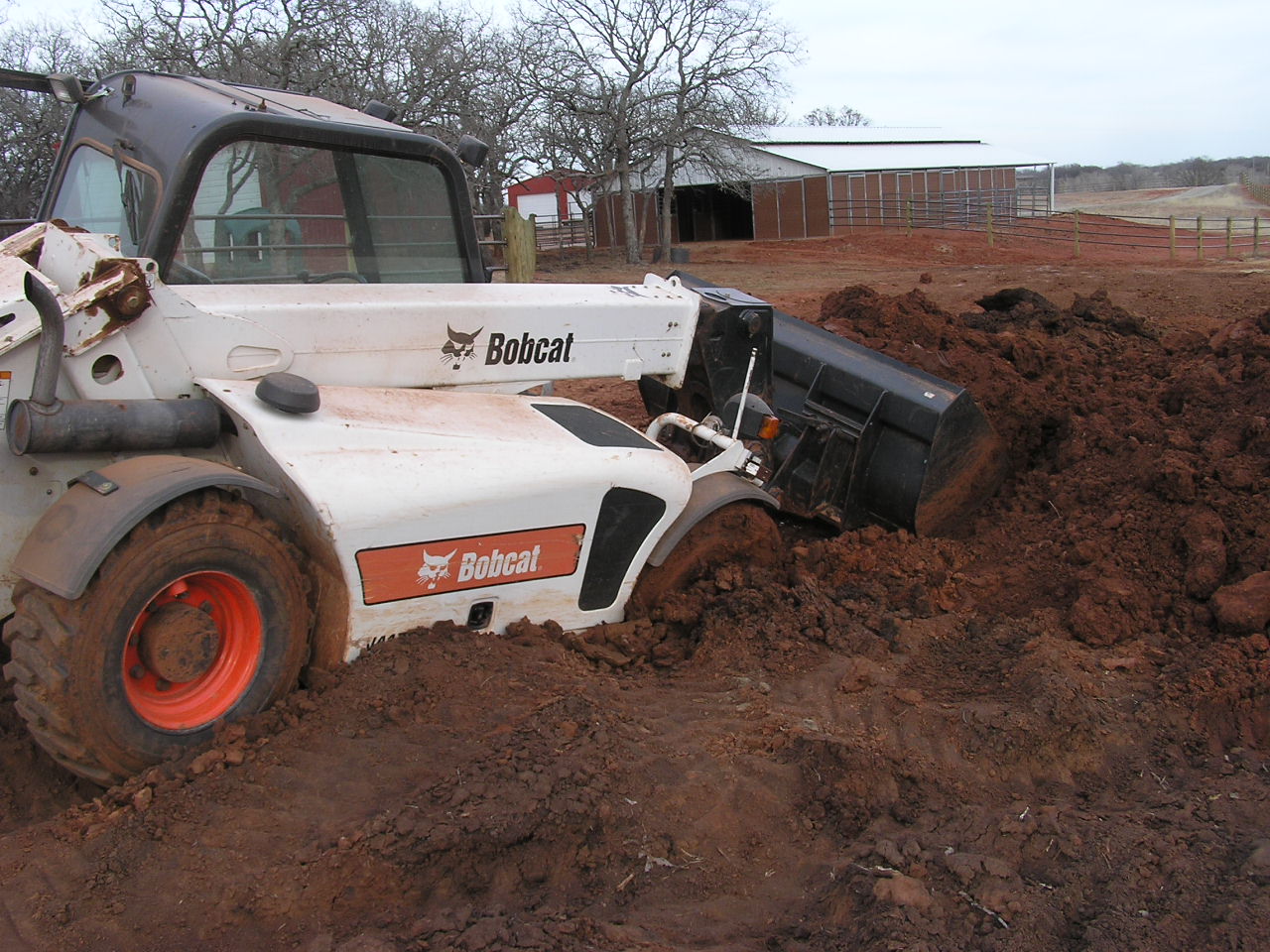

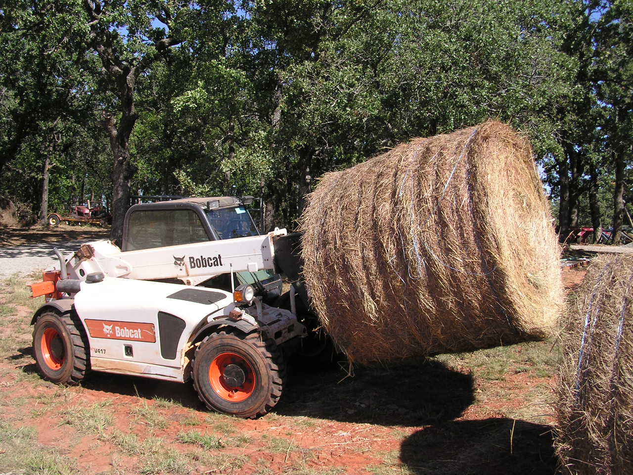

That small telehandler looks like the perfect machine for light construction. How does do it handle heavy mud?
   / round bale spear attachment #4
It would do better with R1 tires, but it is unstuckable. :thumbsup:
I was spreading/leveling some dirt and silt and found a silt spot.
Lowered the bucket which lifted the front end up out of the silt.
Put it in reverse and extended the boom, not stuck now :thumbsup:.

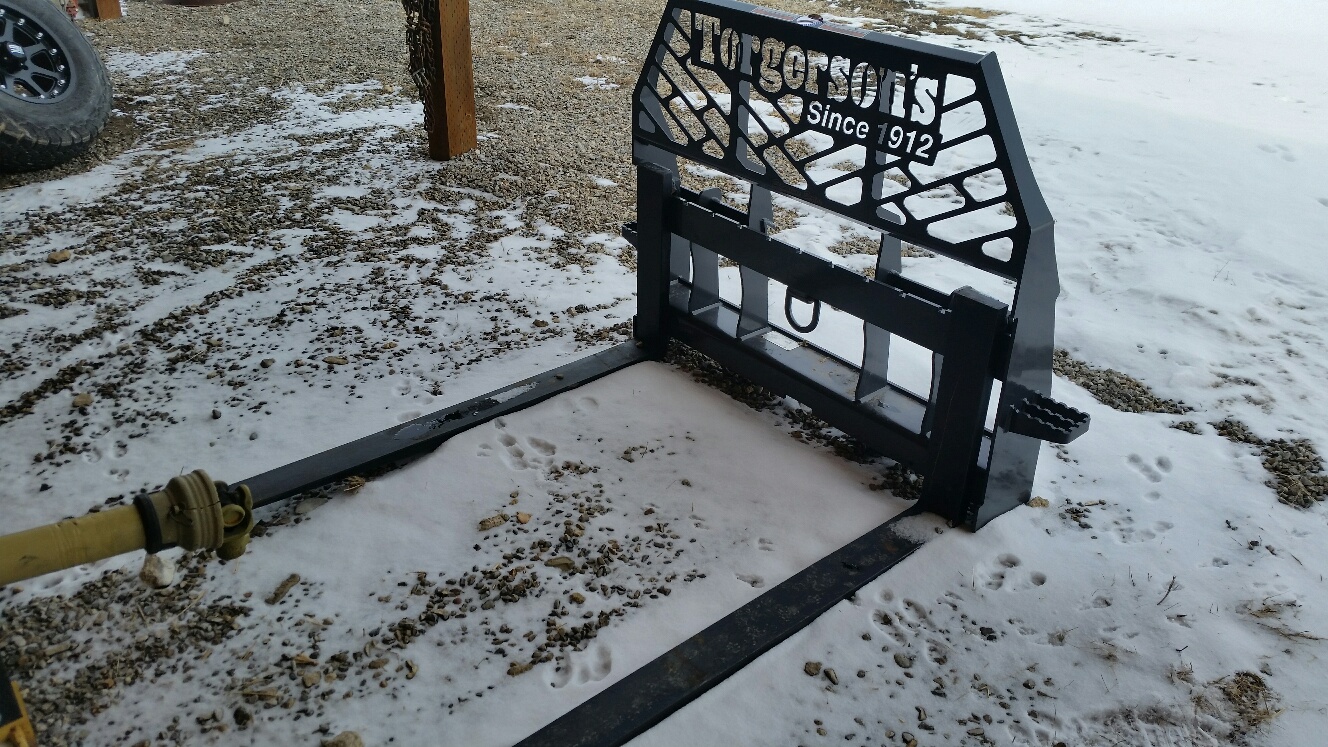

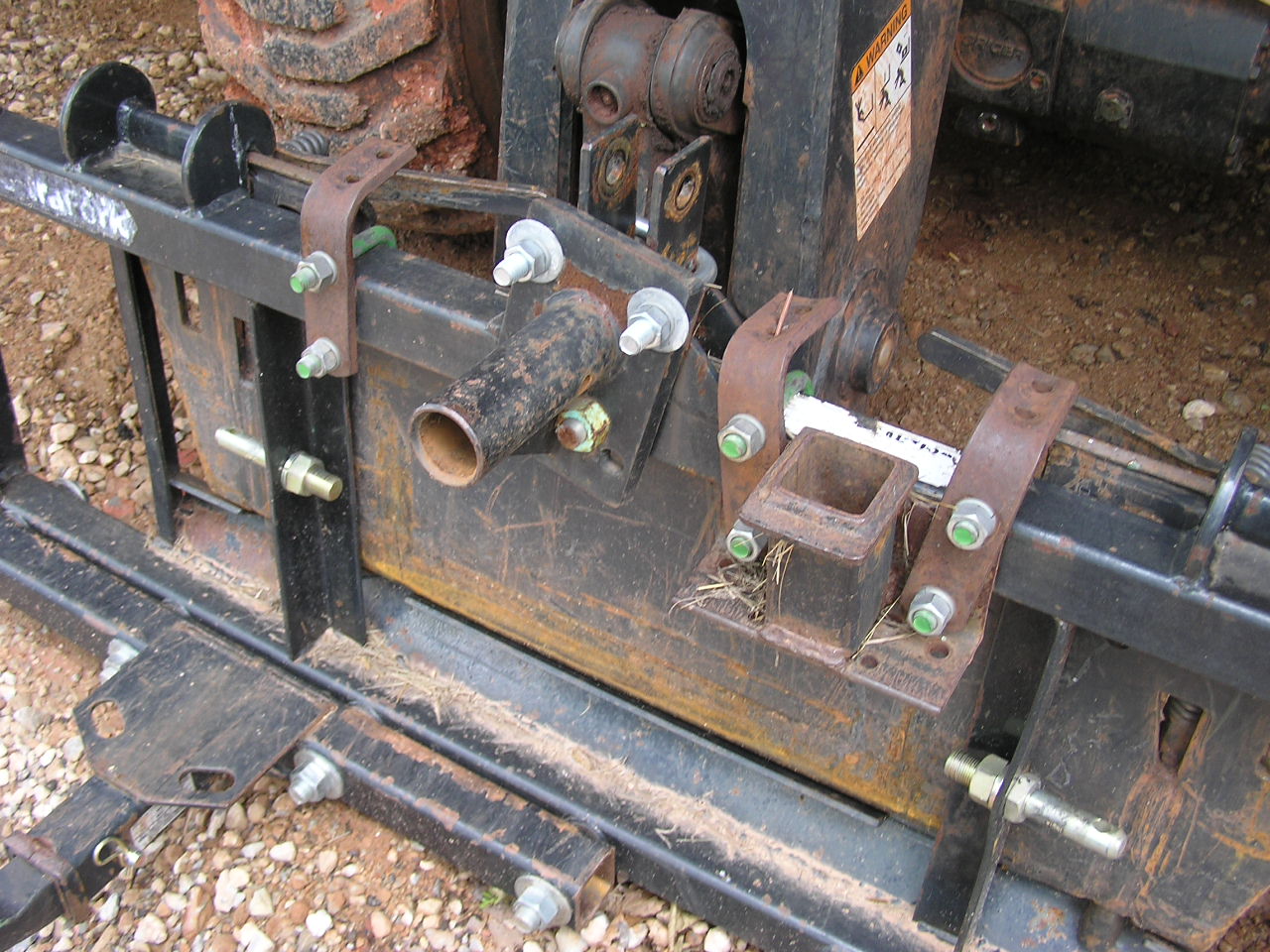

So I got a nice set of pallet forks with my tractor. The actual forks are adjustable and they come off of the base. Does anyone make a bale spear that would go onto the base I have for the forks? I don't have a picture, but I can take one this weekend in the light.
   / round bale spear attachment #6
Titan makes a pallet fork/ bail spear combo. They also sell the spears separately do you have this setup? I have the 42" forks. No problems at all.
Titan Skid Steer 36" Pallet Fork 49" Hay Bale Spear Trailer Hitch Attachment
   / round bale spear attachment #7

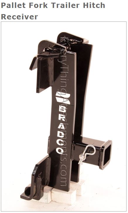

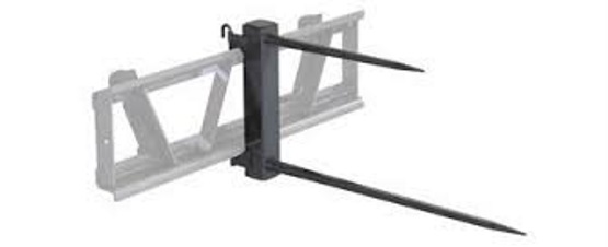

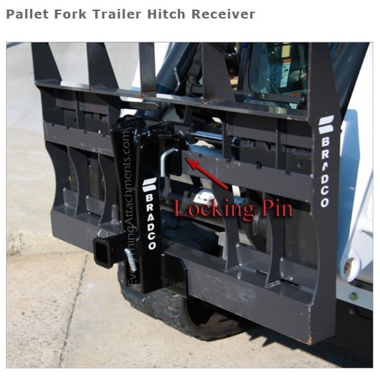

EA makes one and a receiver hitch also: Double Bale Spear for Compact Pallet Fork Frame
   / round bale spear attachment #8
That is really cool. I like the receiver hitch, that would also be very useful. This is what I have, it a Paladin Industrial Series. Would love to get something like the above setup.
   / round bale spear attachment #9
   / round bale spear attachment #10
Awesome, thank you. My tractor is a Case and I got it and the forks from the local dealer, so they should be able to order me one.
