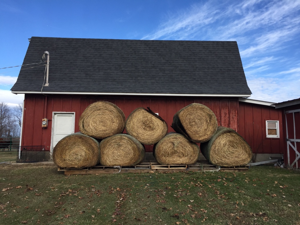

026.jpg027.jpg Nine bales on 2 pallets high for the Minis
   / Round Bale Storage
That's what I ended up with, I can do 4 on the bottom and 3 on the next tier, 7 stored plus one in the feeder should be enough to last most of the winter.
Just healed 6 more bales today for $20 a bale
   / Round Bale Storage #11

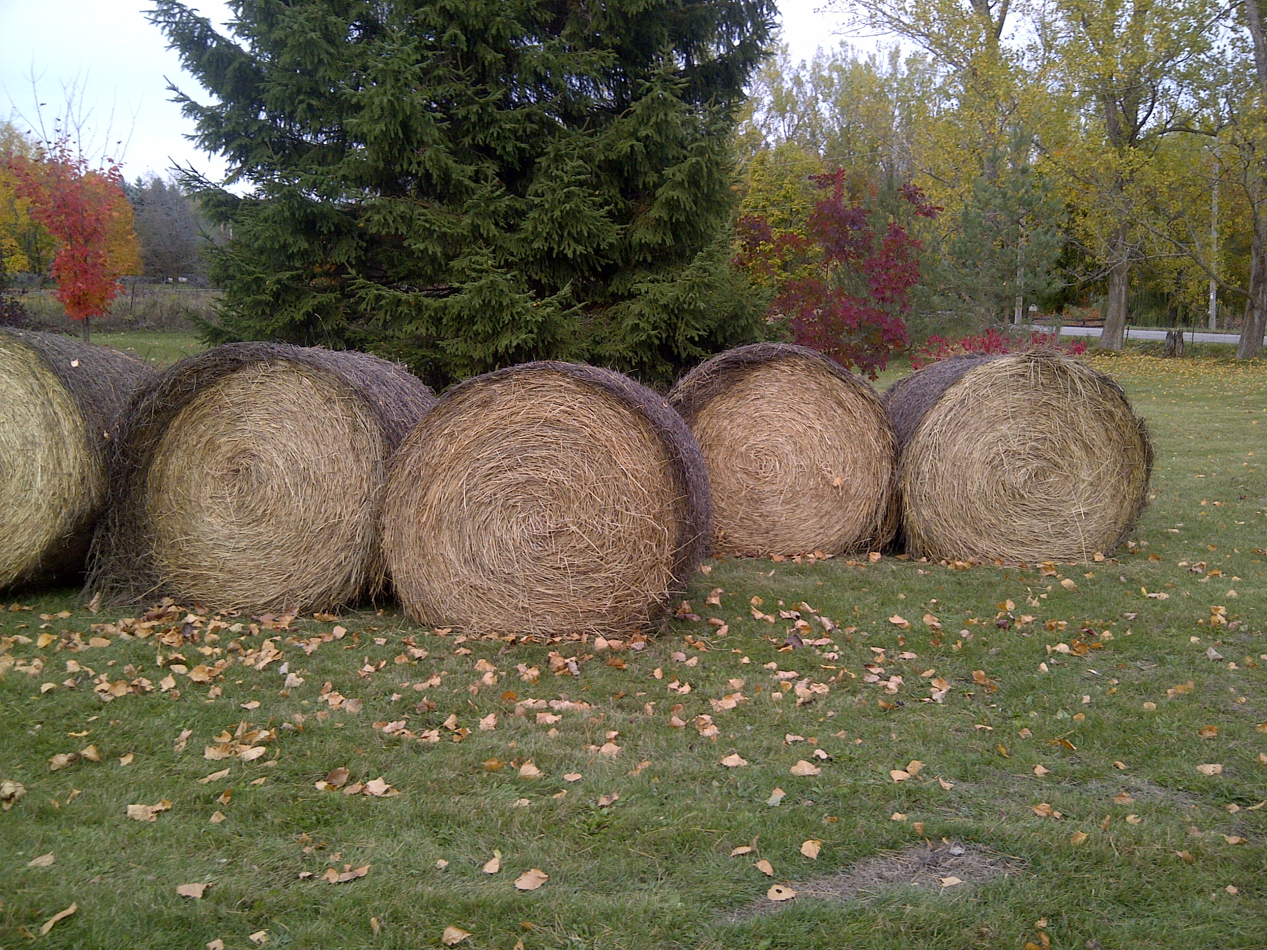

In post #9 just stack the bales so they are not touching, this lets the rain run of without causing bale to rot at the contact point.
Find out if "shower hats" are still made for big round bales. They are a fitted black plastic "hat" with an elastic to hold the hat on the bale. You stand the bale on its end and fit the "hat" ,again bales should not touch other bales due to rot. They withstand high wind but not full on gales. I have not seen any around for years as everyone has gone to pit or wrapped silage now.

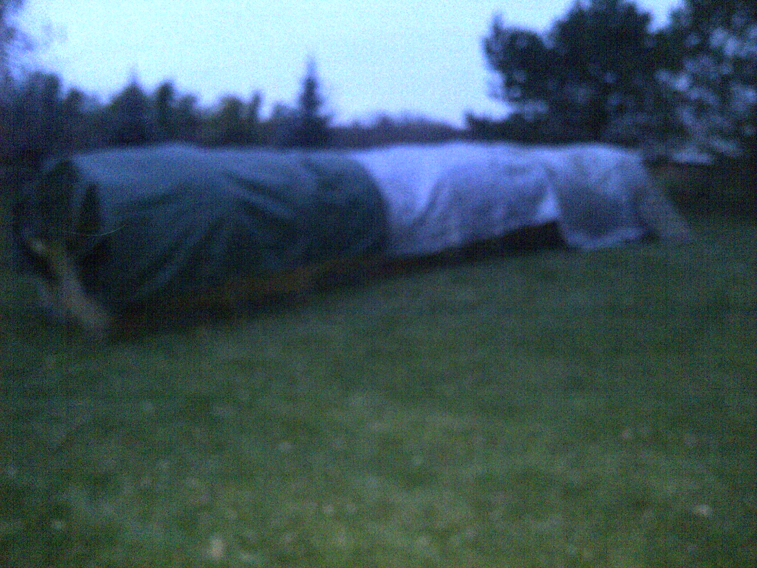

Just got it all stacked today and covered with a big blue tarp. It will be all gone in 7-10 weeks by the way my cattle eat.

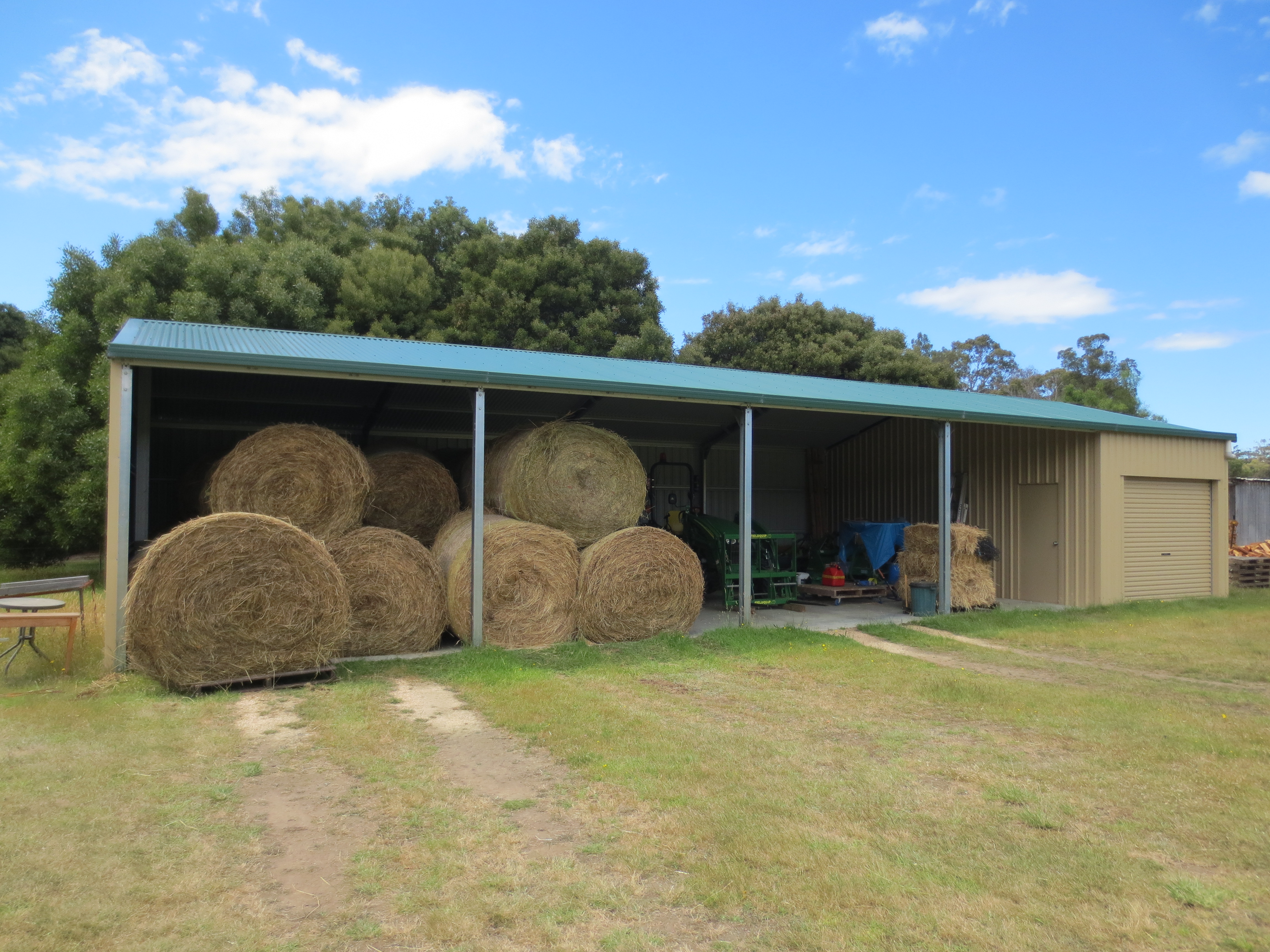

I know that the OP doesn't have a shed to store but I couldn't resist posting a picture of the 34 rounds I've just stored in two bays of my shed... it would have been 35 if not for that pesky frame. :)
The local hay crop was huge this year! So much so that there're rumours about a second cut this year... except no one's got room to store it!

Here's an update, I never got a picture after I tarped it. it's been raining and super windy last few days.
   / Round Bale Storage #20
Rpw, re your tarps, patch the holes or replace as needed ,then tie down with a net. This net over tarp system works well in high wind areas as well as a full gale. When you tie the weights to the net make sure the weights (I used old car tyres) are off the ground. This keeps the tension on the net and stops the wind from shredding the tarp under the net.
