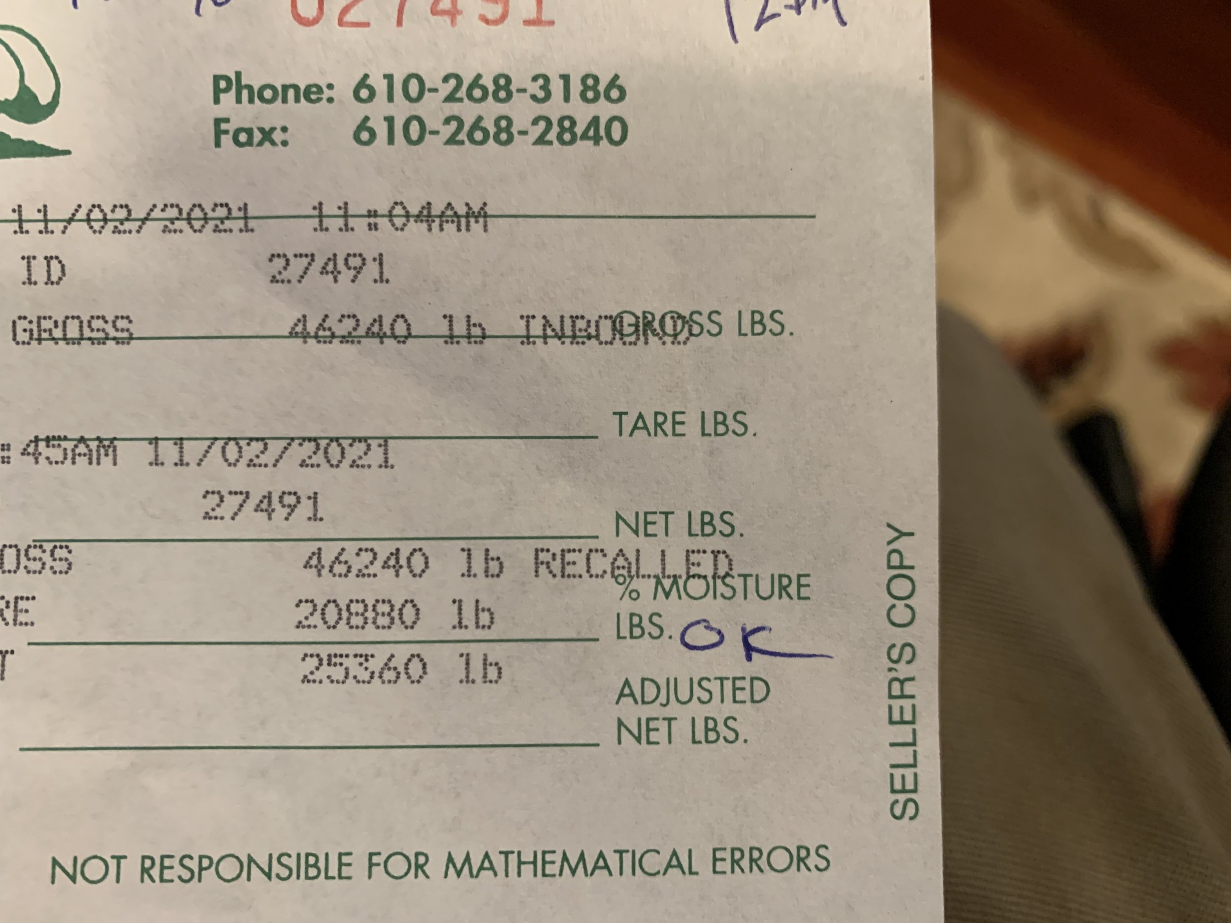

Nobody cares. It’s just a bunch of farmers delivering hay. We understand it’s loaded weight in and unloaded weight out.
Heres one from another one of my customers. Maybe you’ll like this a little better

Hey, I said it’s handy to have a scale nearby. Was that offensive? I’m pretty much over this. I said what was on my mind.
