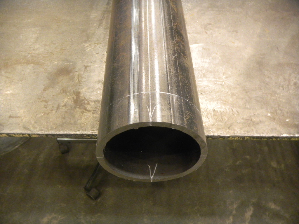

Back in my Jeep and off roading days, I would just use a piece of scrap to draw a line on the pipe to notch, then cut it out with the torch. Clean up the edges a bit with the grinder, and weld it together. It only took a minute to cut out a notch, and it was really simple and easy to do.

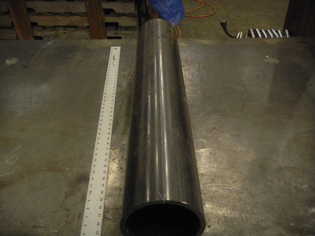

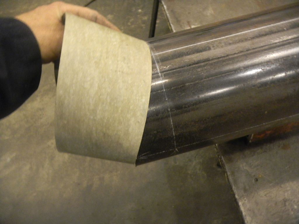

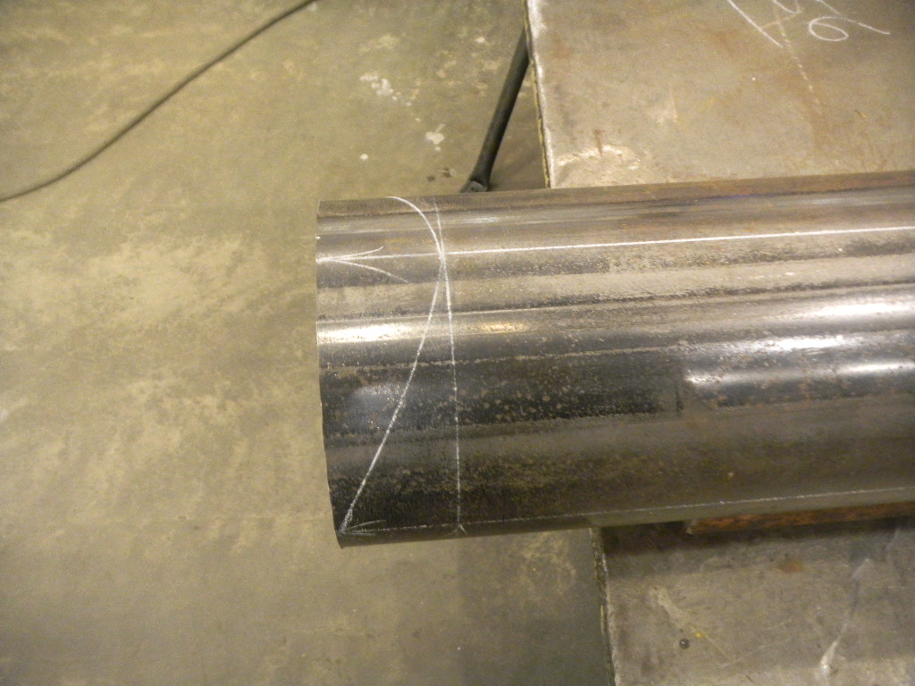

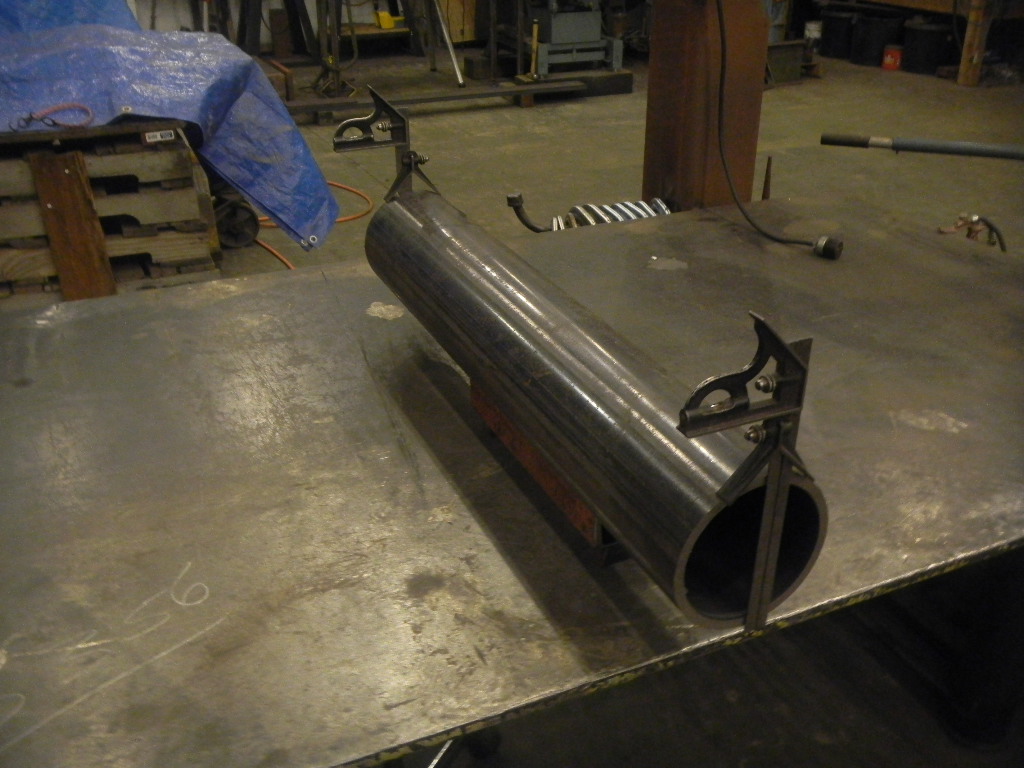

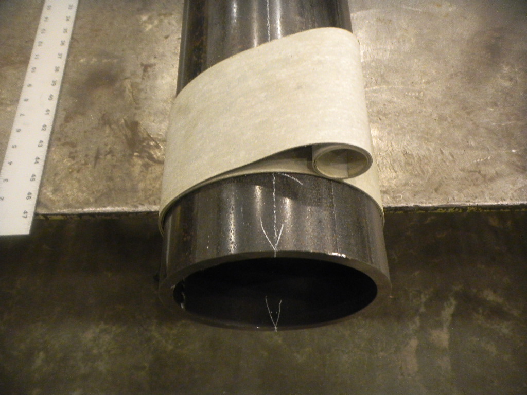

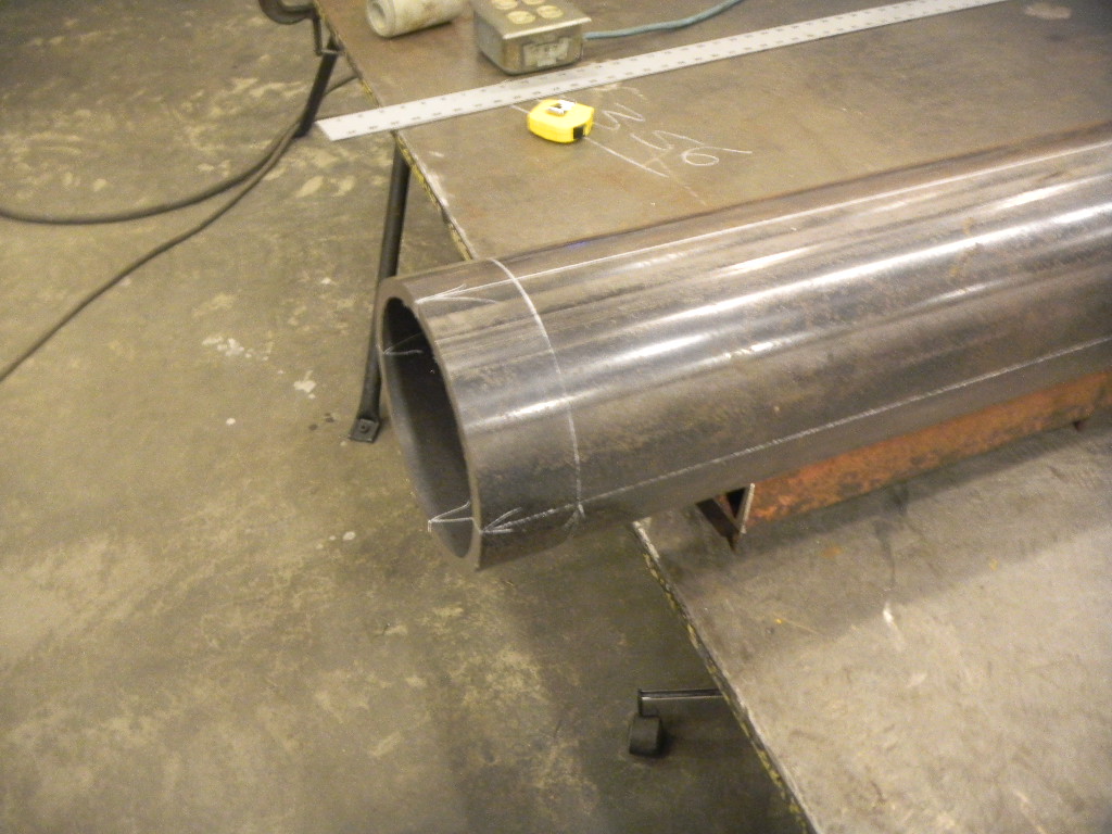

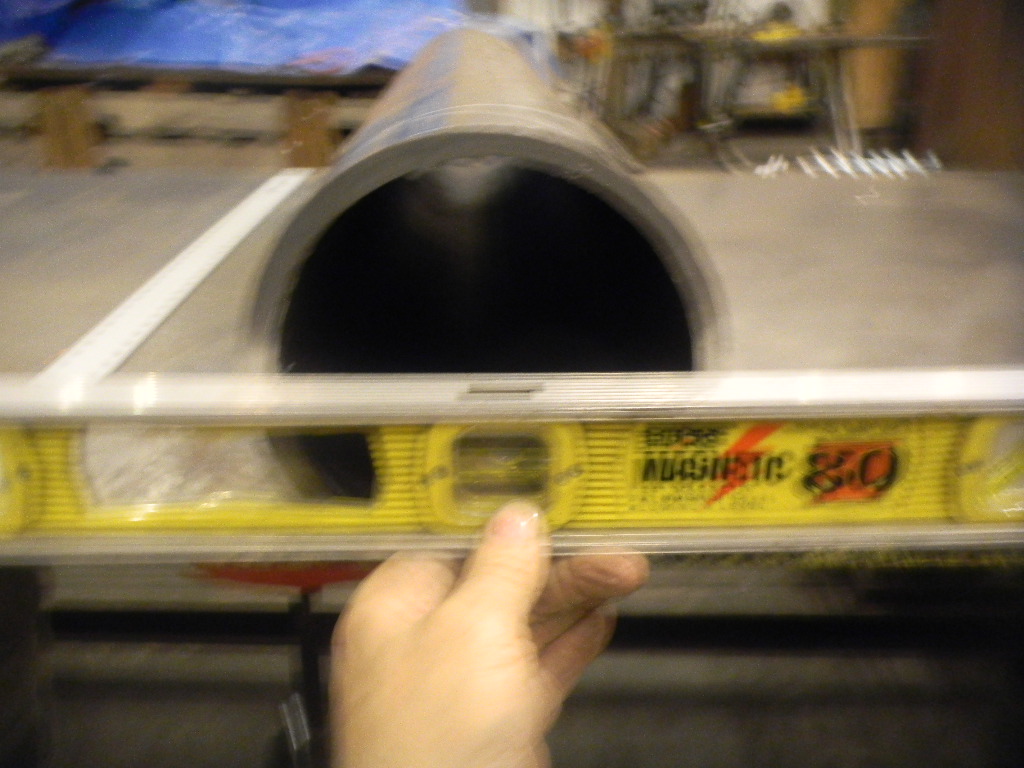

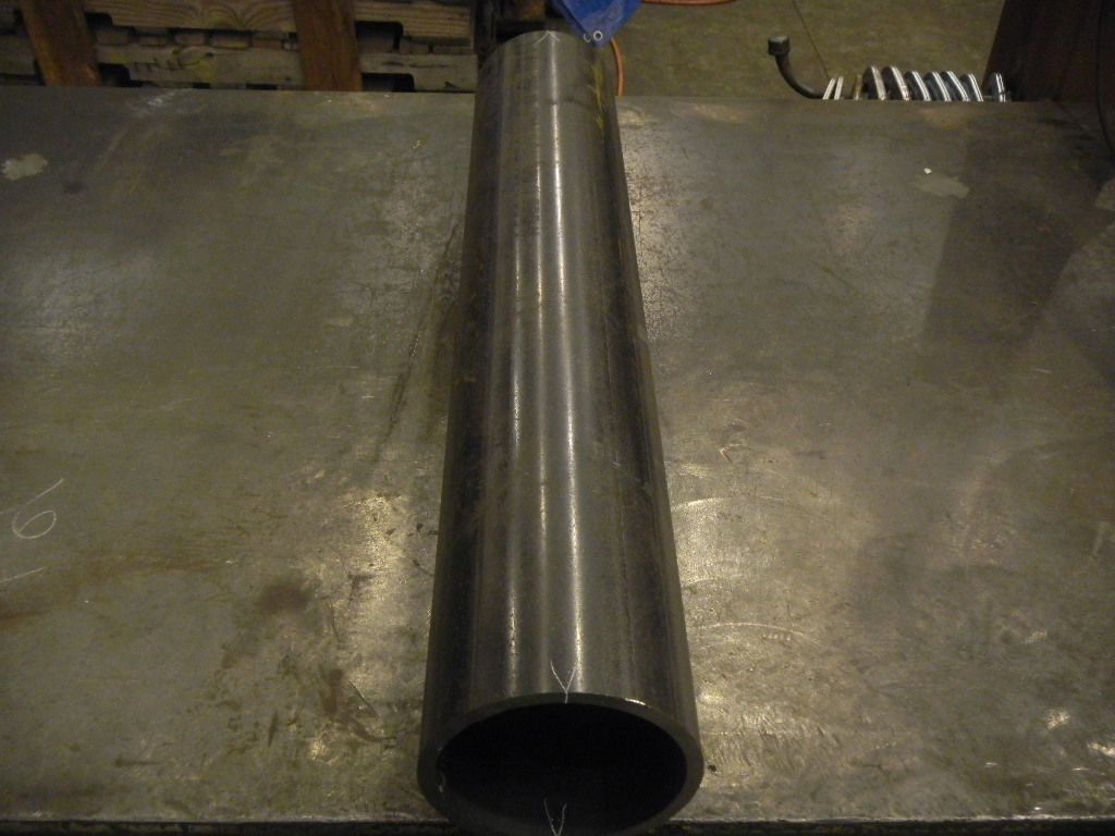

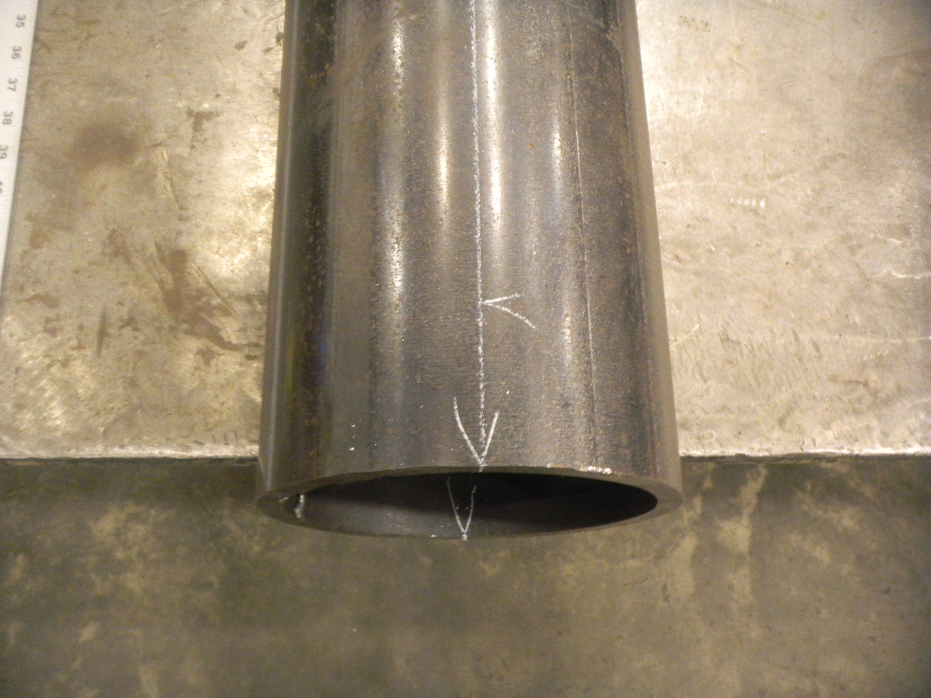

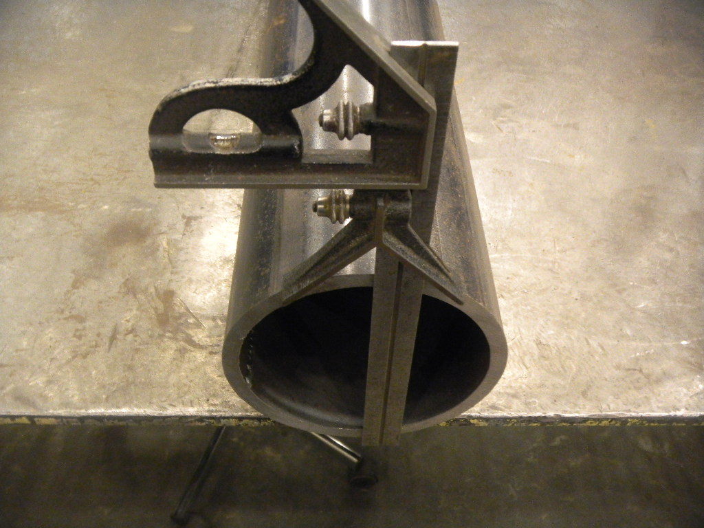

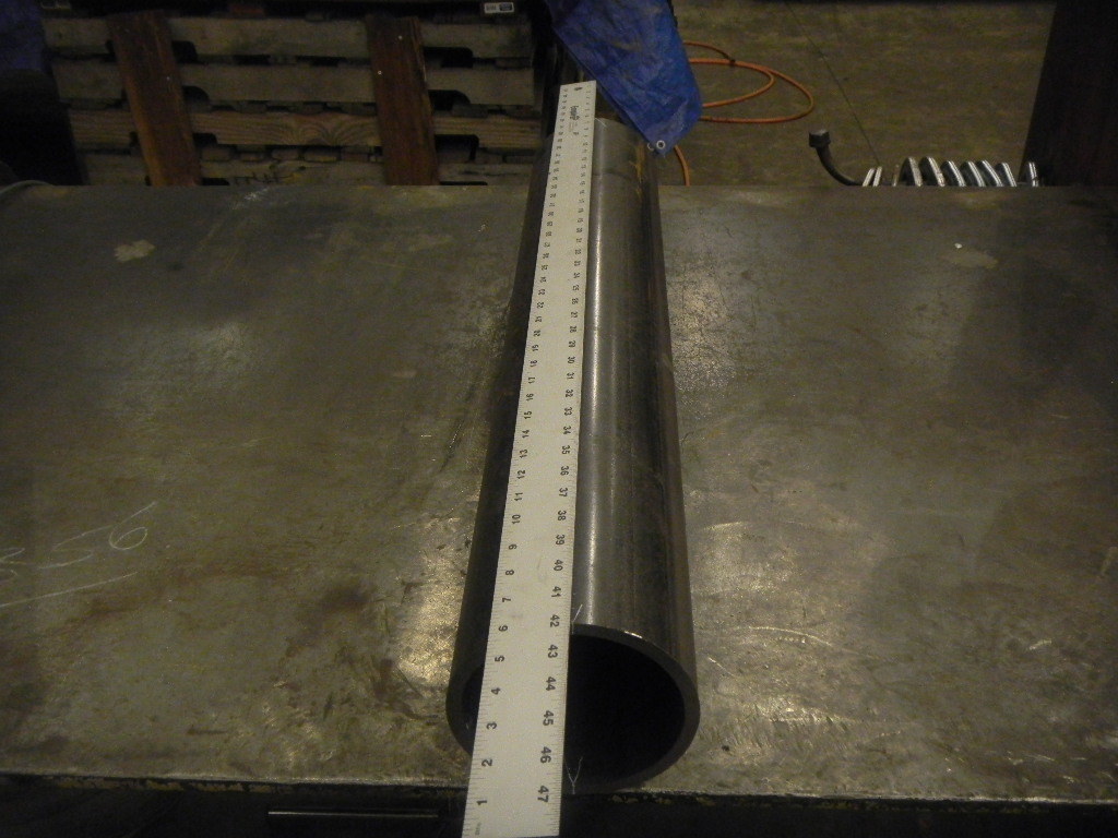

Here's how you do it when you don't have a big enough hole saw. ;)
