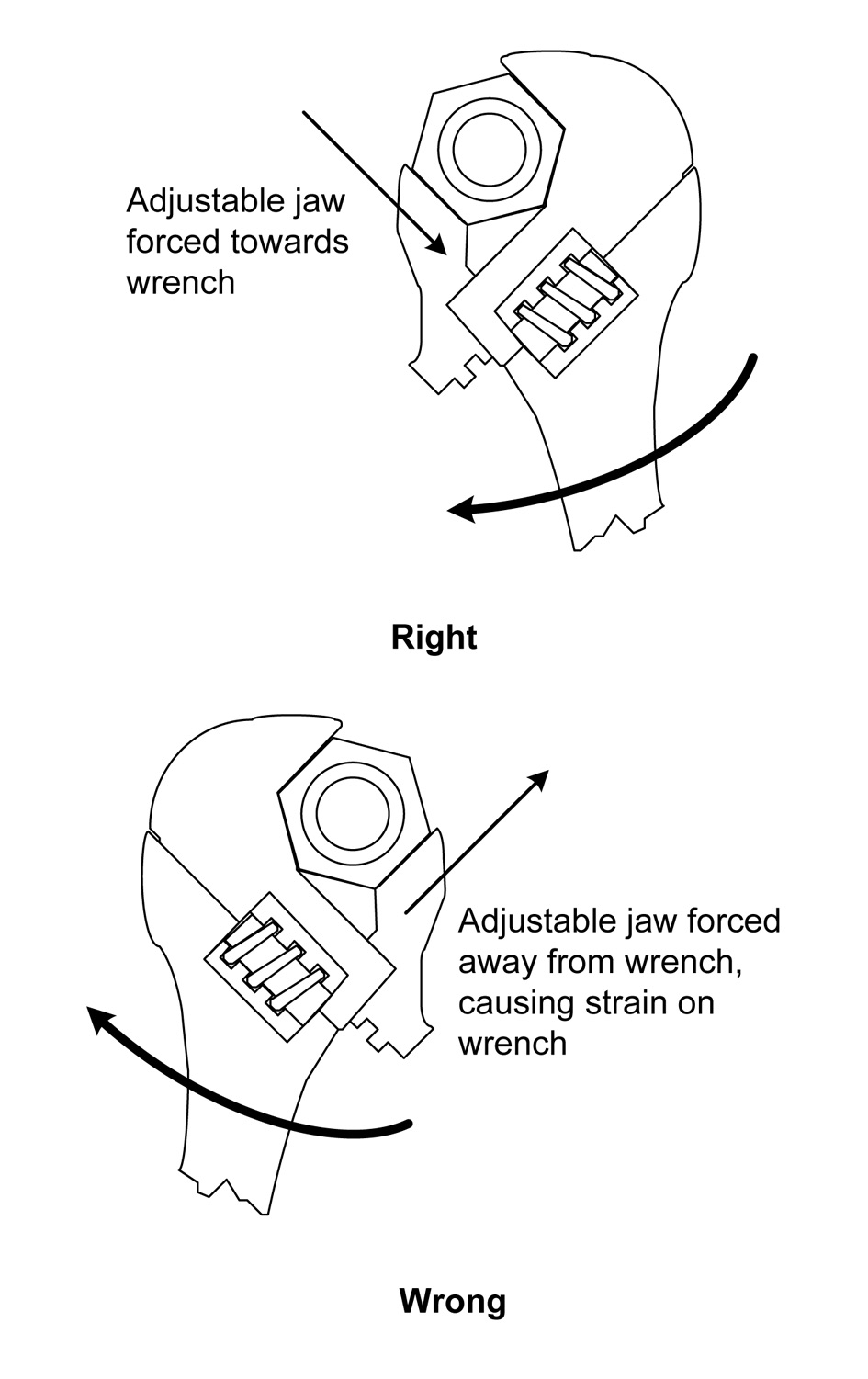

What I was told over 60 years ago in high school shop class, was with the pressure point farther up the moveable jaw, it is more likley to break the jaw:
That is also what I was taught.

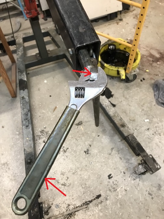

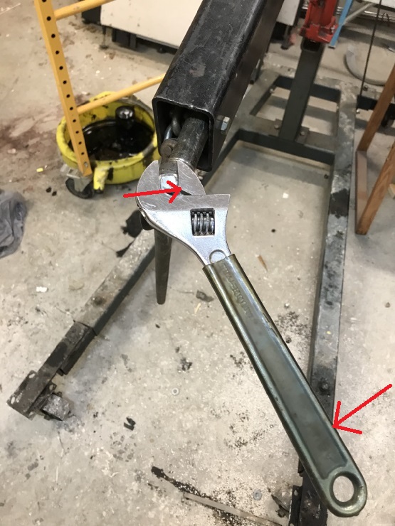

View attachment 582643 View attachment 582644
True. But pulling backward as in the 2nd pic tends to open the jaw slightly as the wrench flexes causing it to slip easier, rounding the head at a lower delivered torque.

Held like the first picture in your right hand it’s easily adjustable. Held like the second picture it’s kinda clunky. IMG_0876.JPGIMG_0877.JPG
