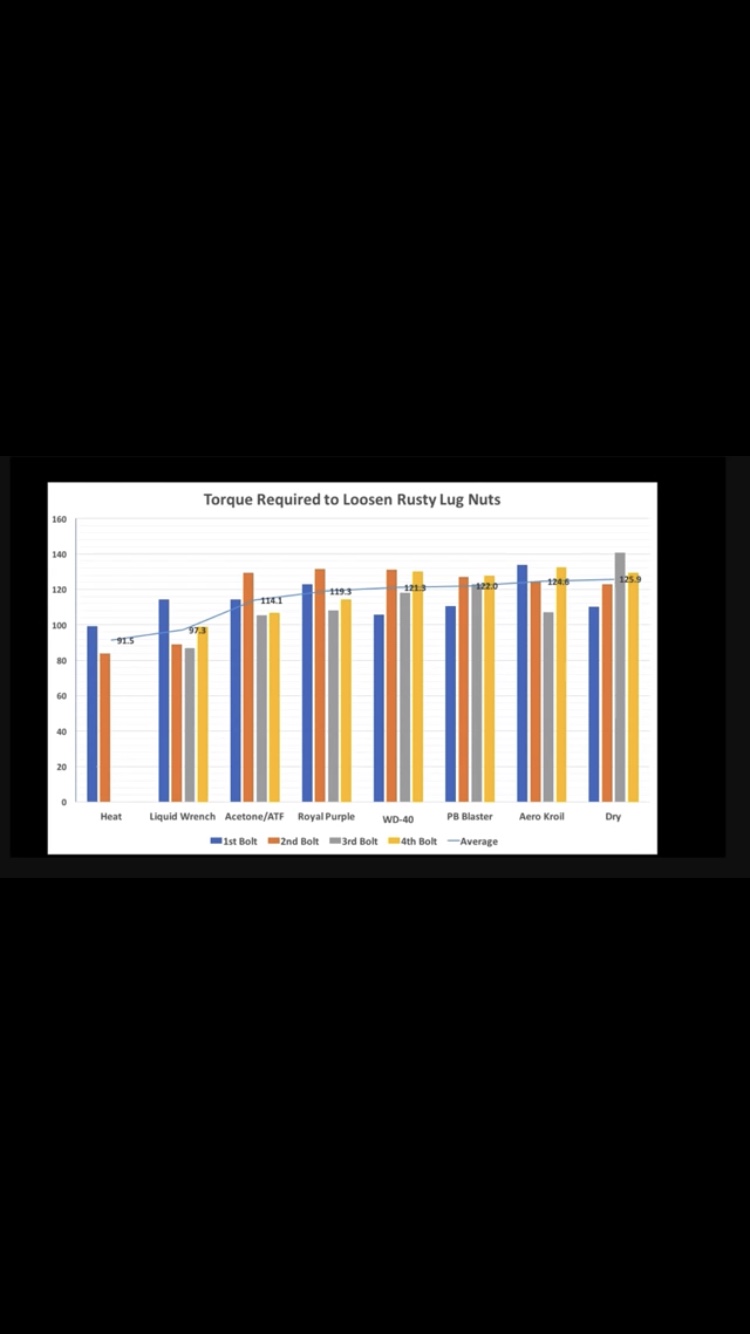

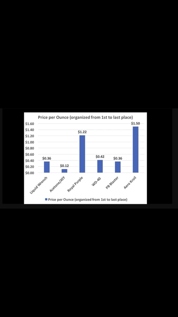

Liquid Wrench and WD40 are what I have always had around. I am not sure his method of rusting is real world enough, his results were not that different from turning the bolts off dry. Well done video, however. Just my $0.02
/ Rounded off drain plug #1,011
Here’s his test results. My experience is if you were to take those nuts off with a ratchet using any form of oil makes a BIG difference. I doubt there was much rust in the threads. It would have been interesting if he removed the nuts completely. IMG_0845.JPGIMG_0846.JPG

Here’s his test results. My experience is if you were to take those nuts off with a ratchet using any form of oil makes a BIG difference. I doubt there was much rust in the threads. It would have been interesting if he removed the nuts completely.View attachment 582363View attachment 582364
Any test that rates wd40 as better than kroil....I tend to not believe any of the other results either
/ Rounded off drain plug #1,019
I agree, LD1. KROIL is effective even on galled stainless steel...if it's not galled too bad. Best stuff I've used in my 28 years of fixing other peoples screw-ups.
