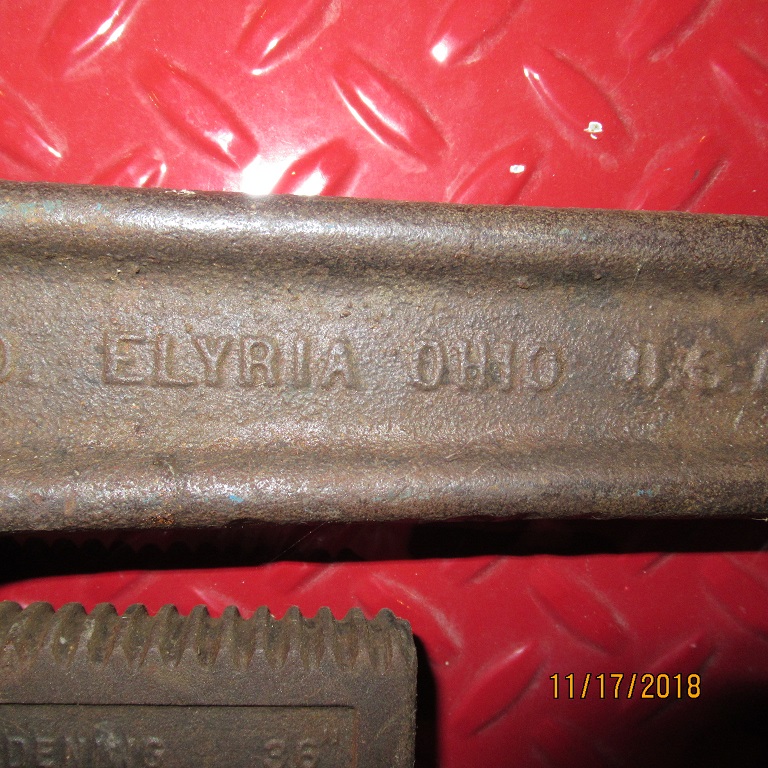

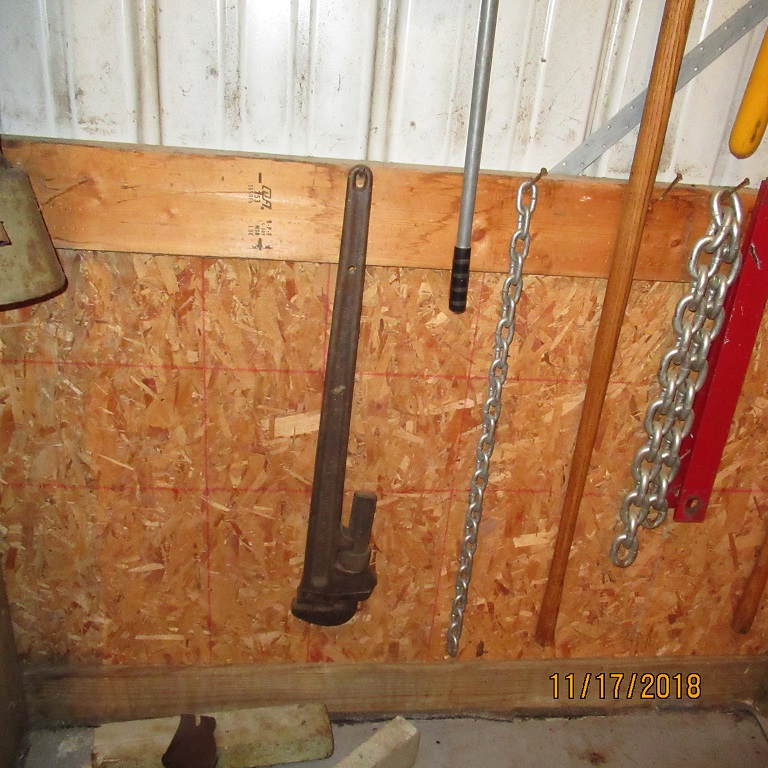

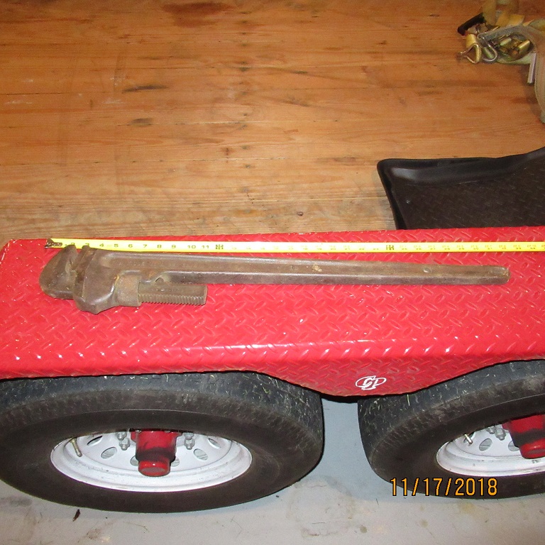

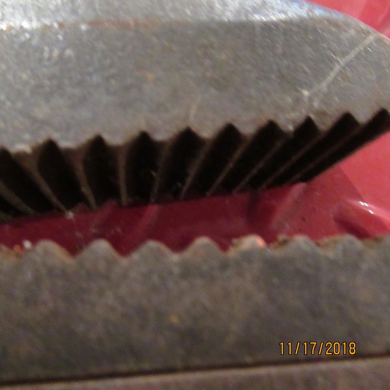

Except Kando(oo) has already tried that most ancient of tools (the pipe-wrench) and, not only did it not work, it was the main cause of the drain plug being rounded.
I’m pretty sure it was user error combined with a crappy pipe wrench. I’m also pretty certain a 12” pair of knipex would work. You could put my 10” knipex on it and put a cheater pipe on the handle and they would hold until they bent. They’re not really a tool designed for cheater pipe use.

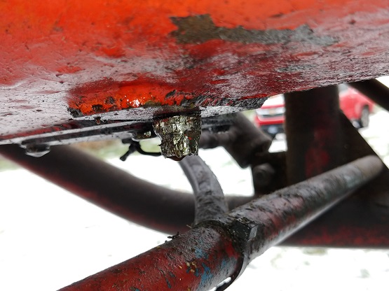

I had a transmission case that was busted around the plug. We drilled an taped the plug and JB welded around it in an attempt to stop the leak. Unfortunately that didn’t work so we ended up taking it apart and having it tig welded.
