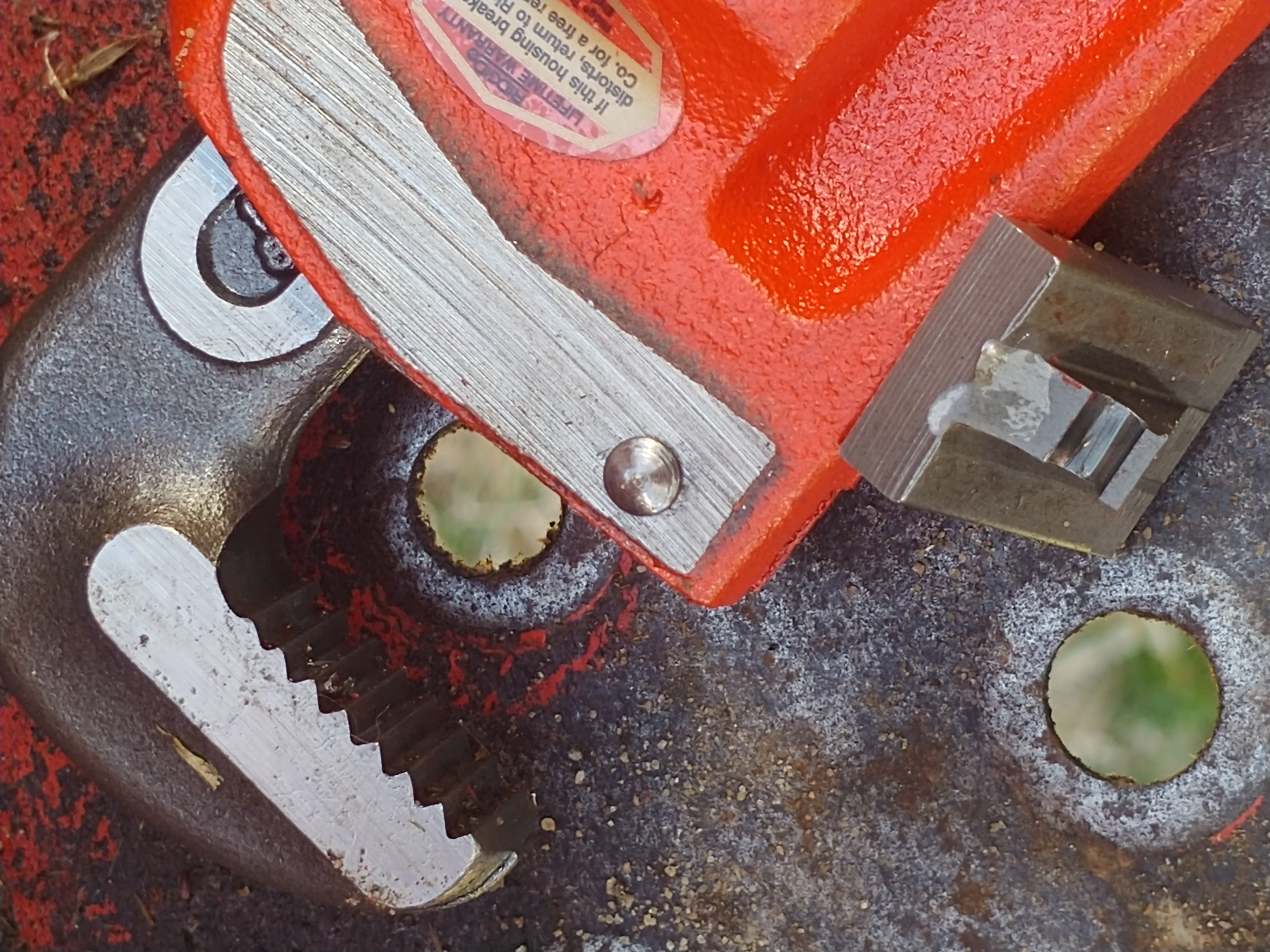

Got a buddy helping me out, going through our options.
Ground two flat sides on the plug to get a good bite surface.
Good bite, 8" wrench, need to go bigger. Couldn't find one of my bigger pipe wrenches at the time so trying again tomorrow.
Lower jaw was the weak link on the one and only ridgid pipewrench I broke as well. Played h3ll trying to get it warrantied.
/ Rounded off drain plug #1,368
Kando
If you want to remove the plug you need to turn pipe wrench over. Remember this old saying "righty tighty-lefty loosey"
I didnt take the picture as any indication of how it was being used. Rather just to illustrate he broke the lower jaw
/ Rounded off drain plug #1,369
The depth of the flats is bound to be short in relation to jaw width. There will be some tendency to distort the flats and cause the jaws to cam outward as high force is applied. For best possible results you should devise a hard/rigid restraint to force the jaws to be fully seated on the flats and to prevent the jaws from moving outward on the flats even the slightest amount as the serrations dig in. . . . As soon as the plug begins to turn outward you must relax the restraint a bit. And then within ~ a 1/4 turn it will become totally unneeded.​

Certain i'm turning in the right direction. Same direction as the other 3 loosen. Wrong direction wasn't what broke it.

That drain plug broke the pipe wrench! it is a bad muthu#$%
