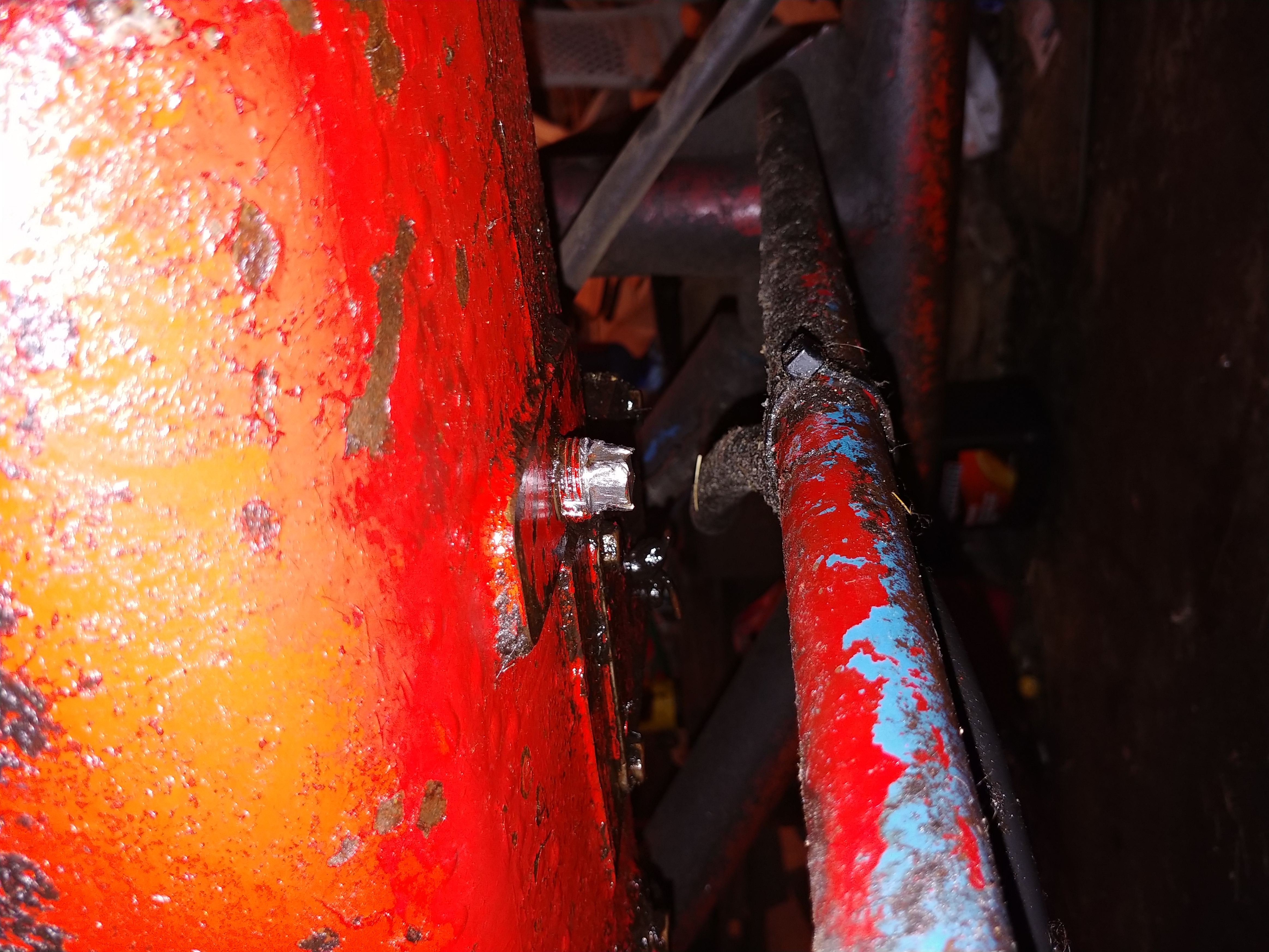

Yes, square head.
Here's the current state of the plug. That bar should be removable, bolt on each end. The loader mounts to the frame on the front under the engine and to axle on the rear, just a support bar I suppose. Johnkn, I've tried those extractors as well, although the one I tried was the one that fit in it's current state. Once I remove the bar I'll look into using the next size down, 1/2". Bolt head would normally be 9/16"
When I see in the photo with this referenced post, the amount of thread protrusion makes me think someone screwed the wrong plug in at one time.
Could you post a photo or two of the other drain plugs
A tapered thread plug into a straight thread hole will certainly tear things up and create liitle metal one way clutch dogs that prevent unscrewing.
Dave M7040
Dave M7040
The other plugs are the same way.

I looked at his pix and what I'd do is drill a 1/4" hole and insert a hardened rod to act like a lever.
That or since there were a decent amount of threads showing I'd clamp vice grips on the treaded portion and simply replace the damaged plug.

Or use a larger nut that fits over/around the plug completely and just weld the inside of the nut to the plug. Then it isn't hanging down any more than the plug is now, and will allow a larger wrench.
For that size plug, the nut that will fit over it is a 7/8. So he would need an 1 5/16 or 1 7/16 wrench to fit it. Just depends if he uses a heavy duty nut or the standard duty.
I've removed between 30 and 40 of those plugs in the past 5 years that way. You get some tater head being lazy and using an impact with 8 point socket to install them. Or the other popular method is an 18" adjustable wrench,Then procedes to hammer them in :mad: Then with the plugs being pop metal, they disintegrate when trying to use a pjpe wrench or similar method to remove the tripped out plug.
I raise he!! with a mechanic if I see them using one of those methods to install the plug. And have a hand tighten only policy in my shop.

Take a socket that is the next size down from the original plug head size, maybe 2 sizes if really rounded. Hammer the socket on until firm, it will go, as the metal used for these bolts is the consistency of cheese. If you can borrow an impact driver use that, otherwise an ordinary wrench.

Or use the correct tool for the job, a bolt extractor which covers the bolt head and bites in when turned counterclockwise. Get a set and have them. This will remove a bolt with a head that is completely rounded. Good luck...
Still think sucking it out with a mityvac if possible would solve the problem. Or drilling a new drain hole and fitting it with a plug.
