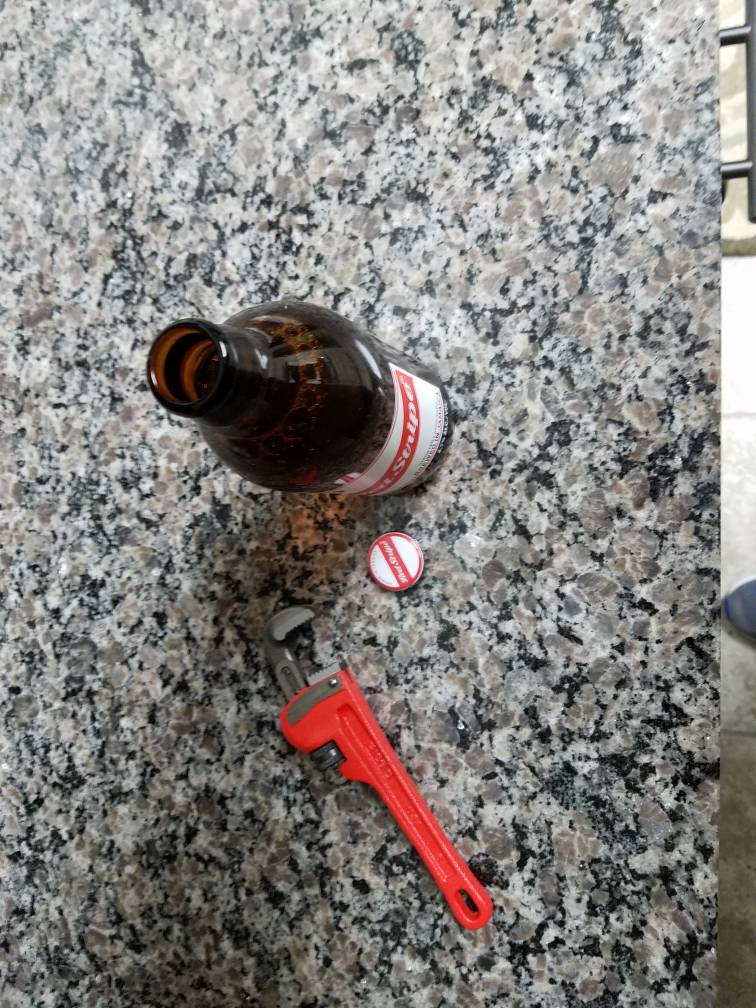

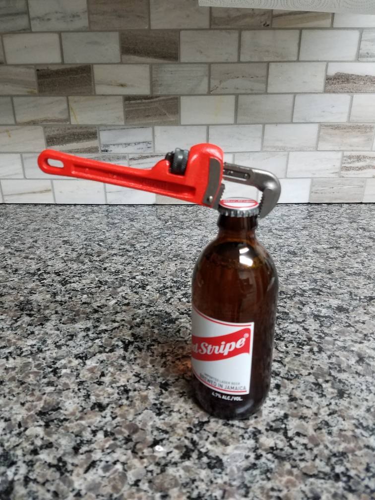

You could have ordered one of these from amazon for $15, removed the plug with it 1 time AND used it for its intended purpose (pictured) at least 6 times by now. 20181121_223535.jpeg20181121_223612.jpeg
/ Rounded off drain plug
#718
You could have ordered one of these from amazon for $15, removed the plug with it 1 time AND used it for its intended purpose (pictured) at least 6 times by now.View attachment 579936View attachment 579937
I actually found a 6" ridgid in my toolbox that I don't remember buying. Ordered an 8" one that was delivered today. With time off work for the holiday I'll work on getting a flat spot on each side of the plug to stick the pipe wrench on.
