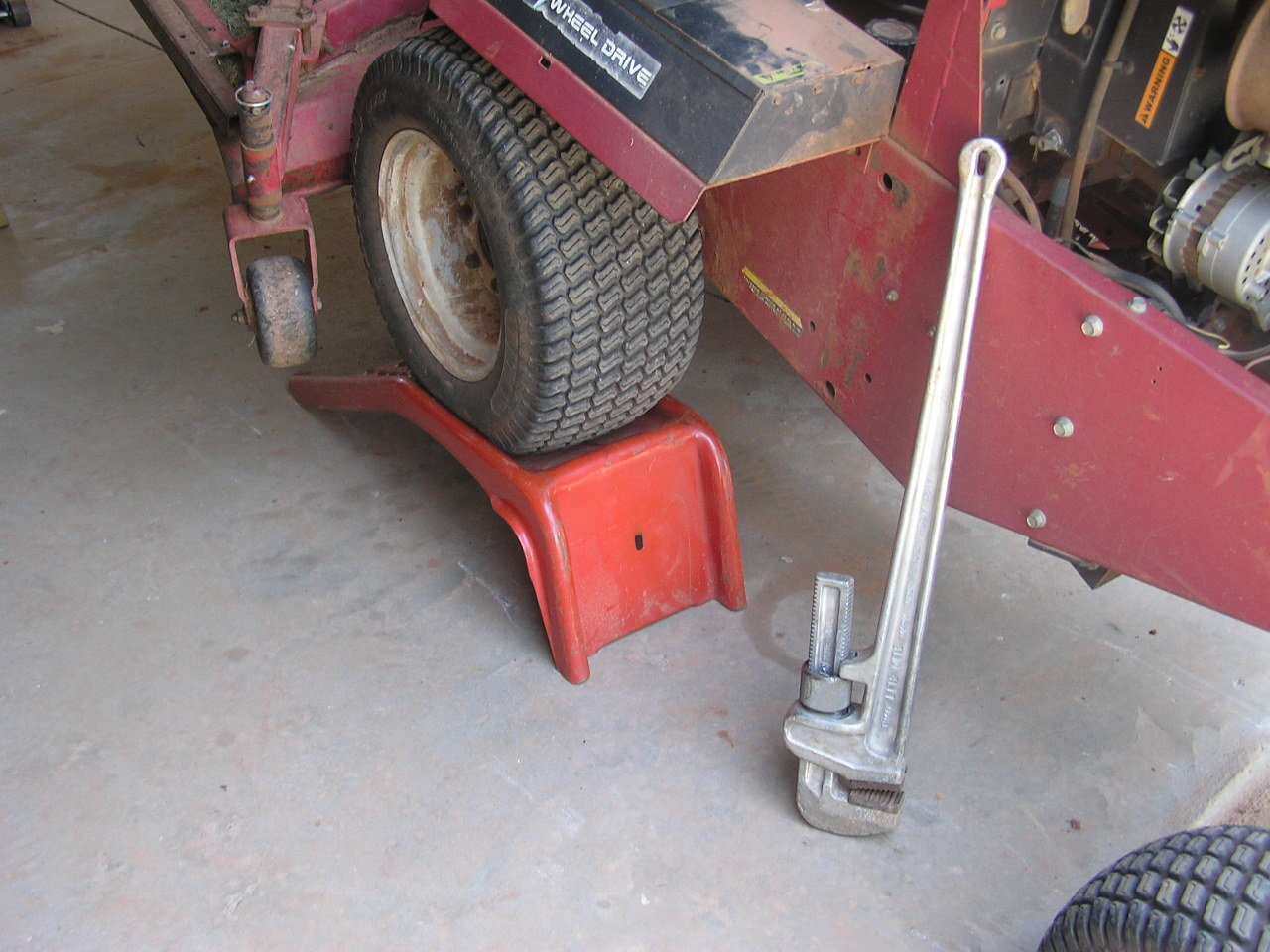

I wonder if Kando was able to remove the round bar that was hindering access to the plug? He posted a pic early on and said he thought it could be removed. If not, it looks and any drilling or tapping into the hole would be difficult at best.
/ Rounded off drain plug #1,624
Welding; cut the bar out and then weld it back, easy stuff.
Ron
/ Rounded off drain plug #1,625
Ron
Would not be easy for me laying on my back, trying to weld it :eek:.
/ Rounded off drain plug #1,626
Thanks for reposting that pic Xfaxman.
Looks like a cast pan with reinforced boss for the female thread.
I’ll stand by my original suggestion of HEAT the PLUG quickly and twist off with pipe wrench or almost any of the other gripping tools suggested multiple times.

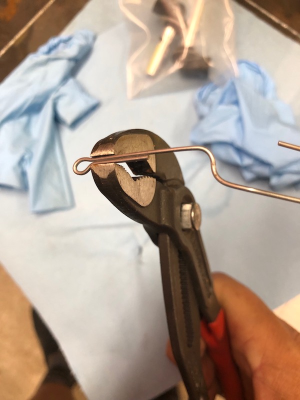

Once again, I've been introduced to a new tool on this thread.
Now I'm not going to rush out and purchase one for myself (like I did for my Knipex), but I have the knowledge that it exists. :thumbsup:
Yes but you have to admit the one I posted would be more FUN.
Especially on those occasions when your BIL asks “ Got a light?”
