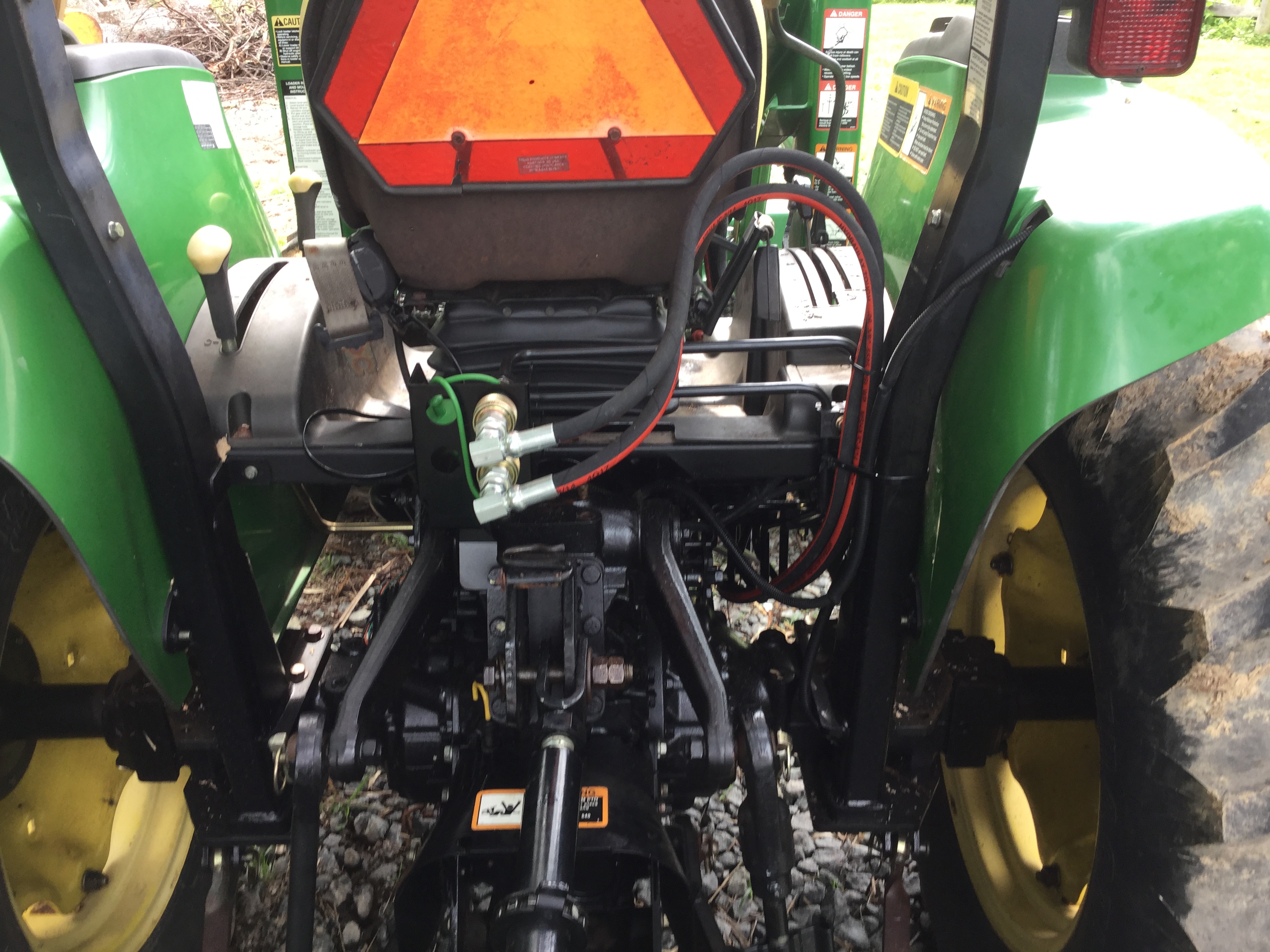

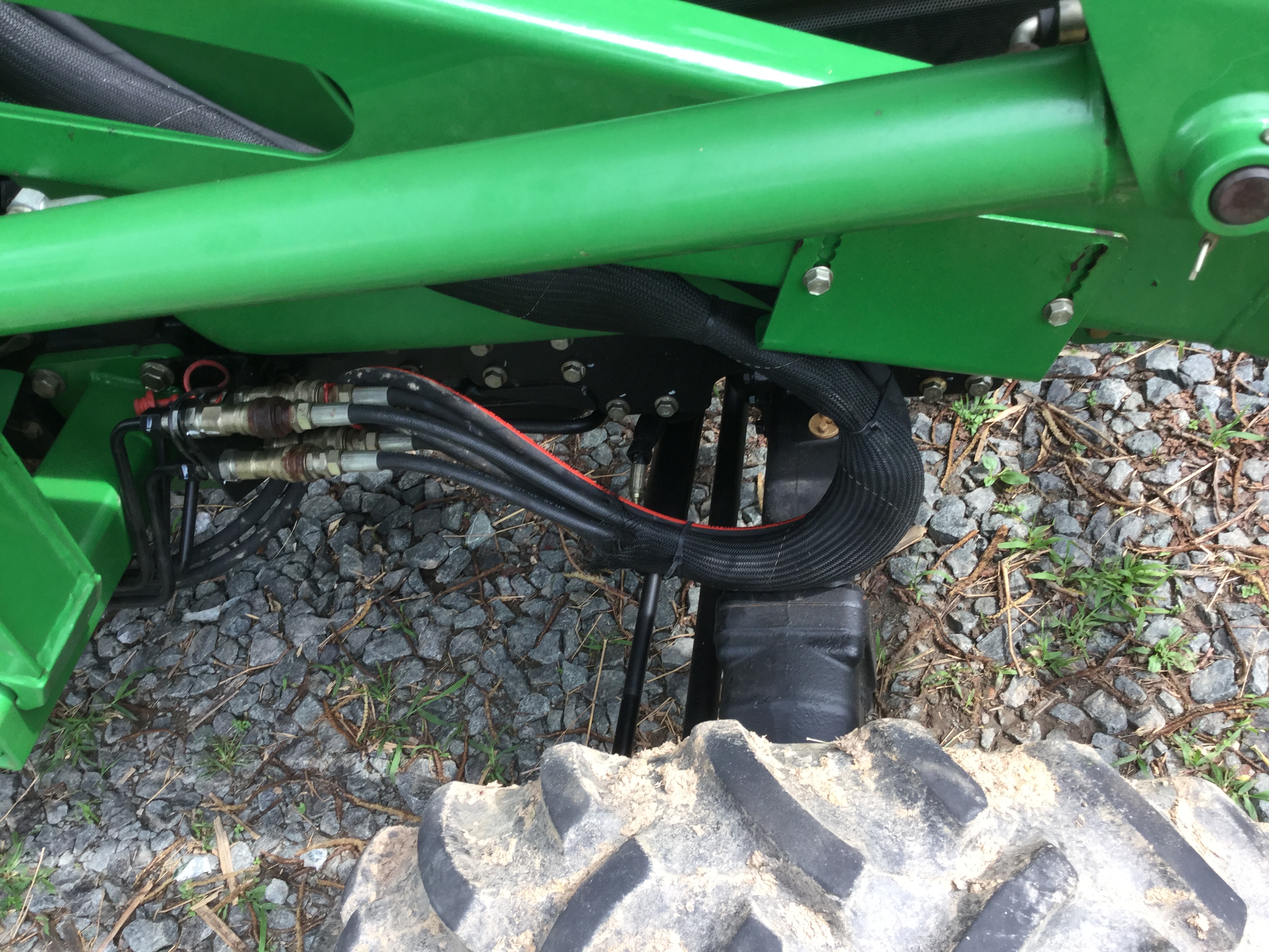

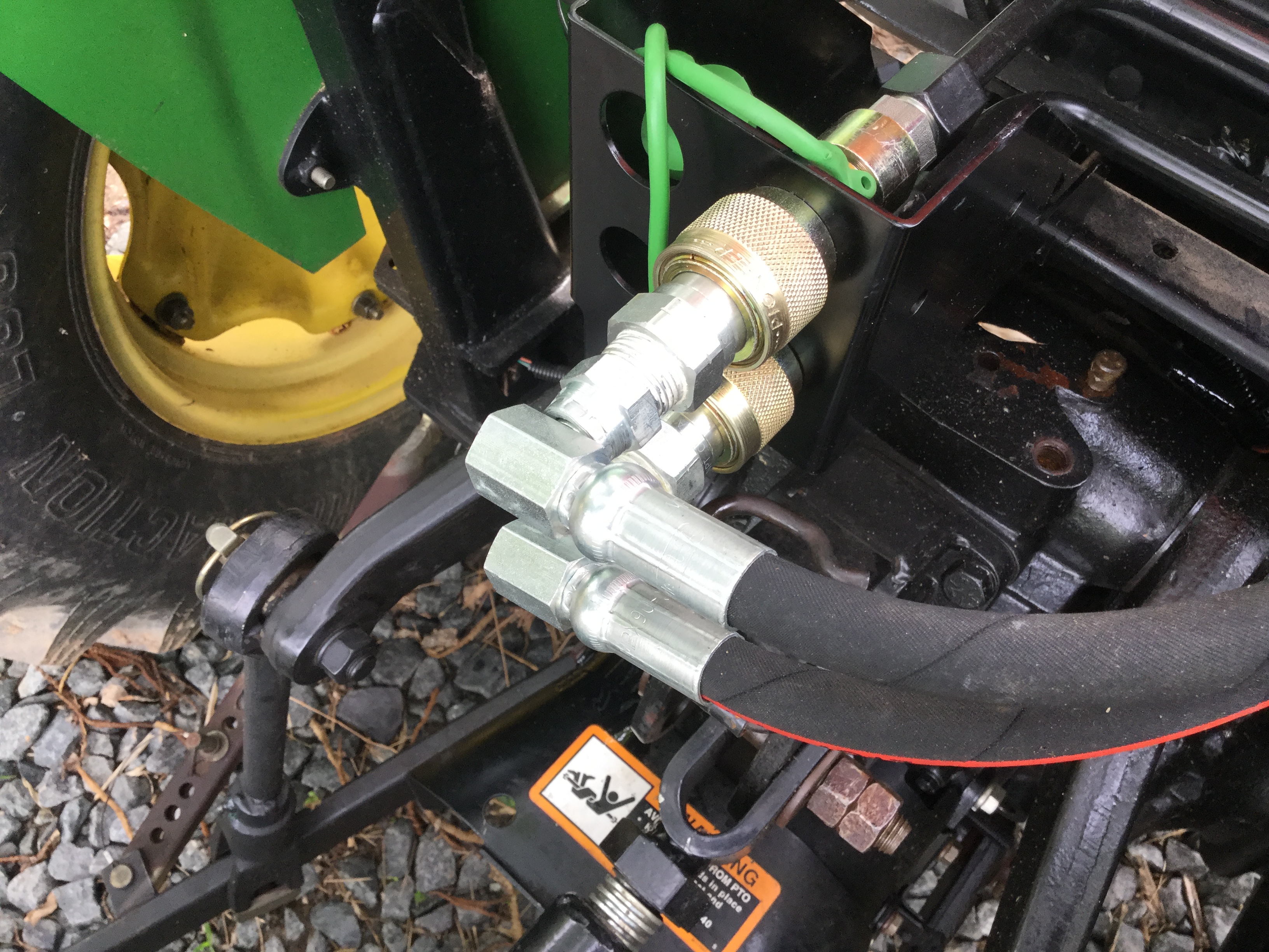

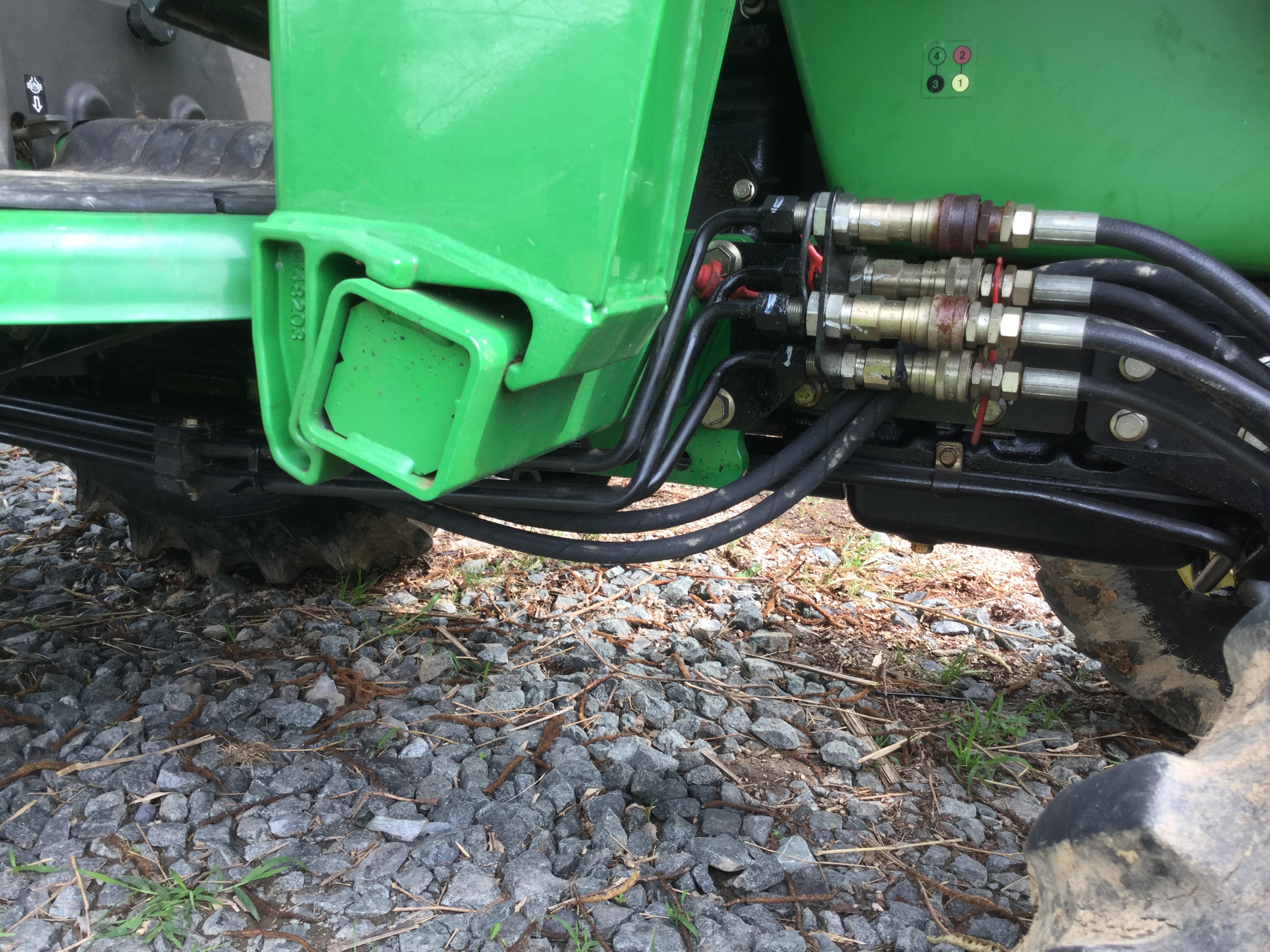

So I got time to run the lines. I am a bit OCD and I have a bunch of nylon cable ties so I am sure I will adjust things as I use them and see how it works. Right now I have a long while before my grapple gets here so I have got time.
D425C2E1-AB1C-4DCE-959E-0EB7CA670DC9.jpeg029373D6-9484-4045-B323-D50FB2FCC649.jpeg5AFB4AB2-F104-4FF7-9762-1F5FC49CA60D.jpeg5159F380-74B0-472F-80C6-3EF7E1AEB7A3.jpeg7F0528B0-AAE9-4A1B-A2DB-4C4B9A7C7B2A.jpeg784CB88E-79D1-48DD-B328-A7CDCA28BF86.jpegC876D40F-5805-4B2B-9F2F-34D038F614C3.jpeg
I went with a bit longer line and it worked out, I have them run in a pretty good sized upward turn at the rear and this keeps them clear of my 3 point. In the one spot down low I am going to raise them up even with the hard lines. Besides a few small tweaks everything is getting there.
Now I am considering a manual diverter valve/block. I think I can fit it back where the rear quick connect is and run a hydraulic top link and the grapple with the flip of a switch.
I have no desire for an electronic diverter, I just spent a good while diagnosing an issue on my TLB110 and the front diverter. I am not a fan of electronics if I can avoid them.

Excellent pics and clean looking job. Thank you. Can't wait till the grapple gets in.

Thinking about doing soething very similar. Are those 90 degree swivel fittings on the back? I would think a swept90 hose fitting going to the QD would be a better option.
Have you thought about tying into the valve that sends fluid to the rear directly?
   / Routing John Deere SCV from rear to grapple
#30
They are swivel 90’s, it’s not a lot of flow on my little tractor so I’m not concerned.
Not sure on the second question. I wanted rear remotes for future possibilities, I only need the set to the front for a grapple so a manual diverter will handle both and is relatively inexpensive
