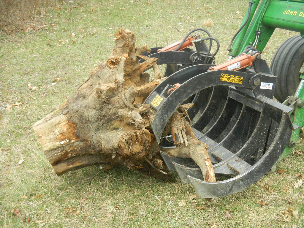

The Kubota version looks great but don't I don't care for the Kubota price. That's where I am so far. I would just pick up brush piles and a few rocks with mine.
   / Routing John Deere SCV from rear to grapple #37
Just buy it! You will quickly forget the price.

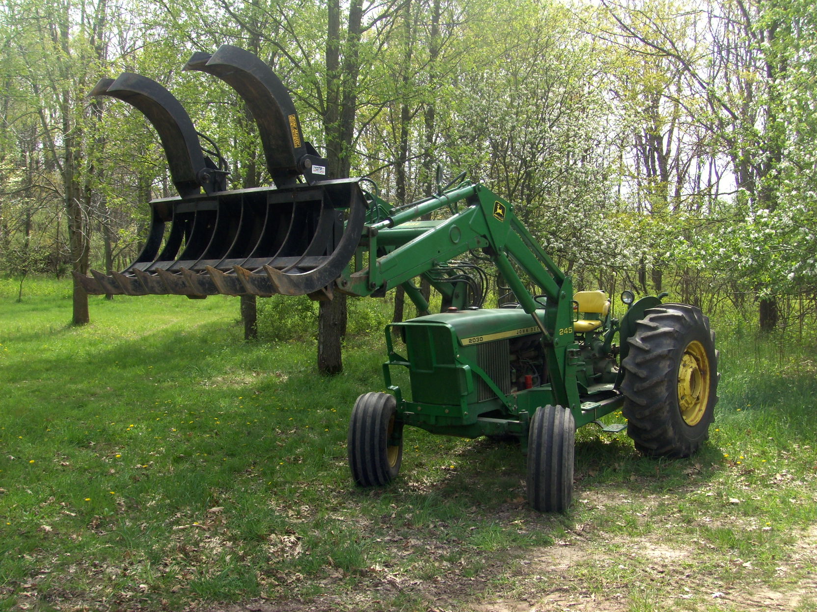

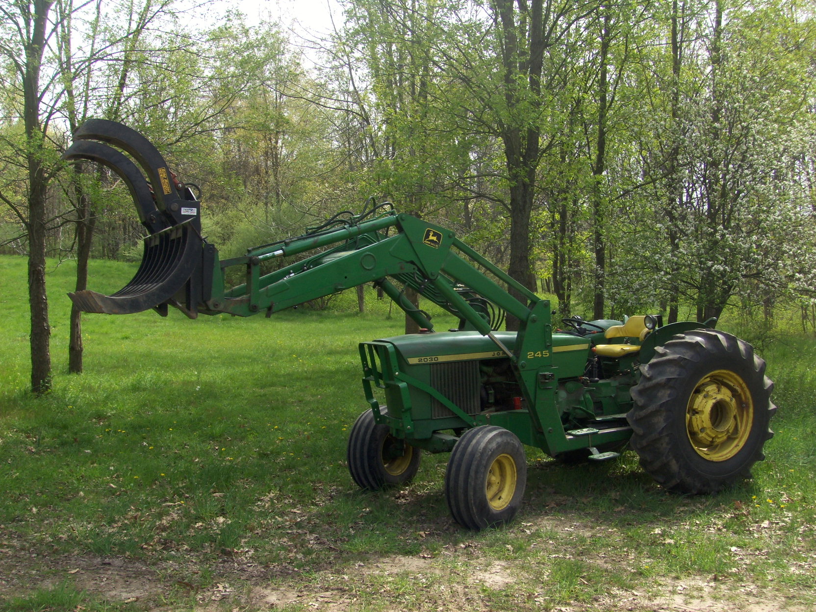

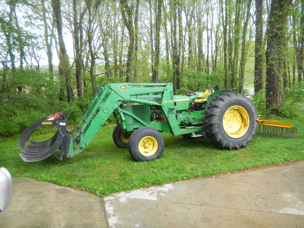

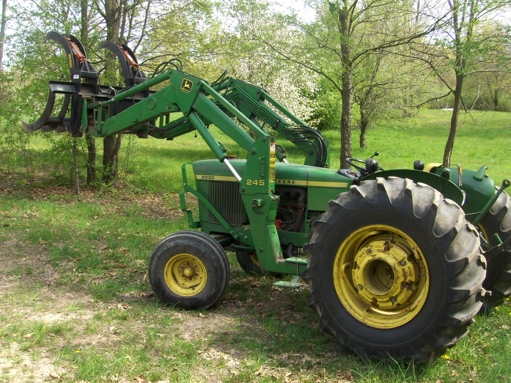

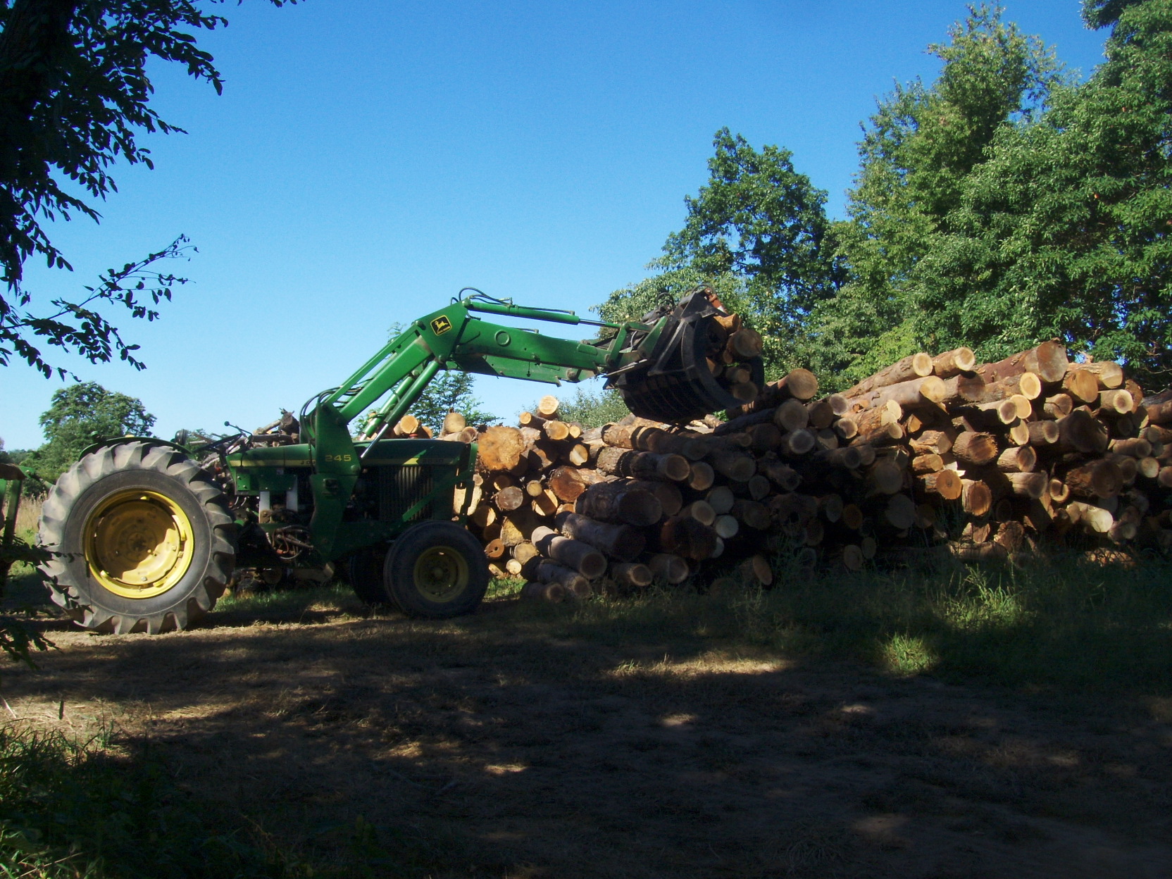

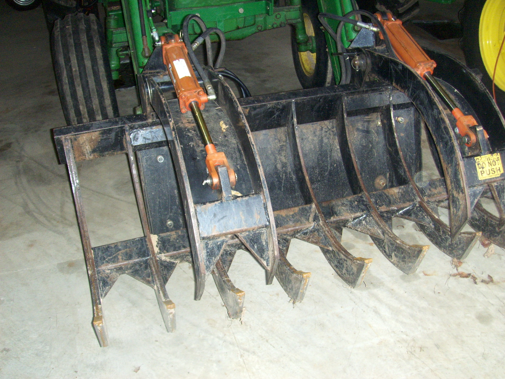

Zebrafive--Good looking grapple. How did we ever get by without these?
   / Routing John Deere SCV from rear to grapple #39
About the only time I take it off is when the loader is removed to brush hog.
   / Routing John Deere SCV from rear to grapple #40
I only take the grapple off when I need to put the bucket on for a specific task. The grapple is so useful.
I used JIC fittings for the lines I ran from my rear SCV. NPT only where I had to for the QC fittings, then to a JIC adaptor. NPT has to be tightened really hard, requires sealing goop and even then often leaks. JIC just works. On the loader end I made a bracket to bolt on to existing threaded holes for a cover that holds and protects the hard lines where they run across the torque tube, and used JIC bulkhead fittings there to hold the QCs. I did not understand how much slack the grapple hoses would need. The hoses that came with the grapple were too short for any reasonable mounting position so I had to get longer ones. Eventually I'll build a 3rd function system but I'll reuse the bracket and fittings.
