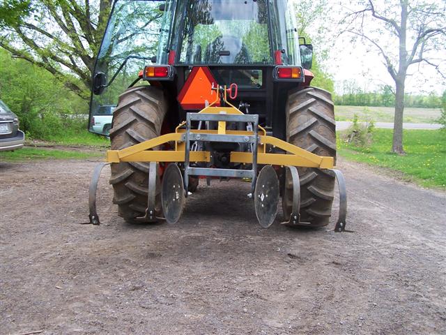

I've been making and sell this Disc Hiller locally. It takes the work out of gardening.
I posted the wrong pic of the beds but can't figure out how to remove it. It does a similar job of making beds.

If you check with some of the big farms in your area you can locate some old 4 row equipment real cheap. I got an old john deere 4 row cultivator with the guage wheel and cut the tool bar in half and moved each gang of harrows down to make it a two row to go behind a 75 horse tractor. With that size tractor you would lose alot of garden space with a one row. I use small sweeps on the back harrow to make my rows, then when I cultivate or lay my corn by I just put the big sweeps on the back and it makes the rows bigger. I have mine set at 32" centers. If you want some pic let me know. Most of the 4 row equipment can be had a local equipment auctions for less than $200.
