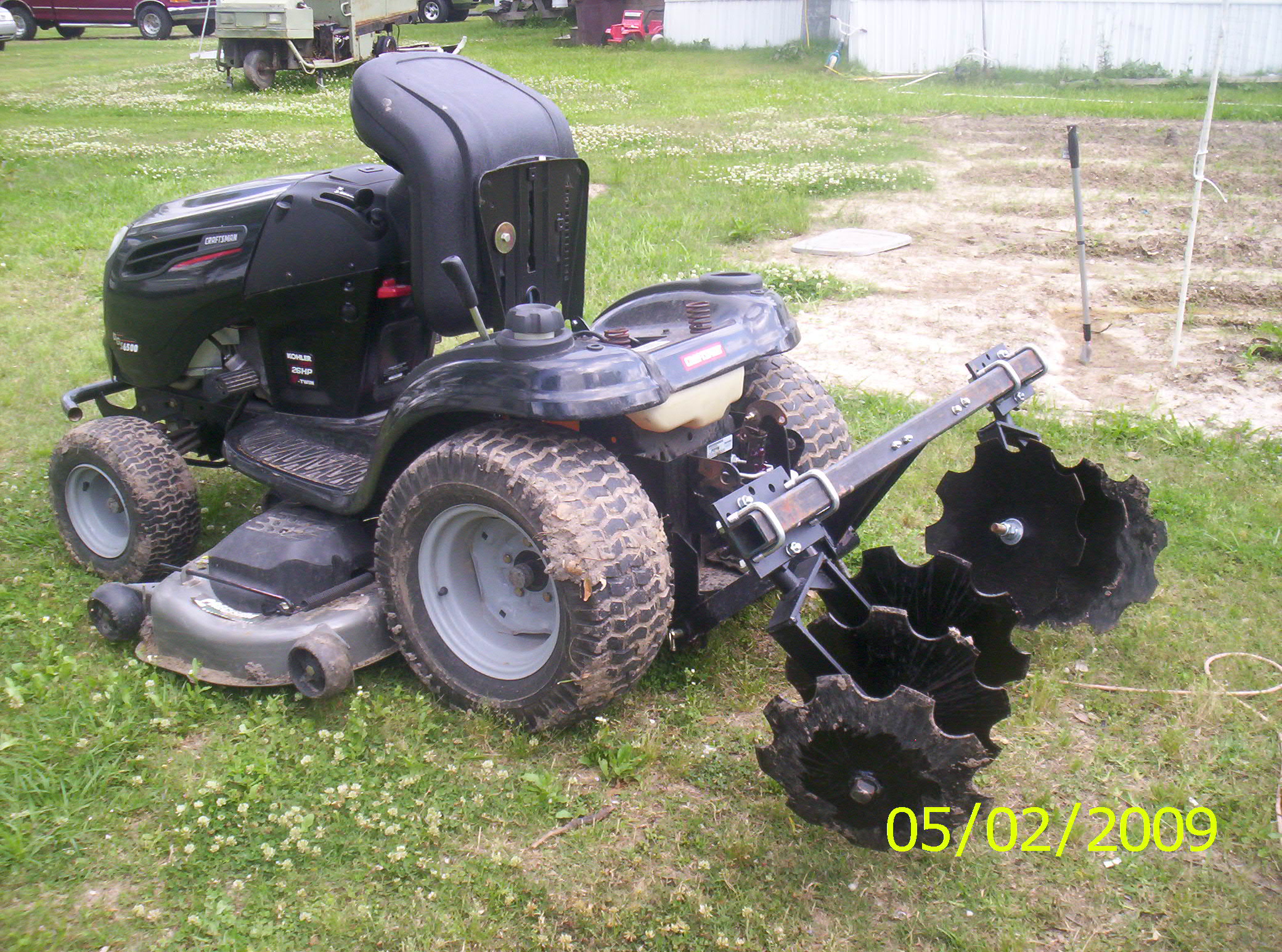

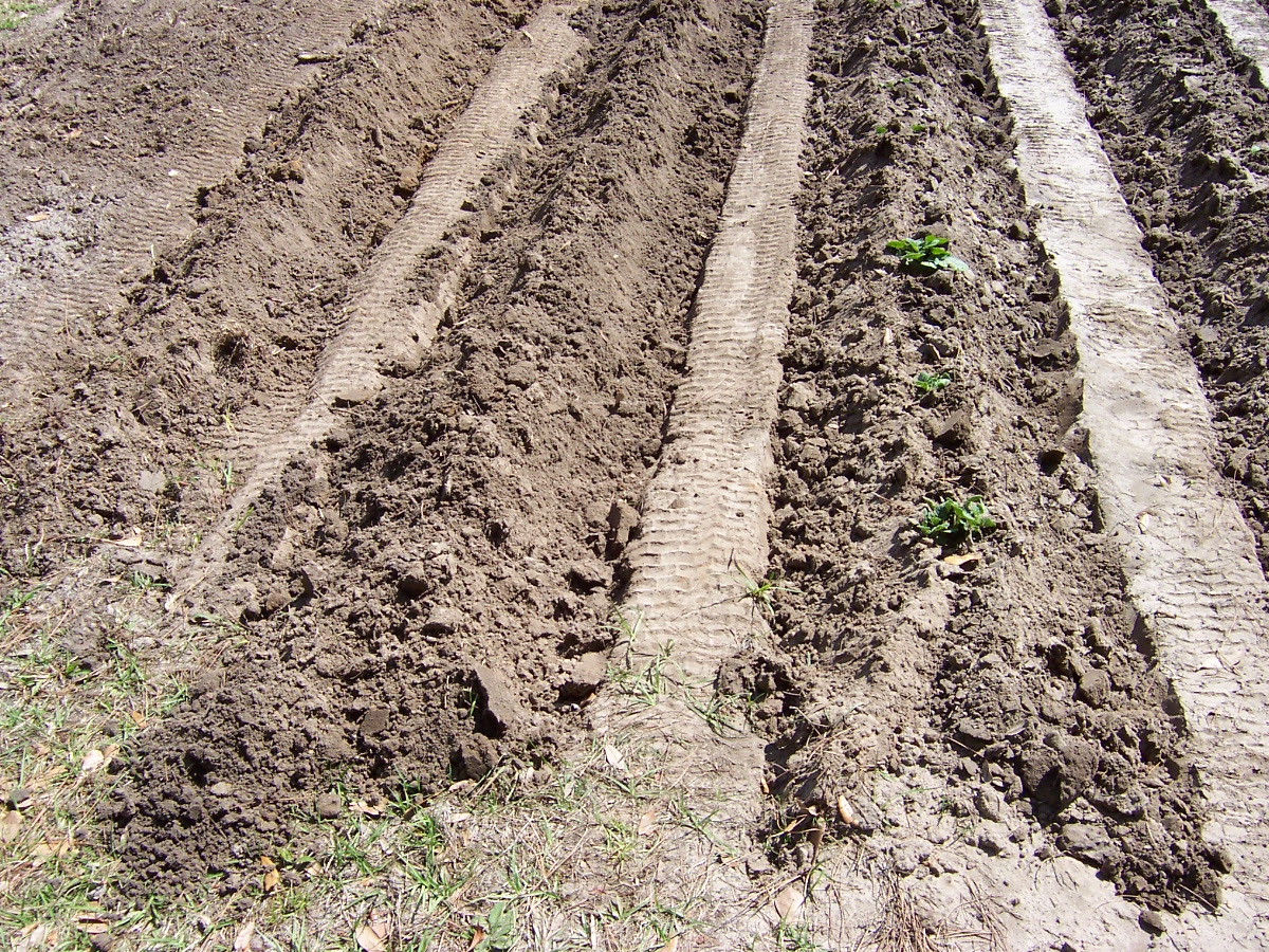

   / Row hipper/builder manufacturers #12
Dang it!!!!!!!!!! Your right............I guess I 'll have to fix that,but it does work ok.:eek:

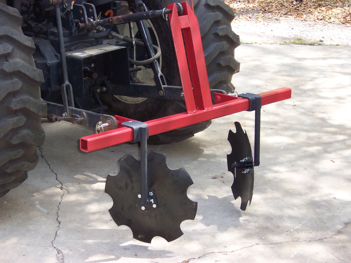

   / Row hipper/builder manufacturers #13
This is what mine looks like, pulls very easy with my Craftsman. If you turn them out you can tear down rows. I was using a screw jack with a power window motor to lift it at that time. I have now replaced it with a $49.95 winch from Harbor Freight. Works Great!
Mike

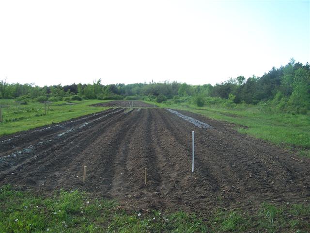

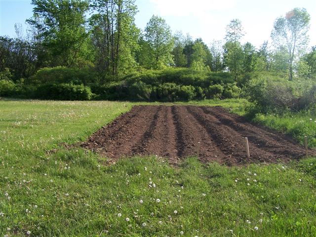

   / Row hipper/builder manufacturers #16
I've been making and sell this Disc Hiller locally. It takes the work out of gardening.
I posted the wrong pic of the beds but can't figure out how to remove it. It does a similar job of making beds.
