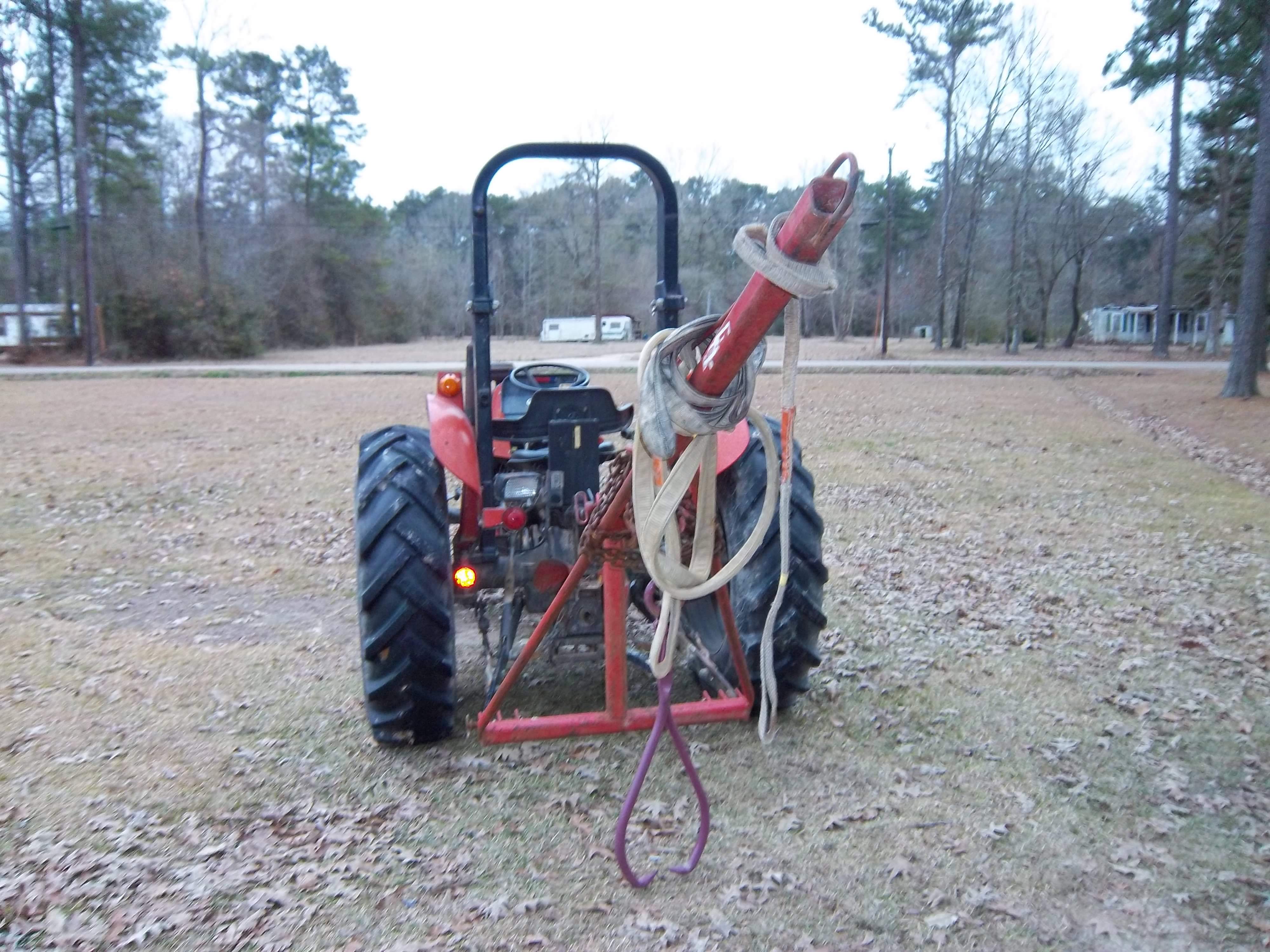

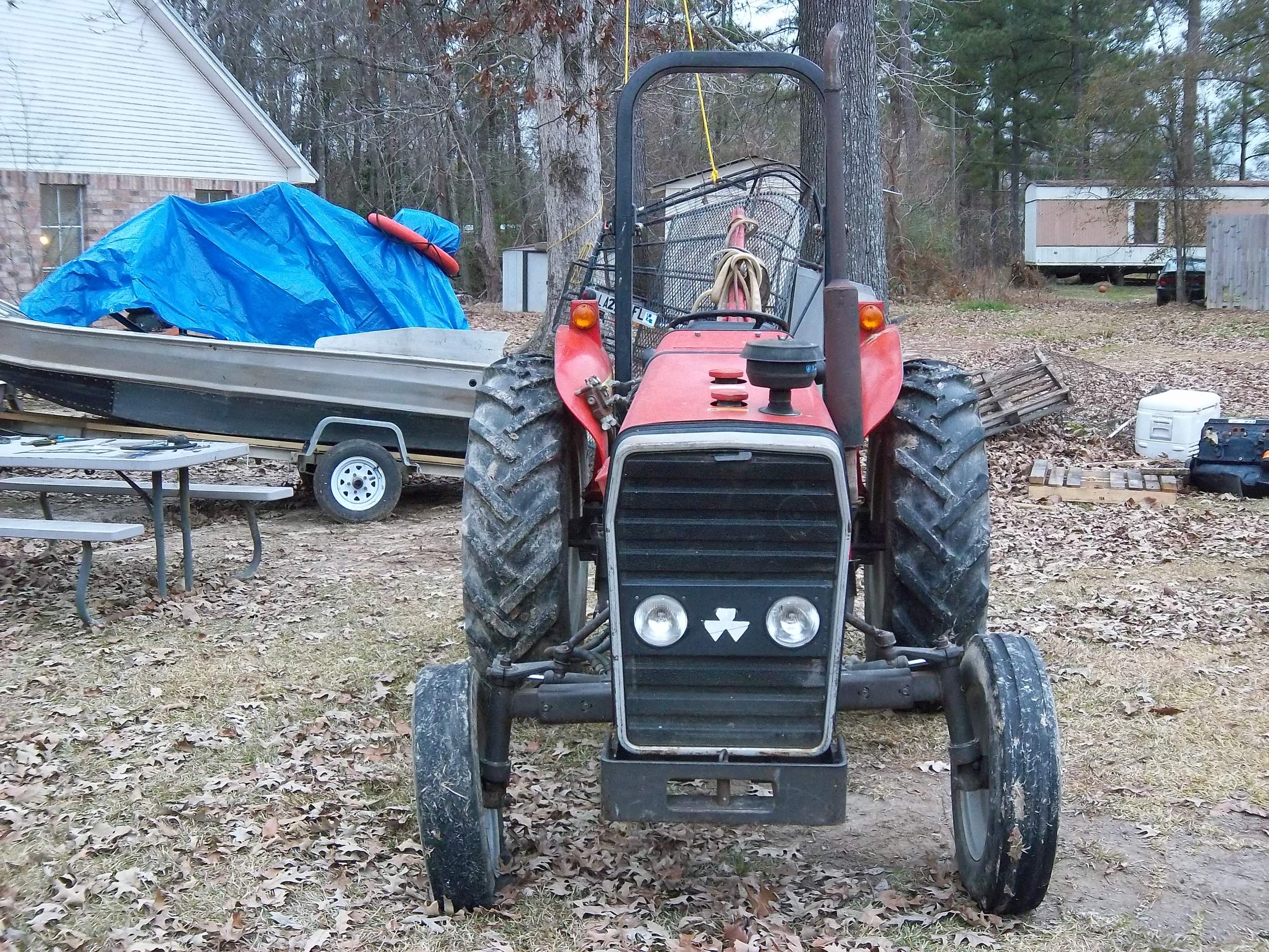

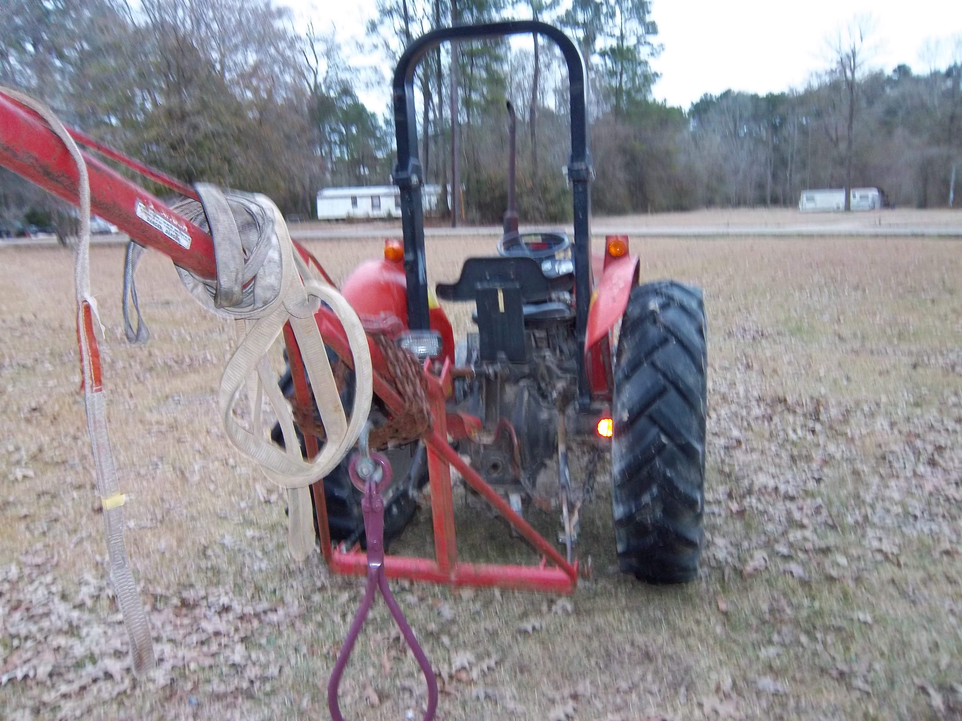

   / Row Hippers and Cultivator
#35
Here are a few pics of the tractor all the way around...
(I know it has a flat)
   / Row Hippers and Cultivator #36
Can't get a feel for the inside width of the tires, that will determine your row spacing. On a wide wheelbase tractor, you can get 2 rows between the wheels, but most smaller tractors you can only get one row.
Take bp fick's tractor for example, it has a higher horsepower, but is a narrow wheelbase tractor, and has narrow tires. Great tractor for tighter rows for gardening.
Your tractor also has narrow tires, but the inside tire spacing will determine your rows.(can't plant in the tire tracks).
