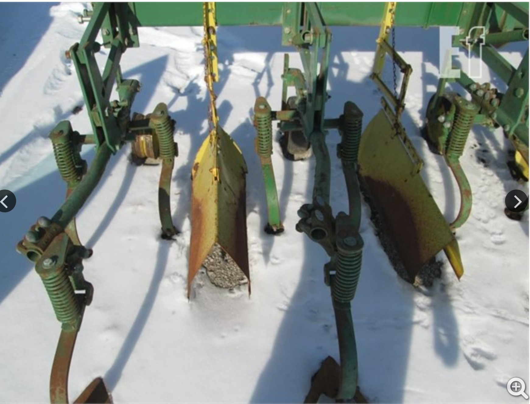

Trying to understand. You already have a planter so you can measure the row spacing. Row crop cultivators typically have shielding to prevent dirt from being thrown onto the plants although there are many variations. But its tough. That's why farmers today use chemicals - cultivating can do a lot of damage to the crops. Here is a picture of an old John Deere row crop cultivator. Shields protect the plant from the cultivator teeth nearest the row. The third cultivator tooth gets the middle of the row. Pretty much a fixed spacing. This one is the very standard 30" row spacing. If you are building your own to match your planter spacing, this gives you an idea. These cultivators are currently found in many salvage yards so a person could buy their own cultivator and shield units and build your own to match your planter.
