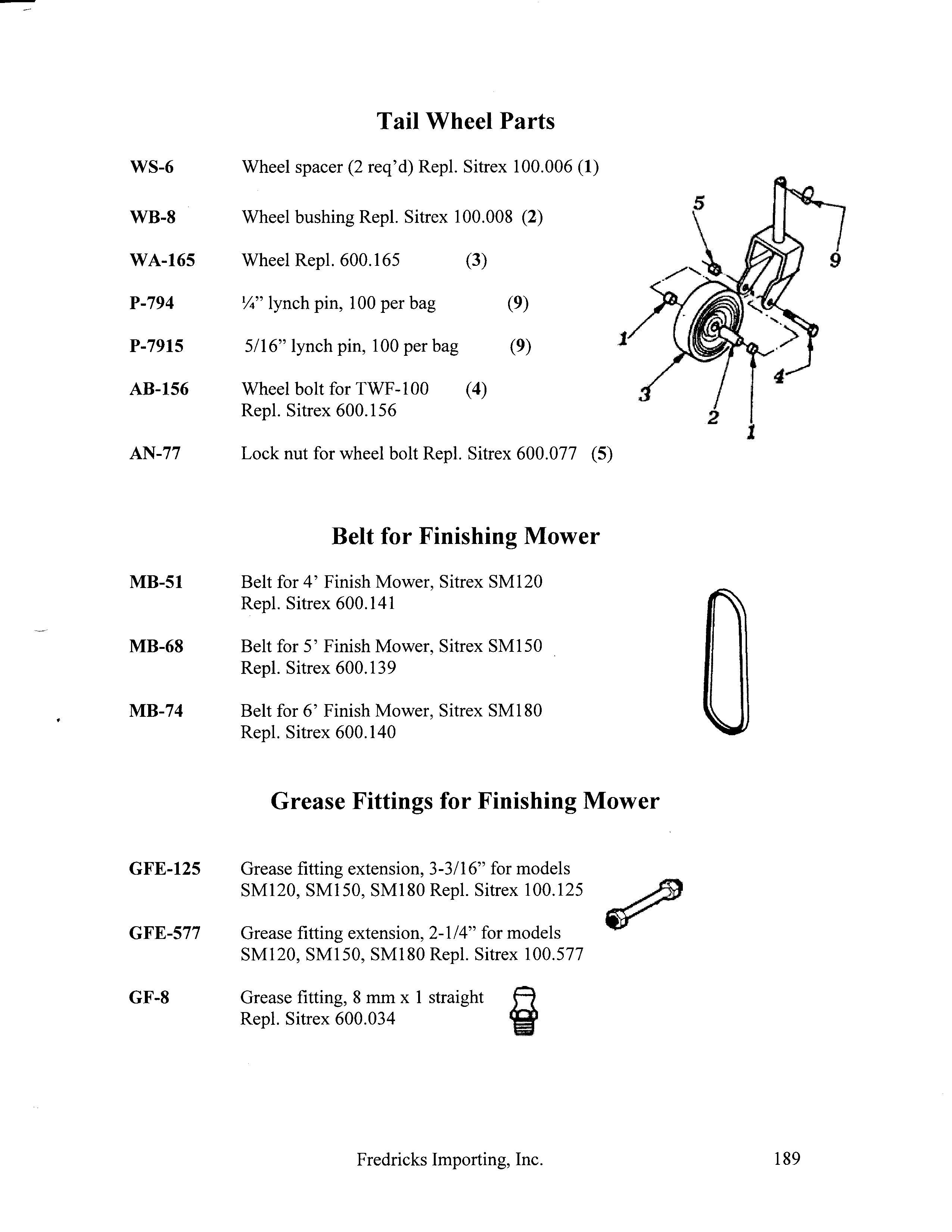

Fredricks RS1400 Tail wheel parts.

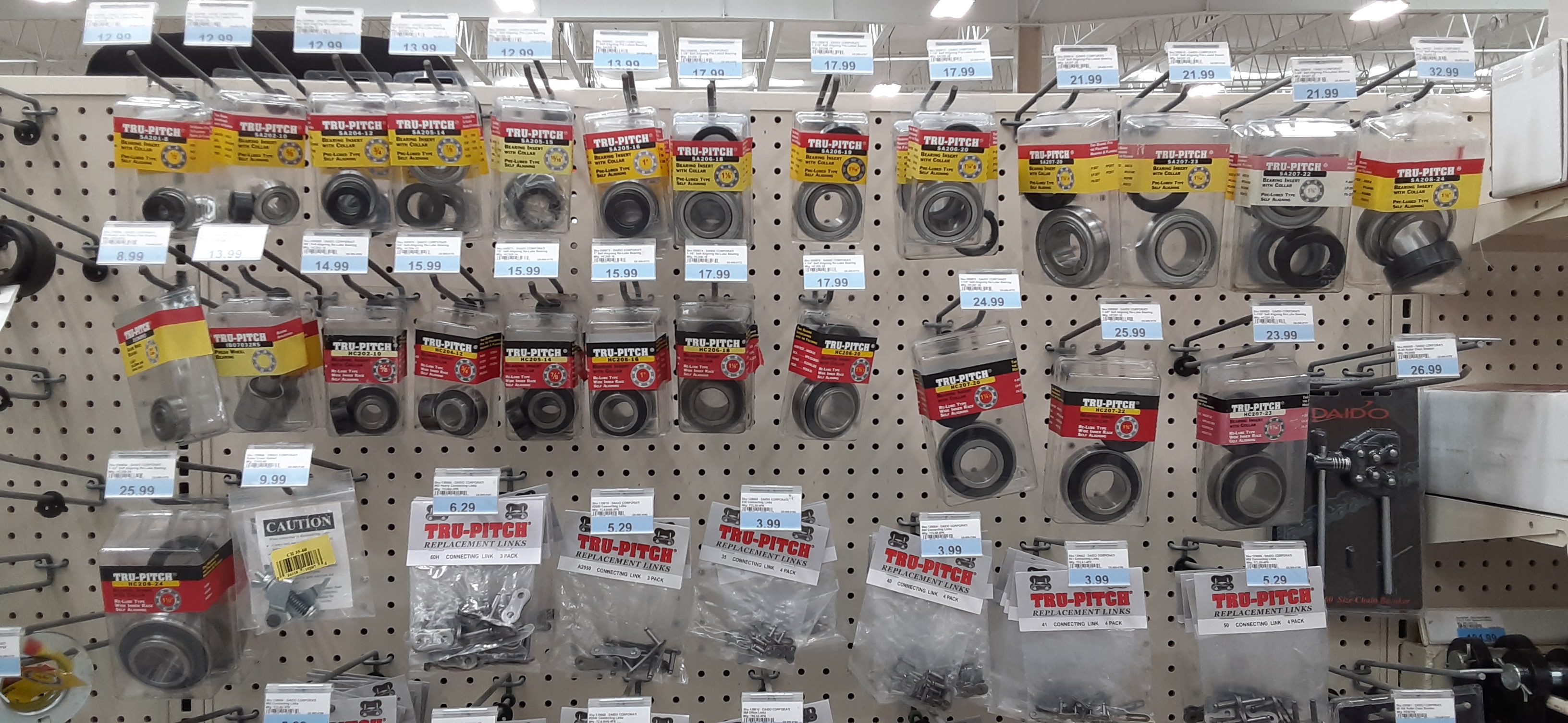

I was in Tractor Supply today. Plenty of bearings to be found. A bit pricey vs online shopping with free delivery.
