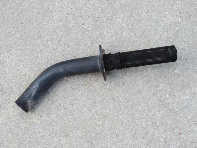

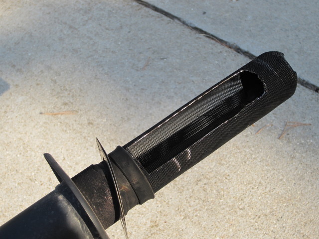

I have a low hours 2006 rtv900 and just pulled the exhaust outlet. The screen was half plugged. I read where you don't want to cut the whole screen section off because that section is supported on the inside. I will use dremel tool to cut some of the screen out and report back.
   / RTV 1100 I need more power #14
I took only 1/3rd of the screen out(one section), and reistalled with antiseize on the bolts. I went out for a test drive and was thinking I would feel a difference on the top end. Instead, it seems like it has more grunt off the line. Like I said before, do not cut the whole screen section off because it is supported about 1/2" from the end inside the muffler. That support keeps the flange from cracking/breaking. All I needed for tools was a 5mm socket head wrench for the two 6mm socket head cap screws. RTV900 muffler 001_1.JPGRTV900 muffler 002_1.JPG
The pictures were taken after I blew all the carbon out of the screen.

On my RTV 900, IIRC the manual said to clean the screen every 50 hours or so. I just removed the whole thing. It says you need the spark arrestor for park use and since mine never leaves the farm, I just took it out and threw it in a drawer in my tool box. One less thing to maintain. It had 40 hours on it when I removed it and it was almost stopped up with soot. The screen just slipped off and I put the tail pipe back on.
