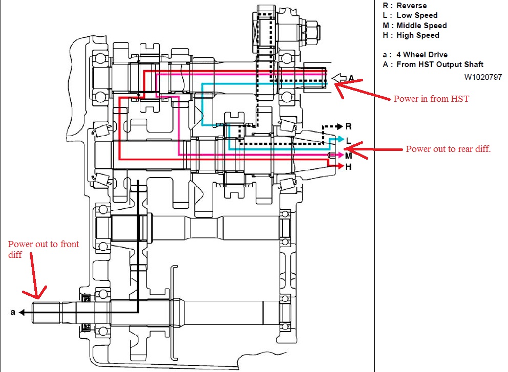

Just an update on this issue. I have been too busy to deal with this, but I am trying to get back to it and get it fixed. I appreciate the comments and ideas.
The rear drive shafts do not turn at all. I assume the problem is in the rear differential I was hoping to fix it myself, but certainly don't understand these systems very well. I would be so nice if l could repair it myself, but unlikely at this point.

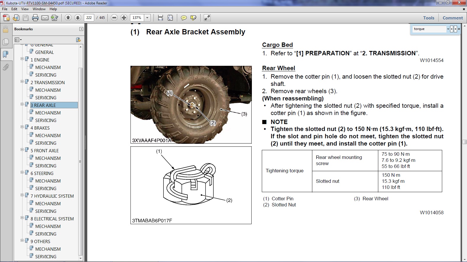

This got me to wondering if my axle nuts were tight. I popped the rubber cap off the rear and after finally getting the cotter pin out, I found that the drivers side nut was not even finger tight. I got about a half round out of it before it got tight. I don't have a torque wrench but using a 12" ratchet I torqued it down to the next hole after it snugged up. It is a long way from a 17mm on my 2009 RTV 900, would you believe 30mm nuts on the back. I didn't check the front at this time, maybe later. Only got 270hr on it.

OK, just checked all 4 slotted axle nuts on my 1140. My WSM says 140 ft lbs on rear, 110 on front is spec, then tighten further to insert cotter pin, as necessary
Rear nuts, found that 1 3/16 SAE fits pretty well, didn't have any such large metric socket.
Nothing obviously loose, either side, lock washers all squashed flat and flat washers not loose (as reported elsewhere in this thread).
Rubber boot comes off rather easily. Cotter pin yields reasonably to pliers and hammer.
Tried to LOOSEN left rear. BROKE my CRAFTSMAN 1/2 " ratchet socket handle...yes, had cheater on it, but wasn't standing on it or anything, just pushing at about 1.5 ft out, am guessing 150 ft lbs or so. Decided it was tight enough and reassembled.
All 3 other nuts, I also checked with a different 1/2 inch socket wrench and beam toque wrench handle I have that goes to 100 ft lbs. All other nuts really, really tight such that I feared breaking second ratchet wrench. So, reassembled and left as is on the theory, let's not break anything else!!
So, am comforted that axles will not suffer stripping problem as discussed in this thread.
And, at least my 1140 was assembled properly in this area, so not all RTV'S are under torqued on their axle nuts.

Update: We were so Blessed to have the KTAC insurance! It turns out a t-post (obviously one lying on the ground that shouldn't have been there) was leveraged up by one of the front tires and rammed up through the frame of the RTV. It knocked a hole in the transmission :eek:uch: I can't believe it didn't immediately lose all the fluids and quit completely. The t-post even damaged some of the gears inside the transmission.
Bottom line: Kubota KTAC took care of every expense to the tune of well over $8,000 :thumbsup:
