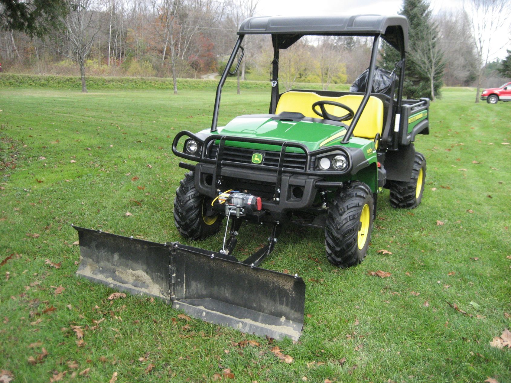

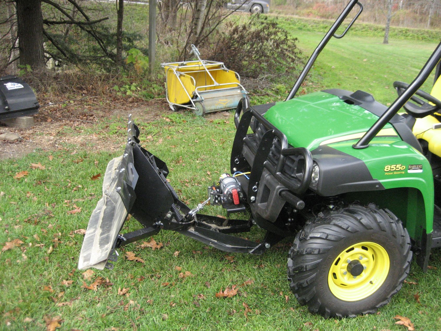

I don't have the RTV 500 or the Eagle plow any longer or I'd take a picture for you. I switched to a Gator 825i and Boss V plow set up.
I did put the Eagle V plow on my 825i for awhile but it was too narrow for the Gator's width....I used it one season like that and bought the Boss in the off season for this year.
Here's a few pics that may help you
To change from straight to V or scoop you remove a hitch pin and move that 2" or so square tubing to the next set of tabs on the plow blade
Here's a pic of it in scoop ( you will have to give it some extra "love" the first time you put the plow in scoop....it will be a firm push but gets easier each time and the scoop position is really what puts a V plow way above a straight blade for me.....the ability to quickly clean spillage can't be overstated.
Here's a couple pics of the plow in V mode on my RTV 500
Personally I'd skip the $50 synthetic rope....get a 2" winch strap like is used on a boat trailer....cut it down to about 9' long so it will fit on your winch spool.....take about a 2' long piece of duct tape....get a few wraps around you winch drum and then stick it along your winch strap...then just wind it in. The winch strap will last for years and you don't need to worry about your rollers either....as long as it is extremely sharp the strap will be fine. I used the same strap on both my RTV and Gator and never did need to replace it......I pulled it off in the spring and put my regular line back on....just before plow season I swapped it back on. (The pics show the RTV 500 with a steel cable, that was when I first installed the plow...the steel cable lasted less than 2 storms and needed to be replaced at nearly $70 it didn't take long to figure out that wouldn't work) Also to keep your strap/rope/cable/winch from breaking back up just a little from your snow pile before lifting the plow and you will not be trying to pick up a heavy snow bank with the plow each pass.

Two angles (both to left and right)...I'm estimating it's 15 and 30 degrees.
You wouldn't have to remove the skid shoes if just angling the straight plow...only when you us it in Vee or scoop.

Yep, he has replaced the push tube at least once. I have both the bent push tube (which doesn't really cause any problems...I'm using it now) as well as the replacement tube DIXIEDOG bought. Come warmer weather (when I dismount the plow). I'll beef up the push tubes.
