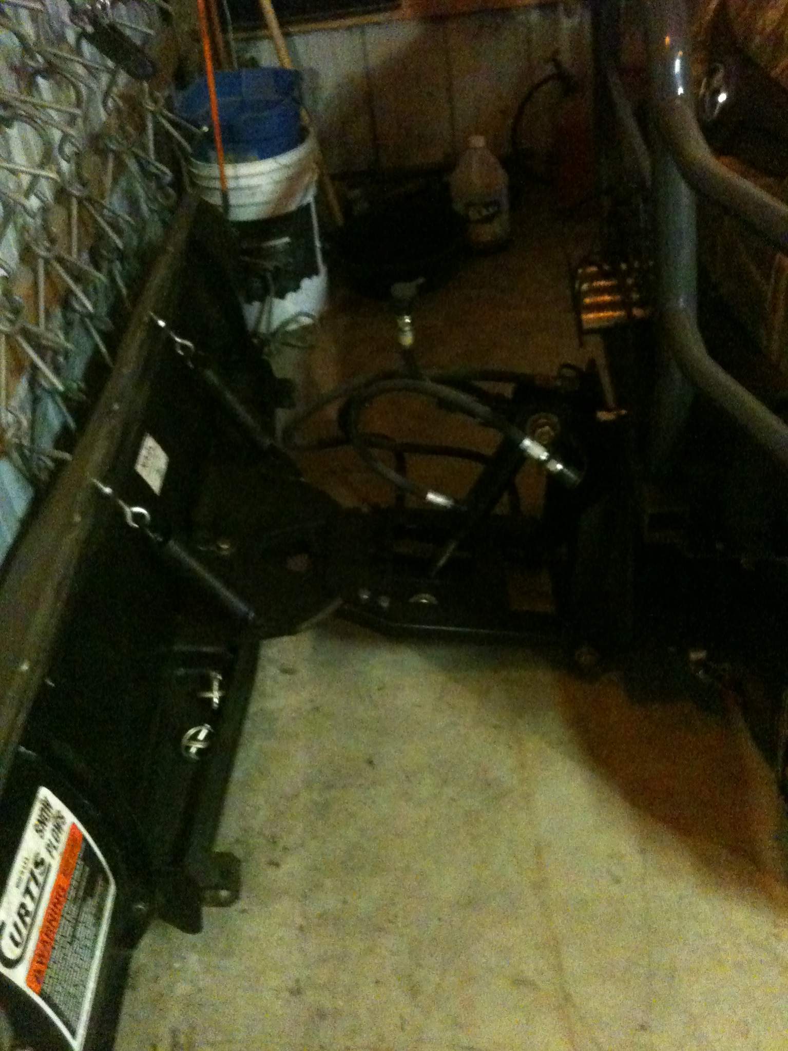

Now that statement is a real HOOT!! I have been useing my 2006 RTV 900 snow plowing here in michigan every winter since 2006.All I can say this baby plows snow like theres no tomarrow.Find a different dealer whos knows what he is talking about.coobie

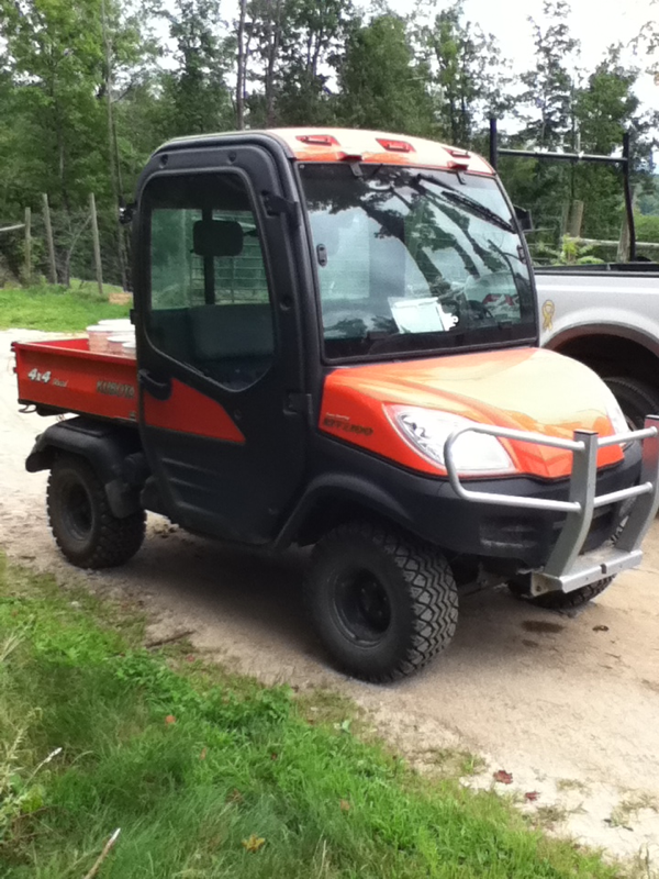

My grandfather has an RTV 1100 and it sucks at plowing also. We have an elk farm in New Hampshire. We use it to feed them and we are very satisfied with it. His house is at the top of the hill and the elk the bottom. In the winter thats whatwe use for climbing the hill. It works awesome.

I have an 1100 and mine does a great job of plowing...Where are you having issues? The worksite tires aren't the greatest for snow, I have ATV's on mine.
