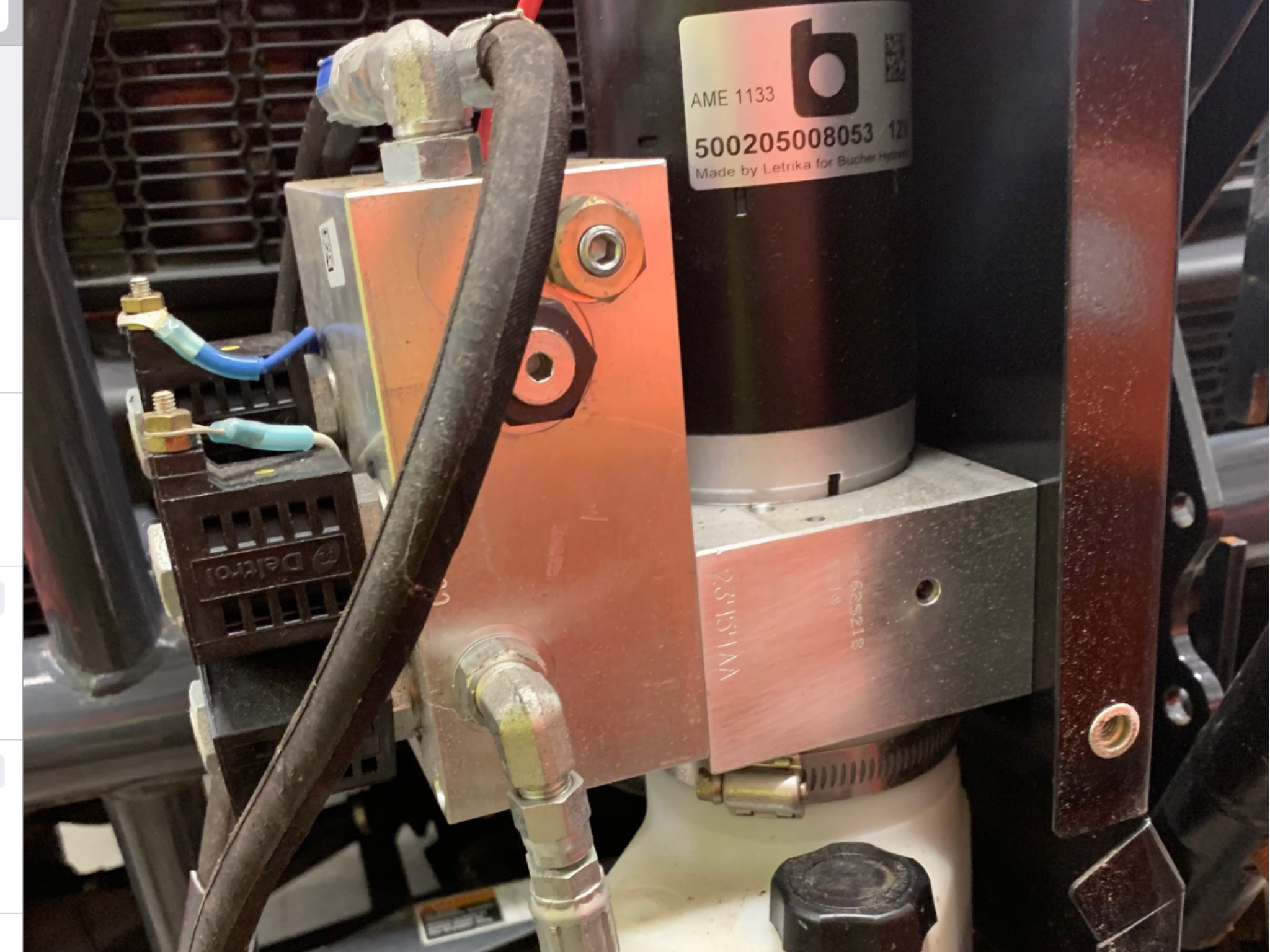

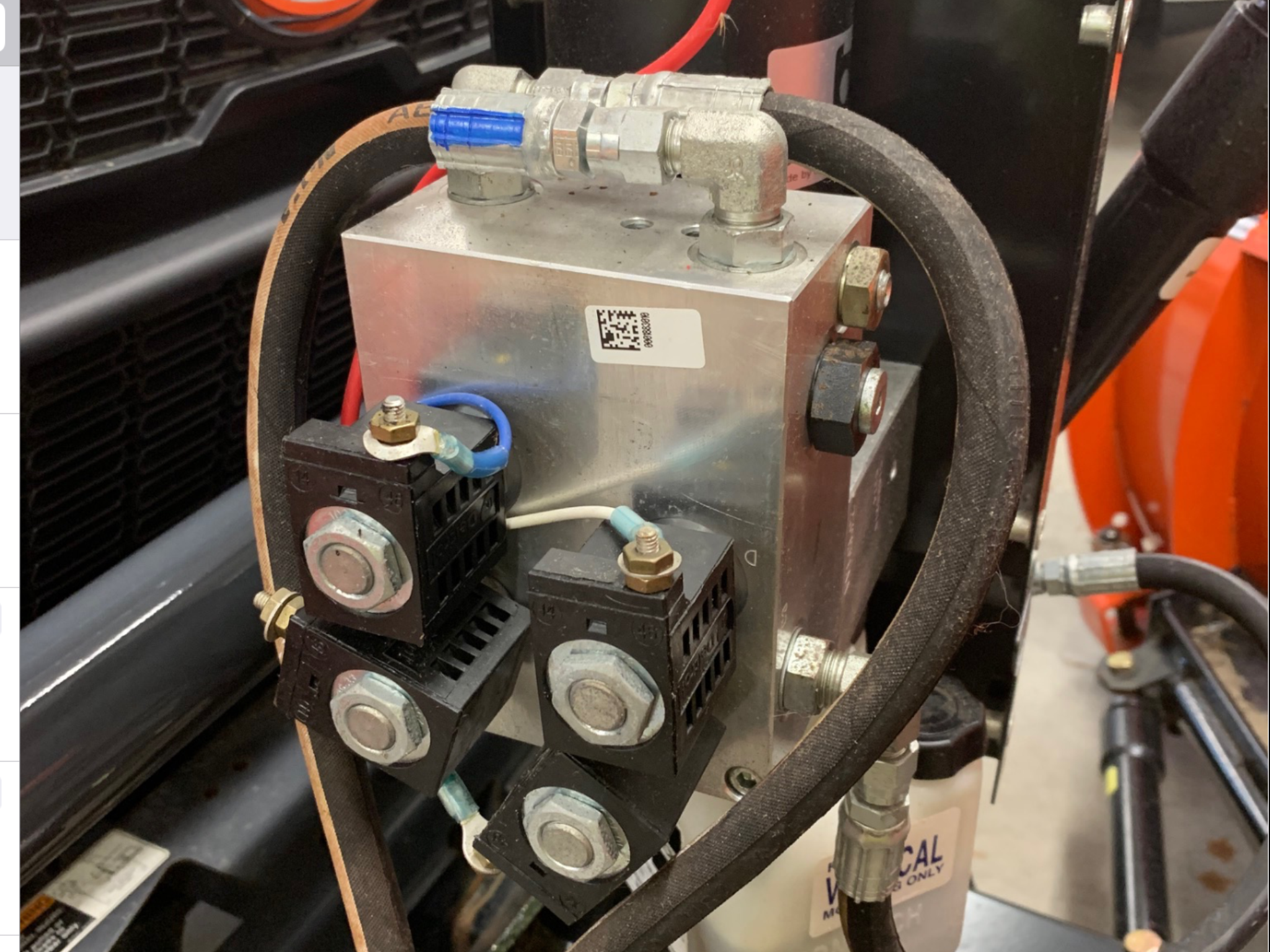

I have a Kubota RTV 1100 with the Kubota electric over hydrolic plow. It goes up and down, and angles left but will not angle back to the right. Nothing is bent and all the electric connections are good. It worked a month ago when I put it on..then today I went to move it and it would not angle.. any ideas ?

Ok. Is there a hydraulic block that the angle cylinder hoses go to? Sometimes there is a check valve in those

This is what it looks like

Maybe take a test light to the wire going into those solenoids. I’m guessing one is not getting the signal to open or it’s stuck
I just tried that.. I had my wife push the up,down,left, right and I thought if I had the test light on which ever solenoid controlled that function..it would light up. But none of them do. ..but it still goes up and down..no lighting the test light up... there is a power in cable at the top of the motor and that lights up ghe test light. ..so it's getting power.

#20
So I went over every inch of the wiring and connections. They all looked good but I still took every one apart scuffed and reattached them. Took the trailer plug out, scratched both the plug and terminals to make sure they were clean and plugged it back in. Still no good... then went to the back where the 10 amp fuse is and checked that. Fuse was good. .. then tried to move the plow...and it now works. ... I don't think it was any of the electric connections, I think it has a solenoid hanging up and maybe removing and replacing the fuse may have done something.. idk...but it now works. Go figure.
