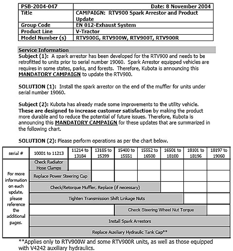

Did you have the muffler inpected by Kubota as part of the upgrade campaign before this happen? Just curious if this may still may be a problem even if you have the inspection and adjustment.
/ RTV recall #22
No, although I should have. The dealer is quite a distance from me and I will need to rent a trailer.
I did contact the Dealer after the tail pipe fell off, which informed me that there was a campaign issued on the muffler, which will be addressed when I get it to the Dealer.
In the mean time I welded the tail pipe back on and also welded a 45 degree gusset to the tail pipe and the base of the muffler. This stopped the tail pipe from vibrating from the resonance of the engine.
During our hurricane cleanup, our RTV set in neutral at an idle for 5 to 15 minutes while we loaded the bed. Our debree included 34 trees. I believe this length of time in neutral at Idle, where the vibration is at it's highest, is what lead to this early failure.
Bud D4, RTV900W, 150hrs
