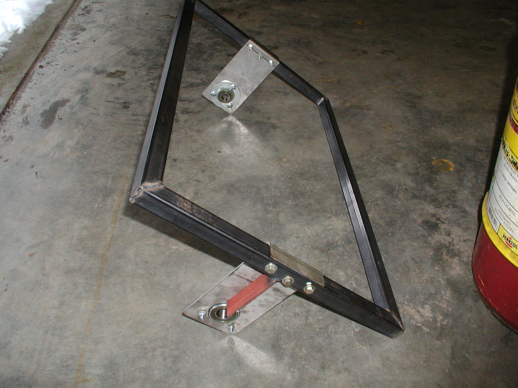

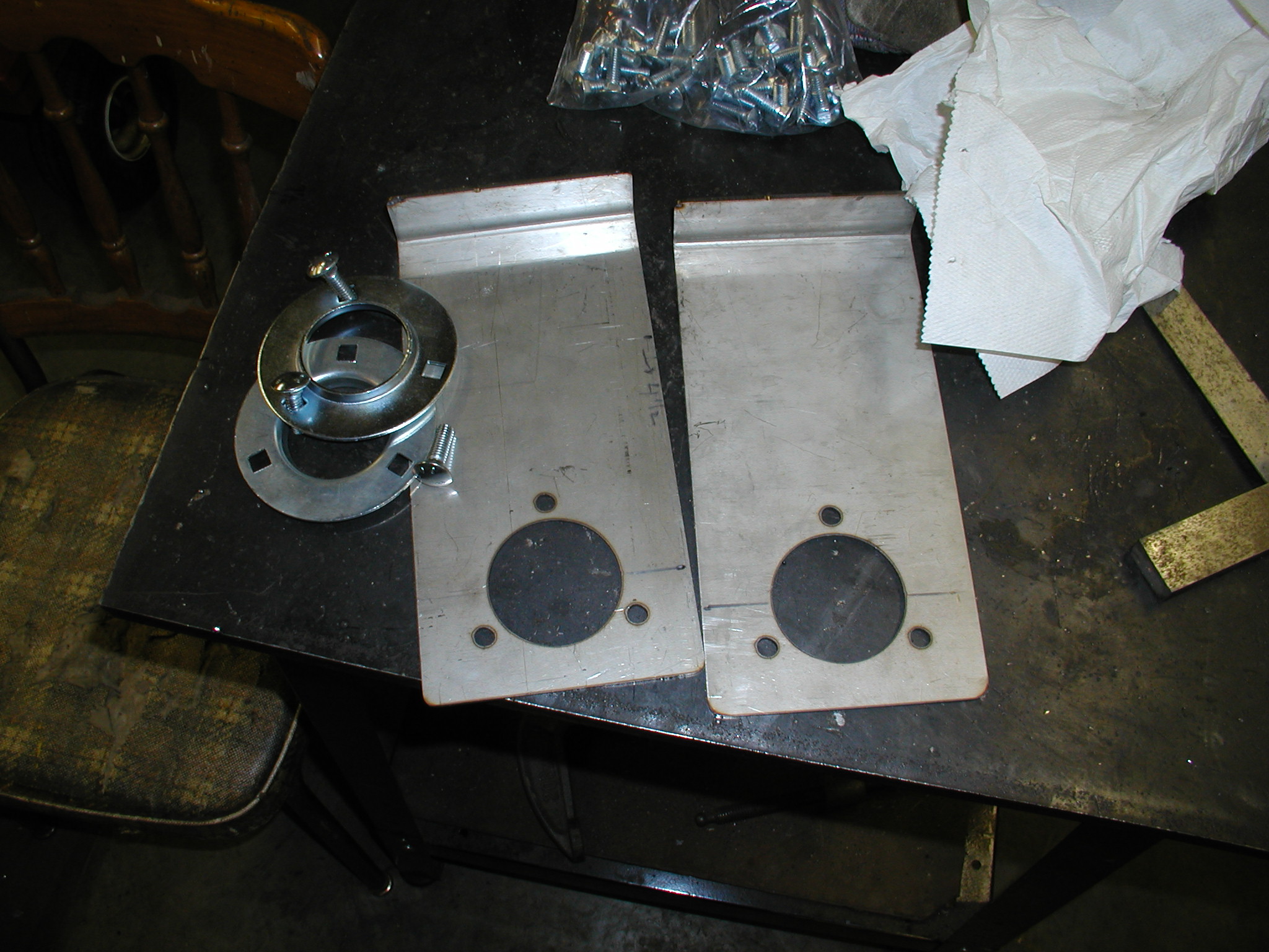

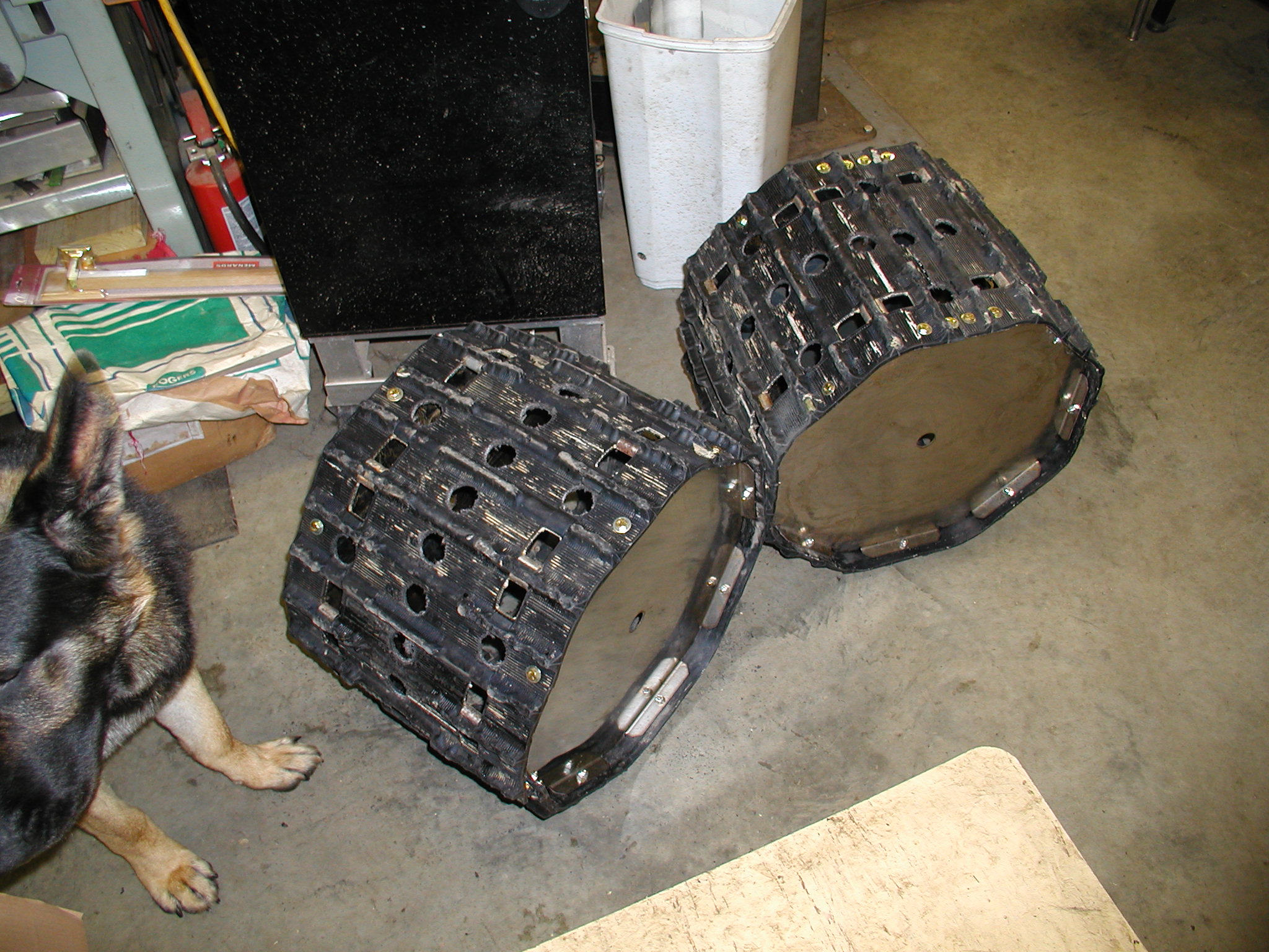

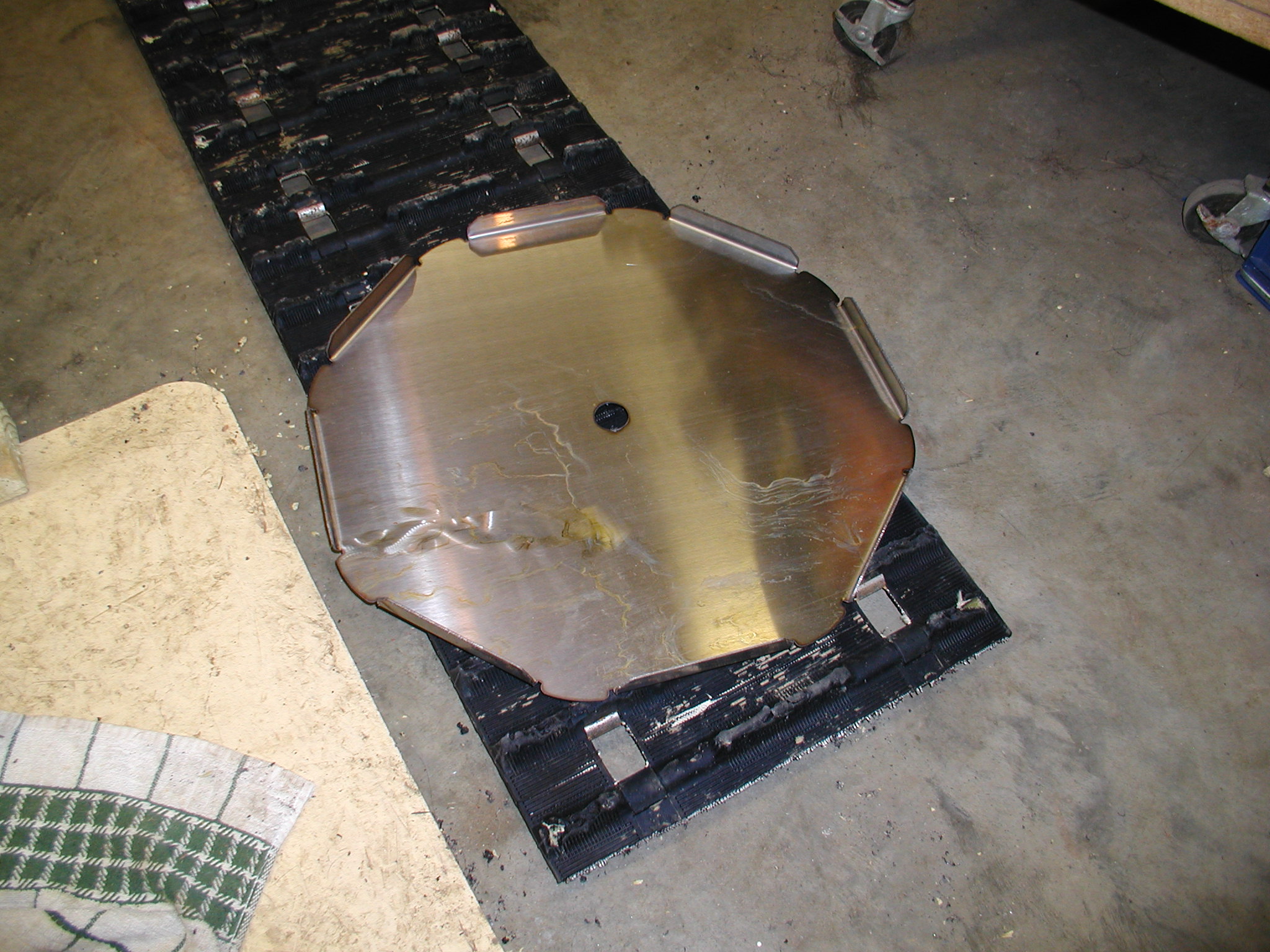

The roller groomer is homemade. It is not a first-pass groomer. For the first pass or two especially in deep snow like this year, I simply drag a 3 foot square pc of floor mat. The floor mat is the kind you'd put on the floor of your shop for comfort, full of holes, thick rubber. I lace a cable thru the mat diagonally so it pulls from on corner, and sometimes at some weight to it. After a couple passes in early winter with the drag mat, I start using the roller groomer after every snow. The idea is to keep packing the snow so it freezes together and supports the traffic better. A rough surface has shown to freeze better and offer some surface traction too.
I found a few more pics of the groomer build...
Ummm, sorry for high-jacking the thread, its just that there are so few guys with interest in tracks in snow.

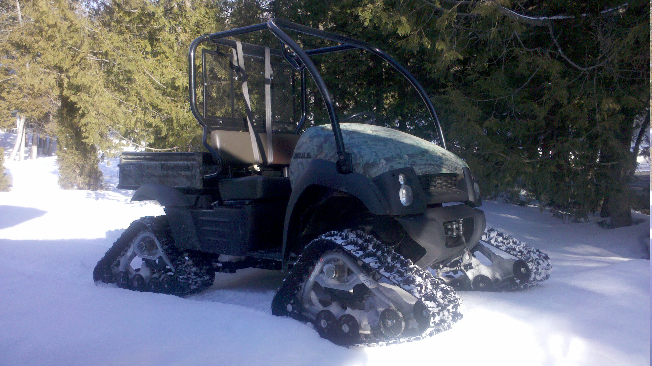

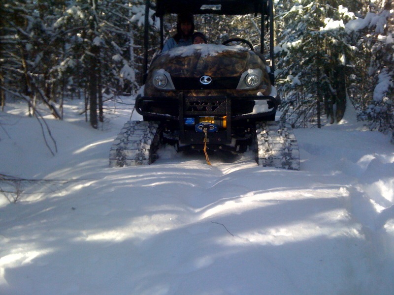

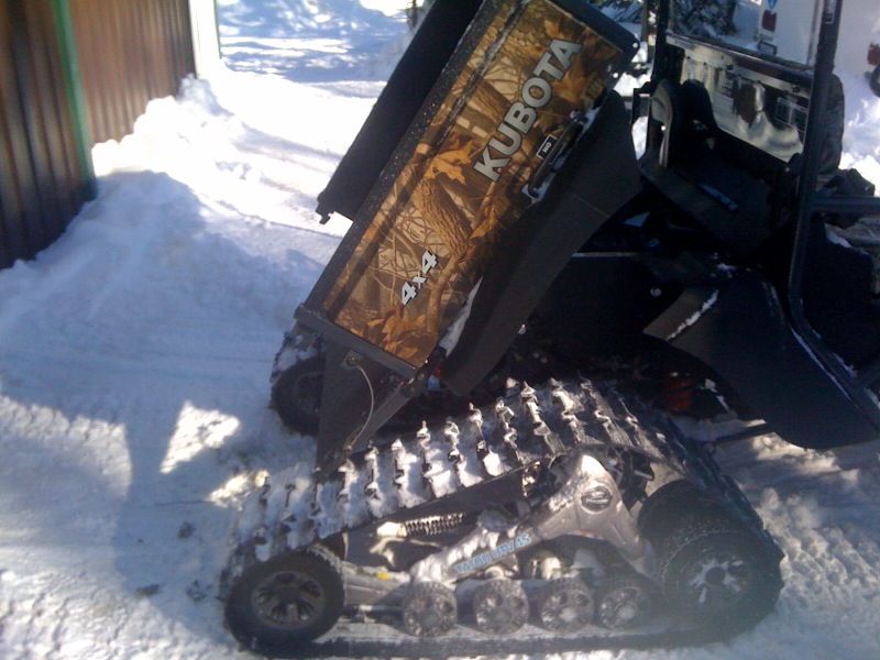

Not quite but close. I got it hung up on the peak of a snow bank but reverse and back over it was fine. Still haven't found a use for my new winch:(
Limits.....the tailgate hits the track when dumping and on a quick turn into a sharp climb the front tracks do start to rub the front bumper even after my cut-off
turning radius i paced around 11 ft (22 ft diam)
goes backwards in powder as well as going forward
The trail pic is from our woods after last weekends snow. I got out up to my knees to take the pic to show how it just floated over all of it:thumbsup:
