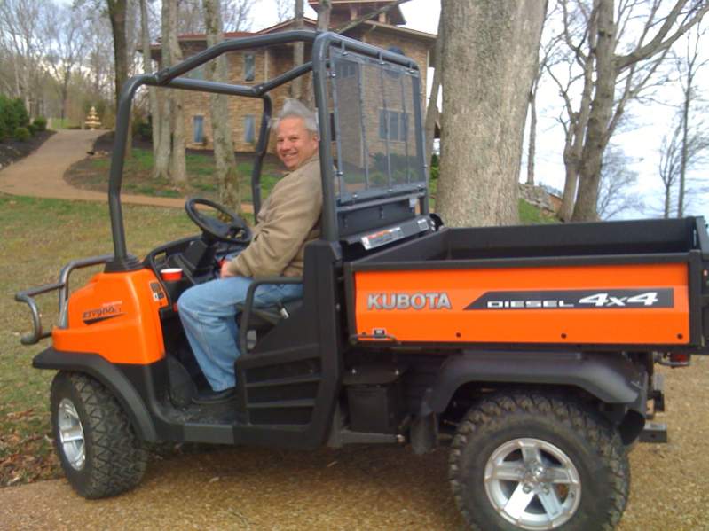

Just got the 900rtvxts this week it looks great. I hooked up a trailer with about 750lbs of dirt bags. It pulled up and down a dirt path that has a 30+ percent grade. It felt very safe going down the hill.
