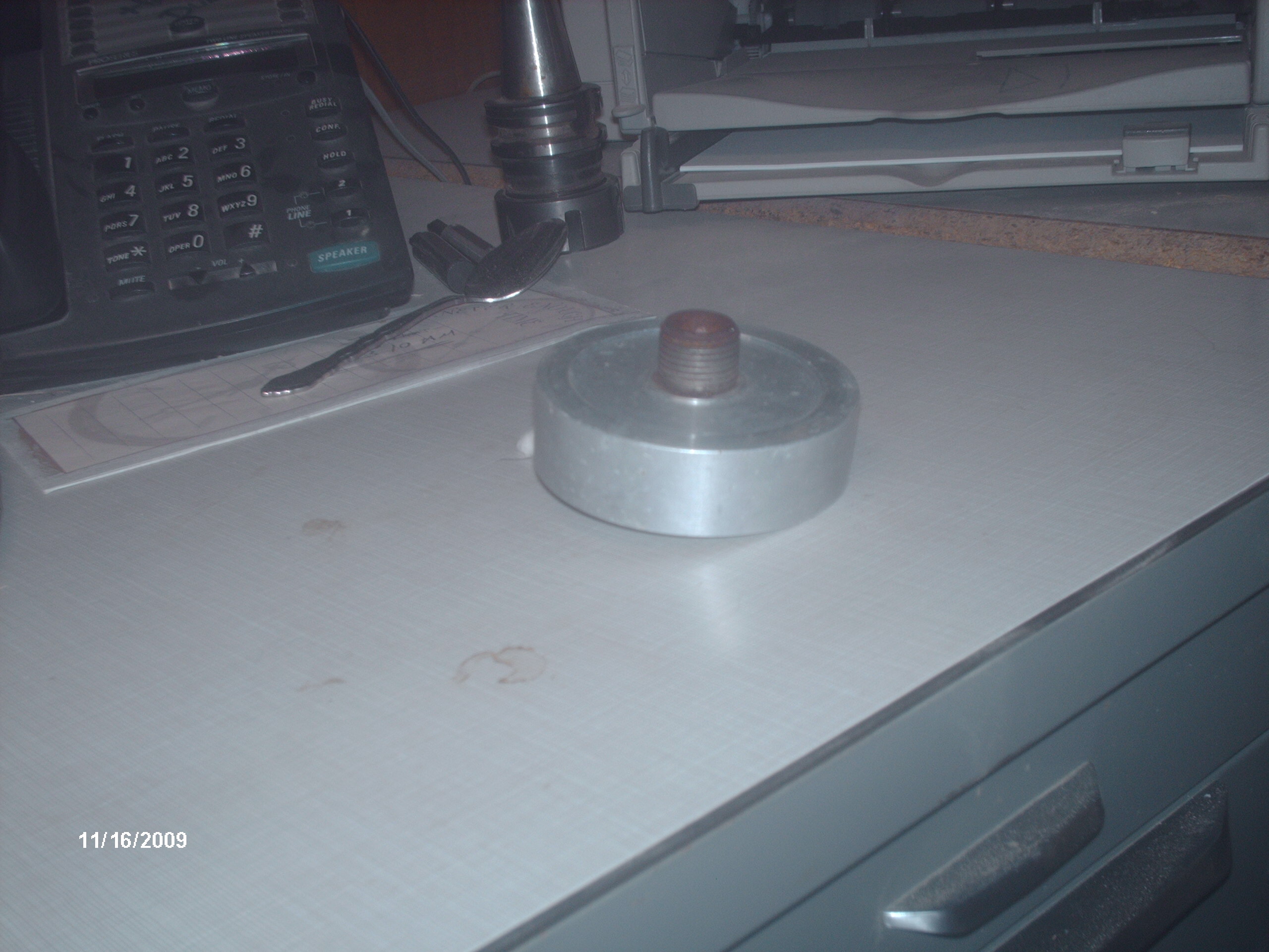

Sorry Guys,
Have not had time to work on my adapter. A paying-job managed to jump onto my milling machine, before the adapter. Pay-job takes 1st priority on the machine, job should be finished by the end of the week. Then I can get back to the oil-filter remote adapter project.
Rick

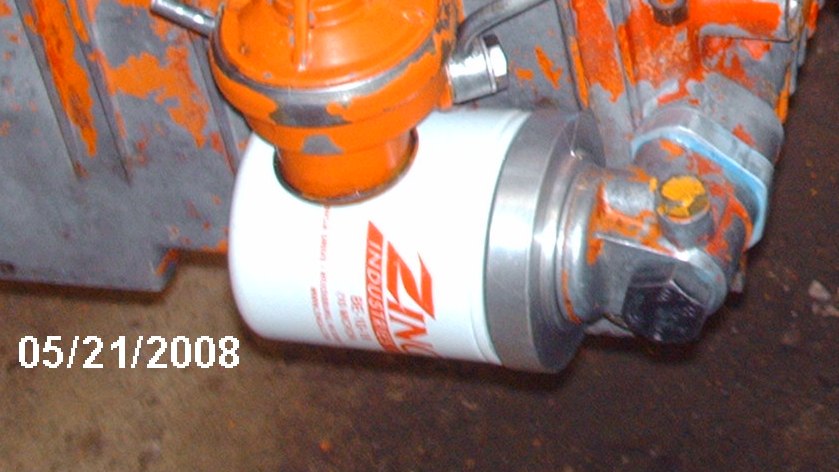

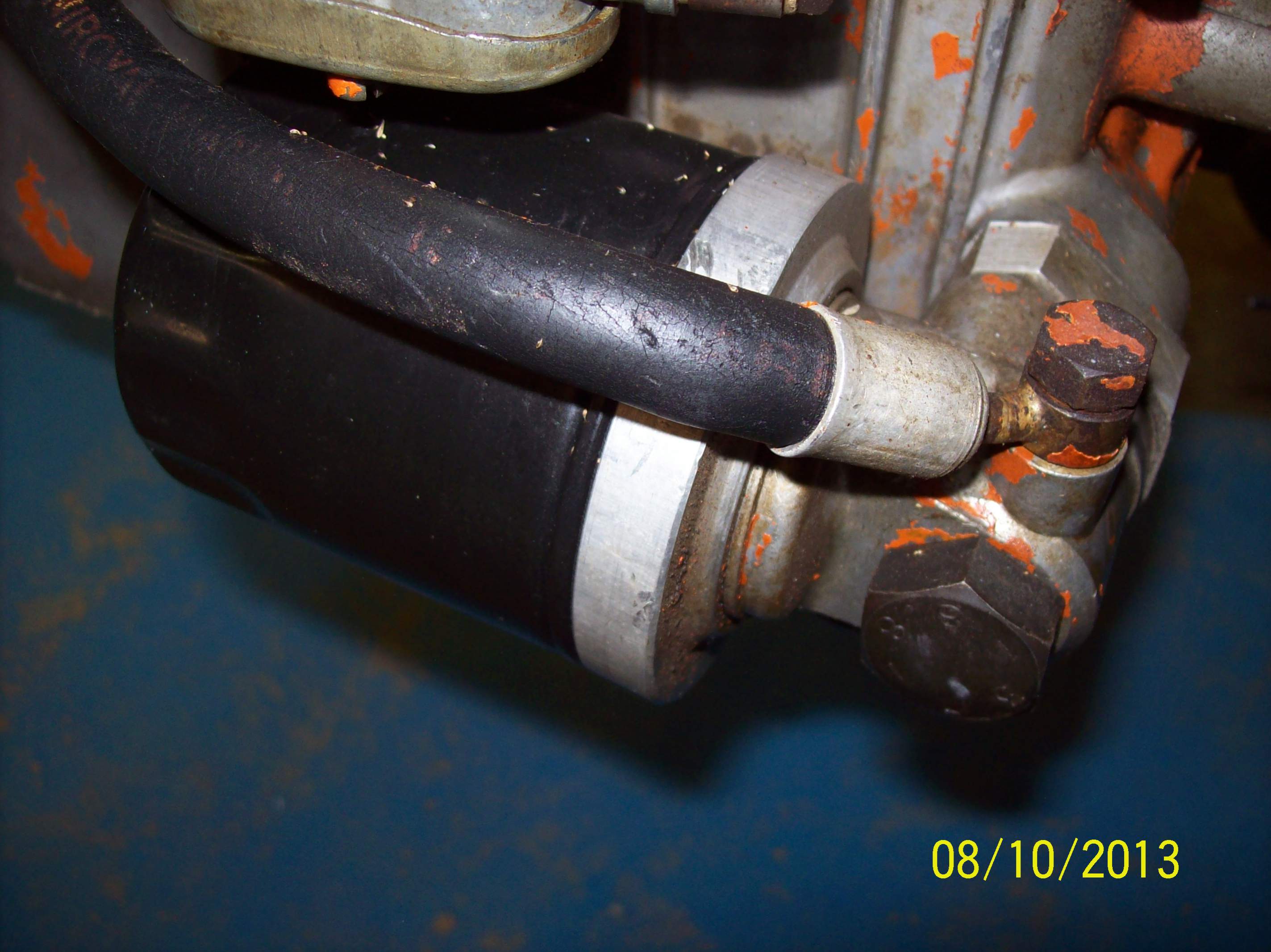

I have 3 different versions of a filter adapter for the Ruggerini. They all do the same thing and use the same 3614 filter at about $3 to $4 each. The 3614 is a very common filter.
The first one is of my own design. Of the 3 it is more complicated to machine and could use the simplicity of the second one.
The second one came on my 997 is simple and works well although it could use just a little more work.
The third one came in a box of Ruggerini stuff. It is very simple and requires the least number of parts. I gave this one away to someone with a Pasquali Tractor a few years ago and no longer have it. This one uses an offset mounting hole rather than the spacer and longer mounting bolt used on the first two.
I have a cad drawing of the first one.
The 997 has a loader on it with no clearance issues to the filter.
Joe
