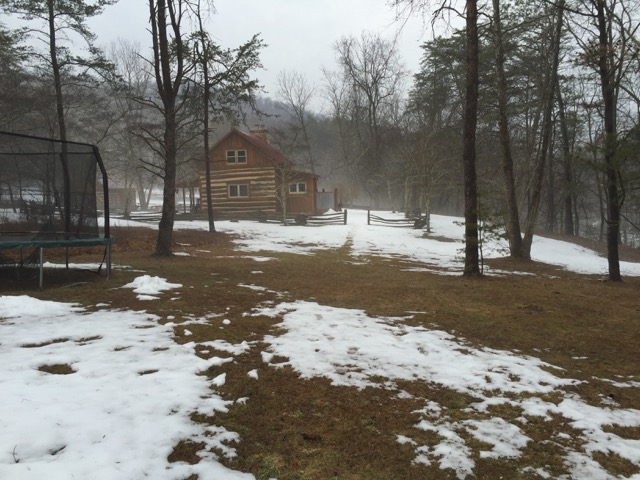

Once the snow completely melts off, I'll start searching. There is nothing above ground, but I know the general area of where it will be. I just want to know specifically where all the pipes are located so I don't bust them when I run a water line from the cabin to the barn.

though the snow isn't completely gone, I took some pics of the area where I believe the septic system sits...

Re: the septic tank. The snow over mine always melts off before the rest of the snow. Also, the grass dies off first over the tank in mid-summer as mine isn't buried very deep.
