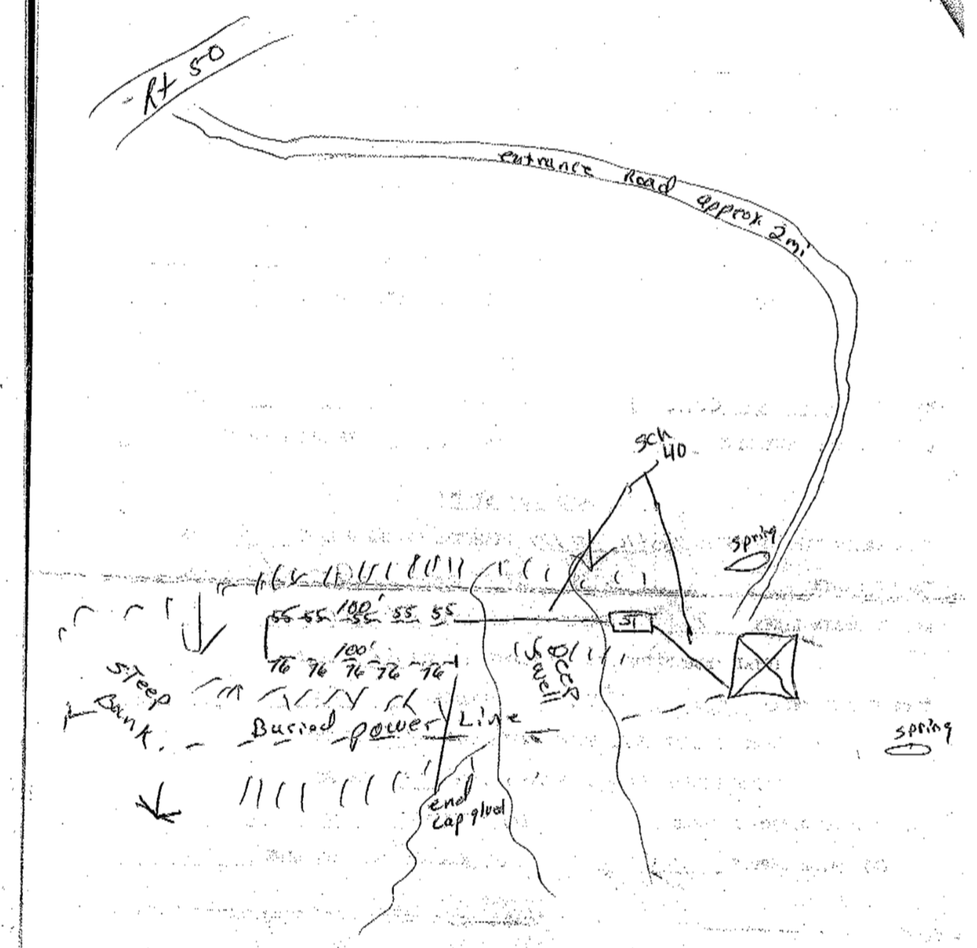

Now here's another question. The septic system was installed in early 1990. When I bought the place, the guy didn't know where the septic was exactly, but said his dad had drawn a diagram when he filed with the county. I did a little research and got a copy of that diagram. (Note: I'm pretty certain this diagram wouldn't be accepted at any county government today). Not only is it not to scale by any means, but the orientation of certain objects on the diagram don't seem right. Anyway, anyone know how to read the numbers that are sketched around the area that seems to be the septic field? I'm assuming the box with ST written in it denotes the Septic Tank.

There are 2 100ft . runs of field tied together at the end .I am guessing the 55 & 76 have something to do with depth . Actual depth or what they shot with the transit .

What is "shot with the transit"?

shot with a transit = took depth reading with a rod and transit.
my septic system was filed with county with a hand drawing like that, not that unusual.

A transit is a precision instrument for measuring angles in the horizontal and vertical planes. When you think of the classic image a surveyor, the thing on the tripod that he's peering through is his transit. To shoot a line with the transit means to measure a straight line at a given angle. Usually the surveyor sets the transit up at a known location, and has a helper hold a stick a distance away and he points the transit at the stick. He has the helper move the stick until he measures the correct angle.

any tips on using that hand drawn map to figure out where the septic field is? Probably can't use metal detectors, or any sensors that Miss Utility uses since the pipes are just plastic...

Do you know from the inside where the pipe exits the house? Should be near corner where electric enters. Shows a swell, where is that in relationship to the cabin?

Looks like if you stand facing N. from the cabin the field is on the left. The shc 40 looks like a water line.
   / run a new water line or dig a new well? #60
Sch 40 is the septic line house to tank, and tank to field. Field is west of house, on the other edge of a hill (swale). Swale goes north south. Are you Near loom?
