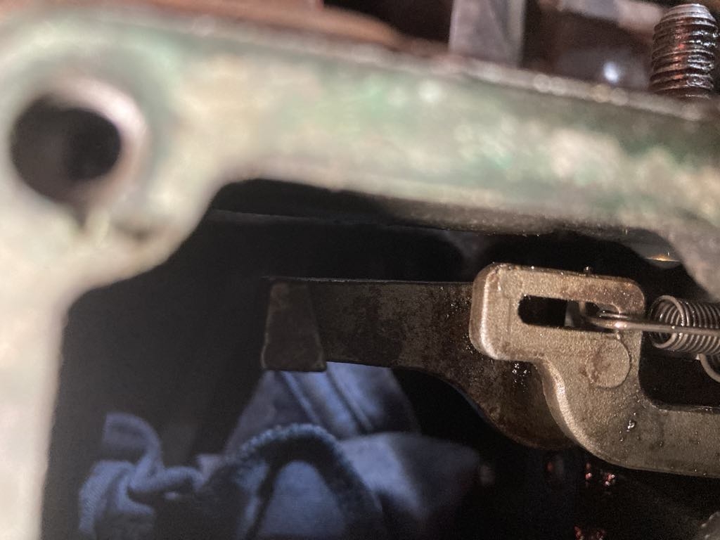

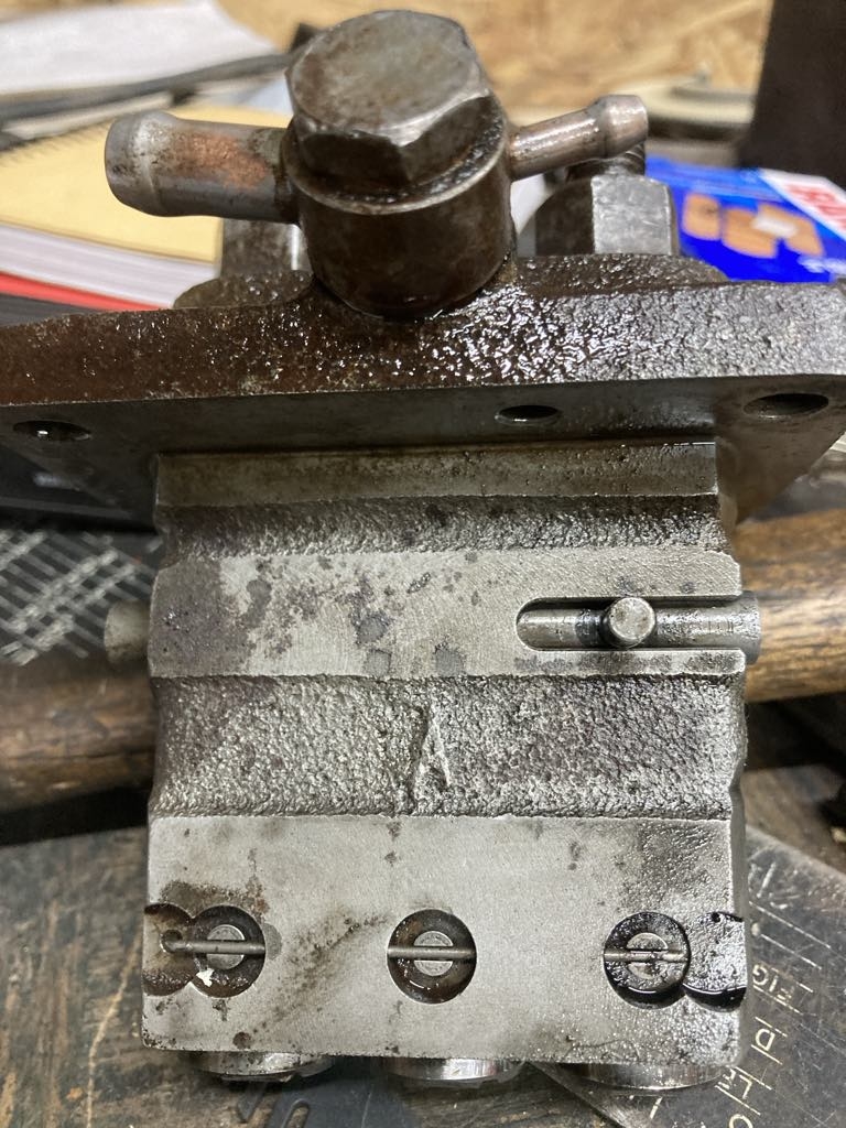

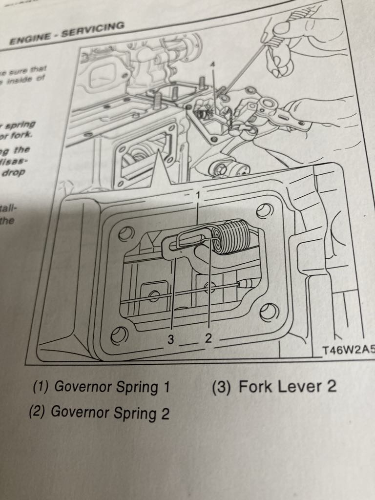

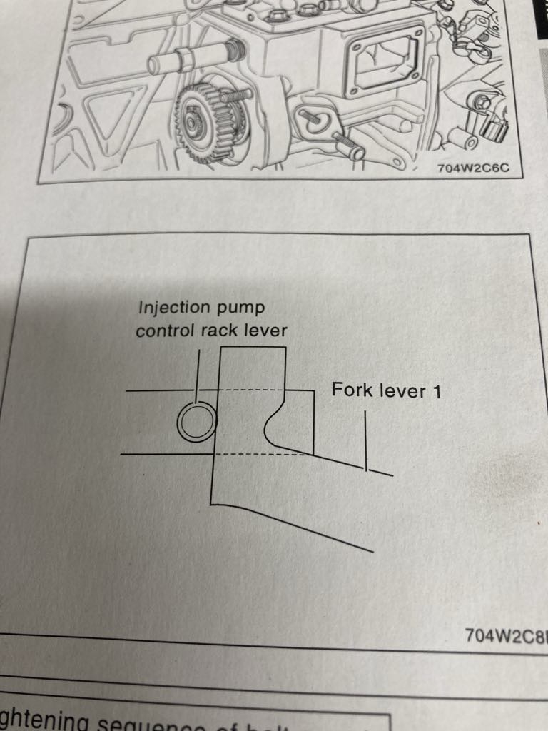

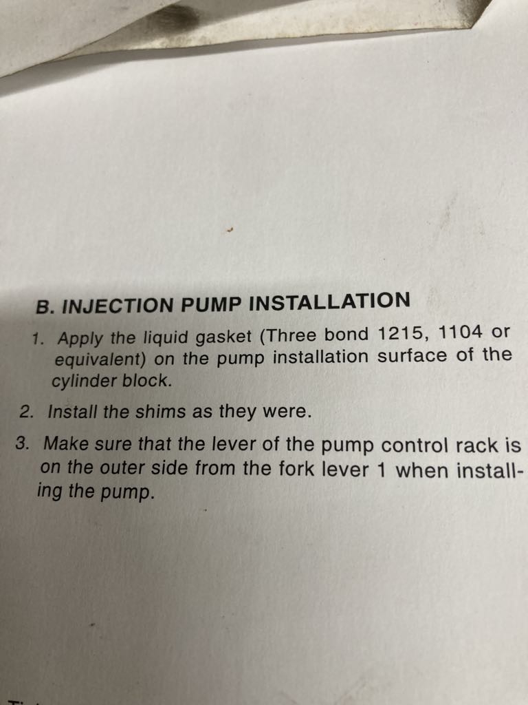

Kioti ck 25
I just had the injector pump serviced on my ck25. When I reinstalled it and started it up it went to fill throttle. (Run away). Luckily I was able to block air intake fast enough to shut it down before it blew up. I think I reinstalled the pump with the control rack lever in the wrong position. Looking in the service Manual there is a diagram but it is not very clear to me. Any thoughts on proper reinstallation would be appreciated.
