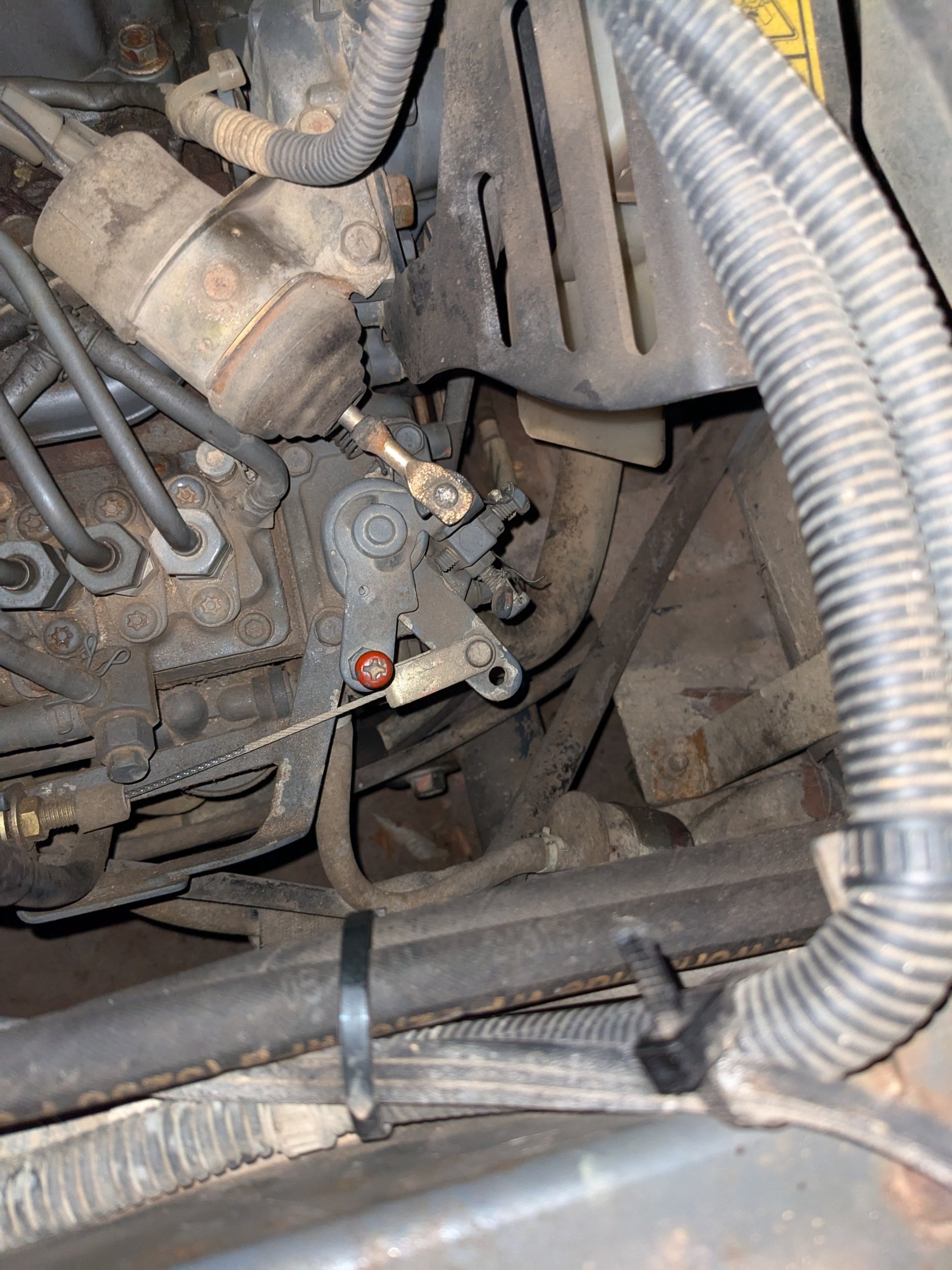

so here's my injection pump
governor, power control is on the right of this.
the top lever with the red screw is the fuel kill, which of course did less than nothing even when I manually pinned it on it's stop.
so bottom line I don't know otherwise how the fuel is controlled in this unit.

/ runaway rtv900 engine??????? #8
U have it correct, it’s the same as your previous job.
Bolts on the 4 corners..
U might have a slight problem if the rack is stuck, only because the rack has to be in a certain position to allow the rack pin to pass..
There’s actually a CUT OUT in the block to allow it to pass..
Do yourself a favor and watch some videos… they’re all basically the same..
Kubota has some decent ones.. your pump is called a PFR PUMP..

#15
so the video looks exactly like my setup, thanks for posting that link.
my question is, That guy had a problem with a stuck "rail" that closes off the fuel, so when he tried to actuate the shut off link it wouldn't move.
But in my case that moves just fine, the key actuates it and I can move it by hand freely, but obviously it does nothing because the thing went
haywire.
So would I want to pull that pump assembly but leave the throttle/cut off assembly in place? And will the fuel rail pin clear all that? I guess I'm not understanding how that pin on the actual pump itself hooks up to the linkage that actually moves it back and forth?
And then I guess since mine moves freely there must be something internal to the pump that blew out? Possibly just one injector went wide full out?

#20
so I just got the pump out
the plate that holds in the fuel rail cut off was so loose I could just thread out the 4 phillips screws by hand without a screwdriver. I'm thinking it allowed the fuel rail to skip over one or more of the injectors off that little thing that the rail keys into.
so my question is, is it safe to re-use this pump due to whatever unknown reason those screws got totally loose? If so, how do I ensure they stay tight? It covered in oil now obviously so would I clean it in a parts washer and use some type of locktite or something?
I'd rather spend the money on a new pump if there's any chance this will happen again with this one.
