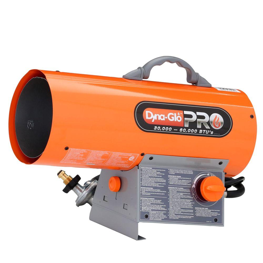

My question is about pressure. I have a 500 gallon tank outside and ran my own copper line to the house. BUT the LP company had to pressurize it all and set the regulators for something the in home devices could use.
So, you need to consider the pressure in the tank and whatever the heater uses. If there is no mismatch, you may be OK.

Yep, you need a regulator typically. Our house has 2, one at the tank and one at the house. All we use propane for is backup to the heat pump. And the pressure switch in the furnace has to be happy for it to fire the propane, hence the regulators.

I don't know what you are calling a short distance, but I'd get a roll of soft copper long enough to do the run with no joints.
Using a 100# bottle usually the regulator is on the bottle or attached to pig tail next to it.
That means just one joint at the appliance to check with soapy water and one or three at the bottle.
   / running my own propane line? #20
While a leak at the tank isn't good, it's the joints inside the building which are critical.
