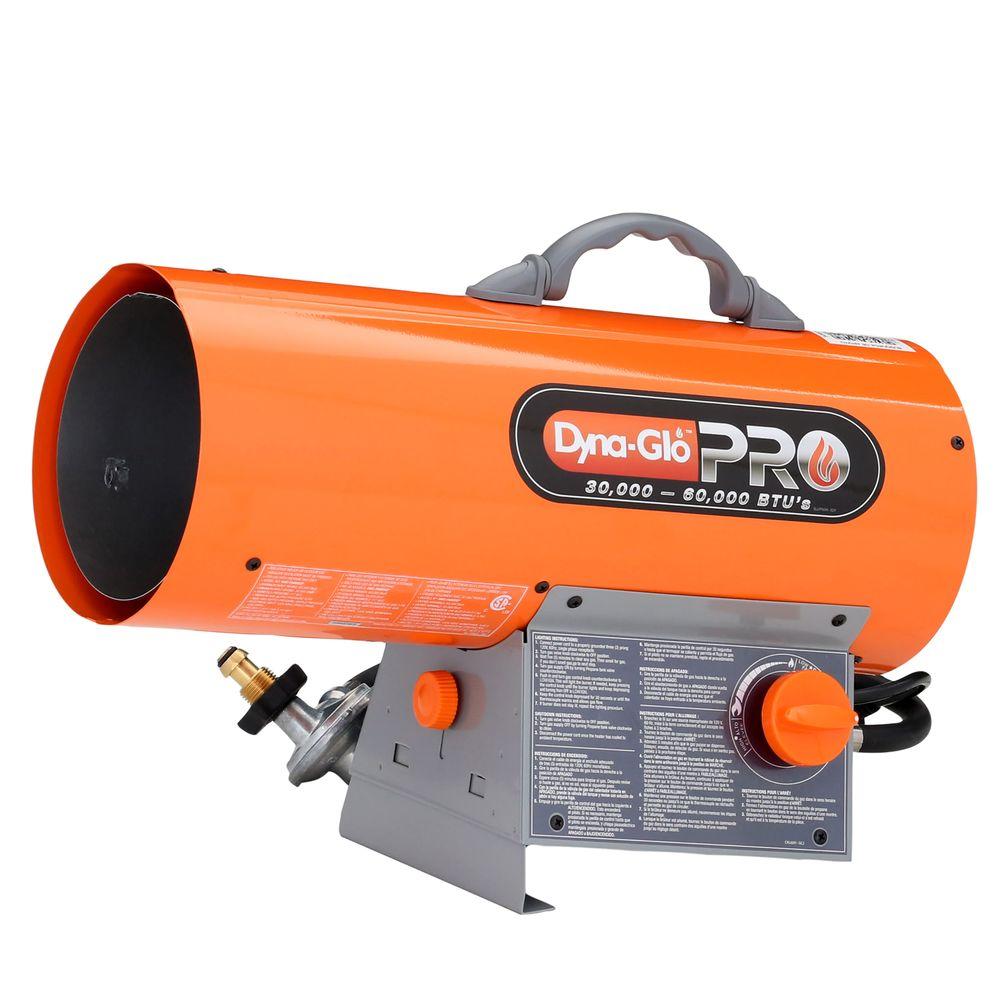

If its a 100 lb tank it can be inside the place where the heater is, does not need to be outside
Even if it's allowed I still wouldn't advise it.
   / running my own propane line? #27
Maybe not, but these come with a 15 foot hose and are designed to use in a barn, garage or other such place
best I remember, the decal on the tanks state do not use indoors (or something along those lines)
