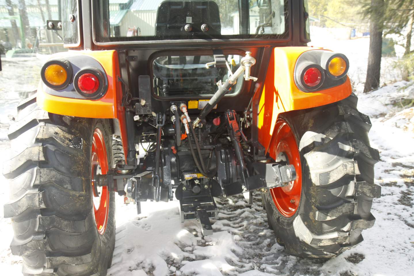

On my Kioti i ran the hoses under the cab then right besides the hoses for the FEL. I also added a set of quick connects right nest to the quick connects that work the loader. That way i can easily disconnect these hoses if I unhook the loader.
And i mounted a set of disconnects up front by the loader.

First One, since you are in an area where there might be a bunch of sticks/twigs, etc. lying around I would make sure that the hoses are really tucked up tight under the tractor. You don't want that ONE piece of stick to grab the hose/s and rip it from the tractor. Also that is one great looking tractor! Stanley
Sent you a PM!!
