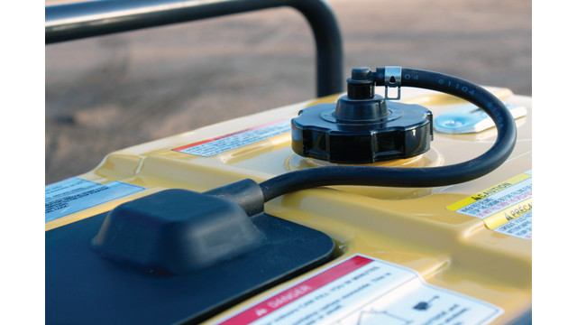

   / Running portable generator during inclement weather #34
Simple.... I like it. I can see that working out with certain generators.
When I think of mine, probably not. My smaller one would be too hard to balance that on, and my larger one would be a good candidate, but, the recently mandated tank vent line comes out of the fill cap, right where you'd want something like that weighted down.
On older flat top gens, I can see that pool trick working well.
Rgds, D.
That's mine... it's newer but flat top, no vents (that i can see). Even if there are some fuel vents, the pool doesn't seal anything off.
The pool idea came too out of necessity. It was raining and we needed power... needed a cover and it was sitting there looking at me. At first I used cinder blocks on top, but the sandbags seem to be more secure.... and, well, i used the cinder blocks elsewhere.
Necessity is the mother of invention... right?
-J

Got that T-shirt :drink: .... I can see making that choice myself.
If mine had a vent line like this Subaru is setup, (90 deg. fitting on the cap), then I'd be buying a kid's pool.
On my Briggs, the gas cap fitting sticks straight up, with the vent hose sticking up fairly high. And.... I know if I dared pull that line off, within 10 minutes I'd have a fleet of those blacked-out Suburbans pulling up at my door.... :rolleyes:
And/or the black helicopters..... :laughing:
Rgds, D.

I'm jealous... I need the shirt!
Snagged this pic off the web, but it's identical. You can see, no vent... and when the handle is down the pool rides on the frame bars and doesn't sit directly on the tank. Considering some pipe insulation or similar to help keep the pool from sliding in the wind. Hasnt been an issue yet, but just trying to stay ahead of the curve.....
-J
