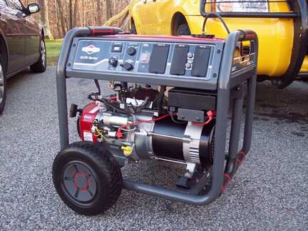

The exo-frame style is ideal for what you are doing J.
I don't have a pic of mine handy, this came from google images....
I like the gen, but prefer how Subaru routed their vent line.
