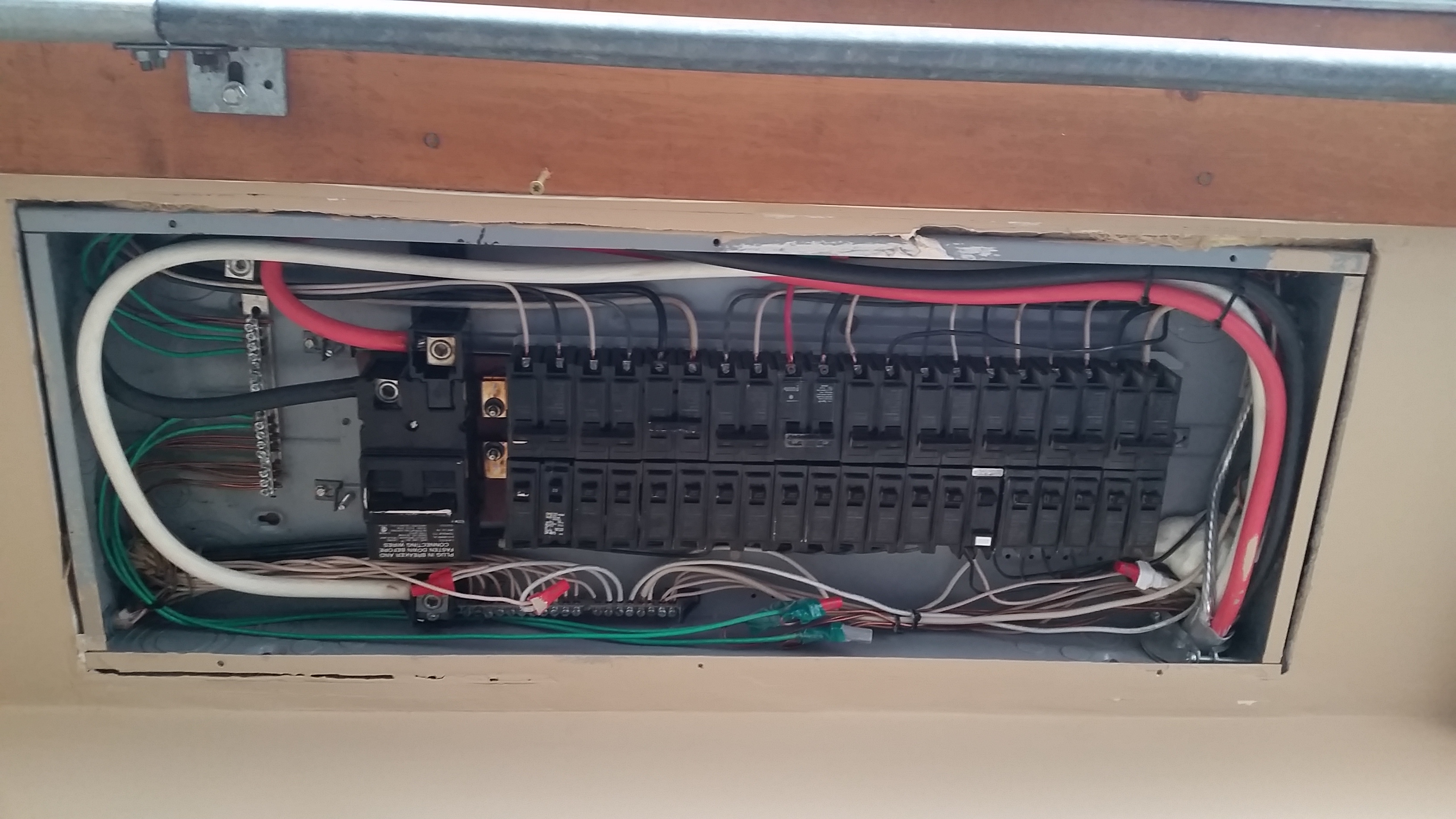

I have to see what kind of access is left in the panel and what about capacity? On a 200 amp panel can I simply replace the 60 amp breaker with a 90 amp?

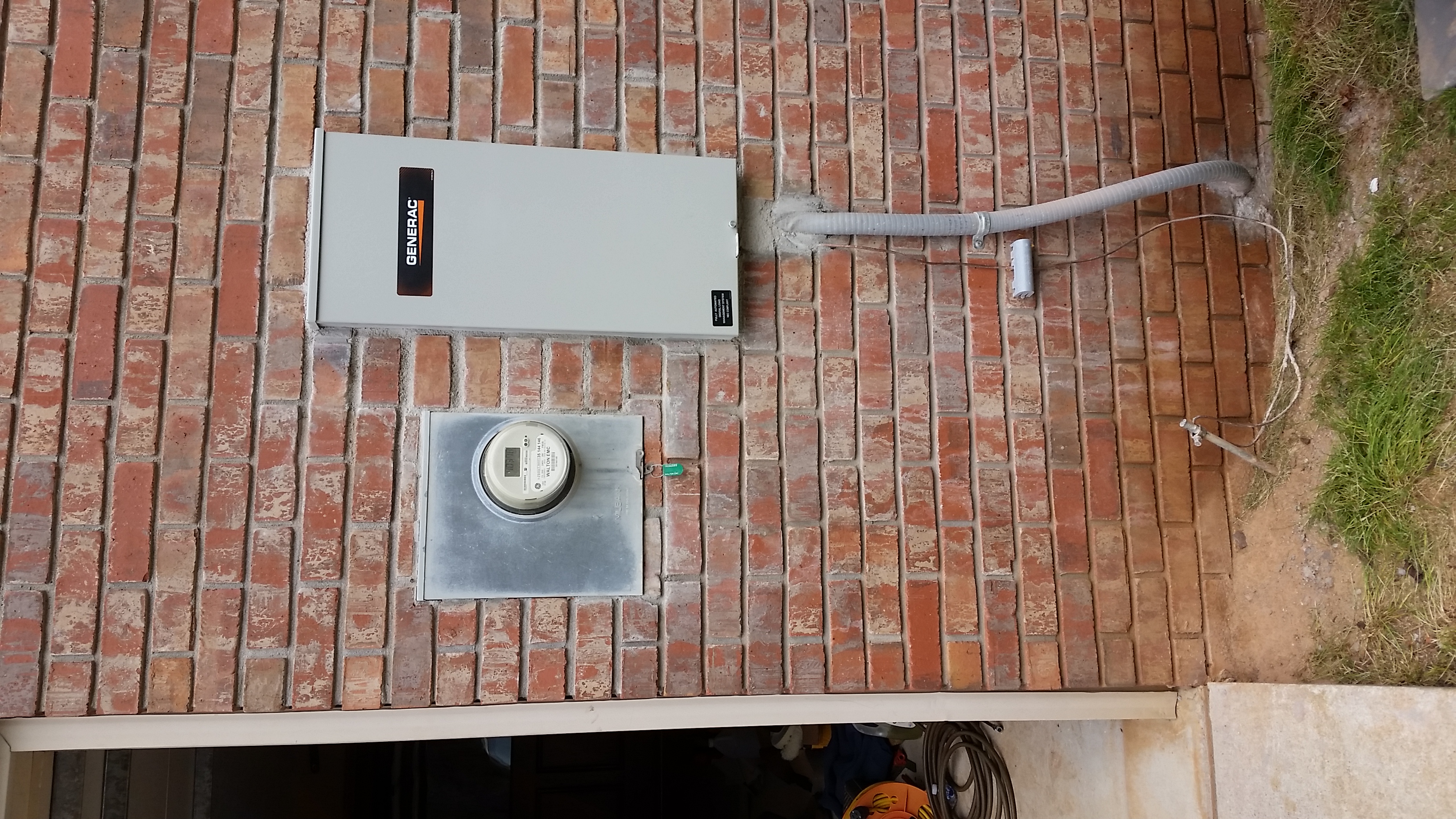

I'm seeing a 30 amp future in the barn.. The bottom knockout has the buried service feed in it and the jumpers from the transfer switch are in the way anyhow. The top knockout is clear but I'd have to run the conduit up that high outside and it would look pretty shabby.
This is the outside view, standing on the parking pad. The panel is directly behind the flushed meter.
For what I need 30 amps is fine. If I ever want to weld I think I will just have to get something self powered, no plans anyhow.
The trenching should be a real party, I have to cross the pool infrastructure. I see hand digging that part.

dont know what brand panel you have, but most will allow a simple swap for a 2 pole breaker up to 125 amps. Some older style paneks might be hard to find breakers fir
that panel is packed. You must have electric heat units throughout house. It might be hard pressed to get 90 amps out of this panel. I think your right on sticking to 30 amps. If you had a full shop, id think about getting another separate service installed for the shop, but seeing as its just lights and a few hand tools... 30 is goid enuf.
By the way.. what sized generator are you using.
