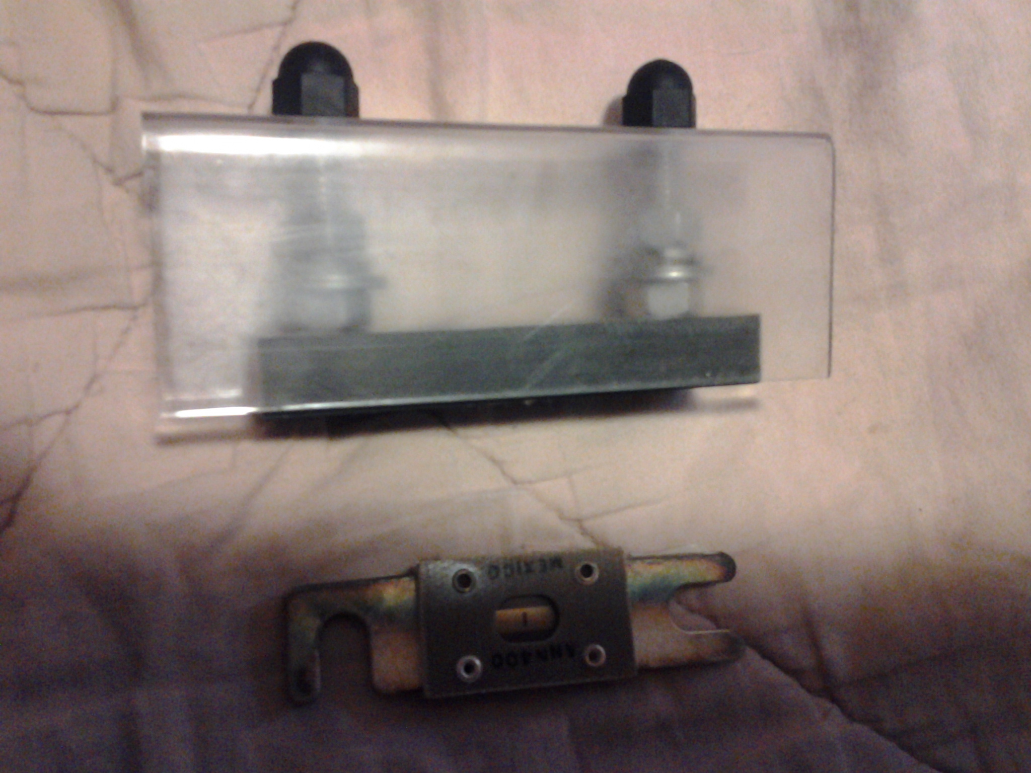

Bandaidmd, Difficult to compare Tommy Lift rating at 1,100 lbs to 14k dump trailer but here goes. Assuming the dump motor at 200A, the circuit breaker and solenoid should be rated for a max. 200A (Should be more? Less?). 12ga wire from solenoid to upfitter switch. No fuse needed. And no warrantee issues.
I realize I am over thinking this (It's my M.O.). Just want to do this once, correctly.

20131214_195942.jpgThis is the buss fuse setup, i use on snowplows and dump truck viborators. I use 250a up to 400a for most installs.
Dave
