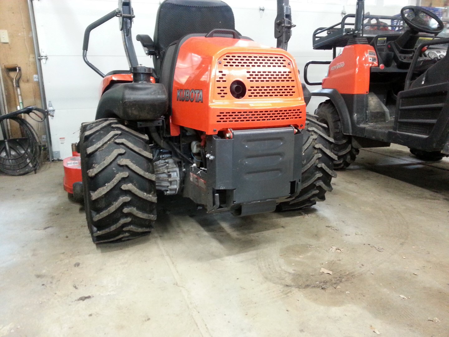

The bar tires look good but I'm thinking they will tear out the grass in turns more than the R4 because of the sharp corners on the side of the treads. On wet grass or slightly muddy areas the turf tires are just slicks and provide zero traction in my experience. I think the turf tires tear up the grass more because they have less traction and more slip.

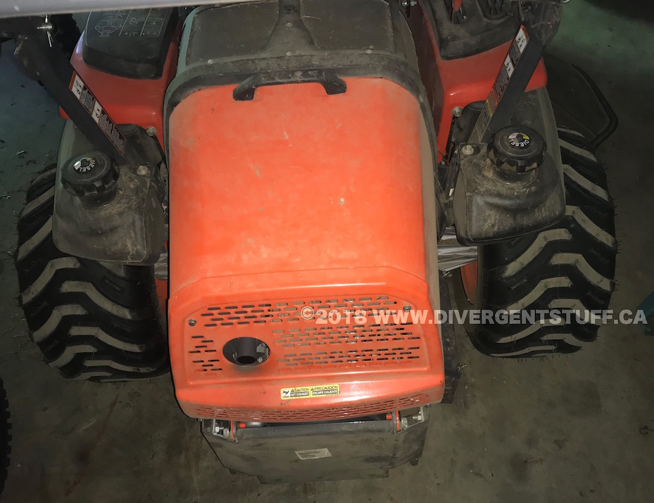

Here's an update for an older thread.
I just put on a set of WT300 turf bar tires and the difference in control is day and night. I'm a convert!
Here's a link to my blog post about them with photos.
Quest for a better Zero Turn Kubota ZD326-6P Modifications Divergent Stuff

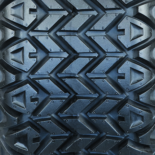

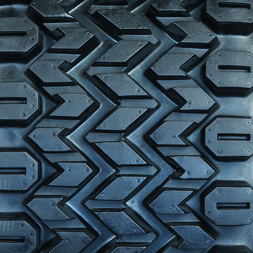

Probably the closest tire that is currently available (in terms of traction) would be the Carlsile All Trail or All Trail II. I have seen those on a few B series tractors and they (or something very similar) come on the Deere X series tractors: All Trail - All Trail II Tire
They also make a HD Field Trax that is similar: HD Field Trax Tire

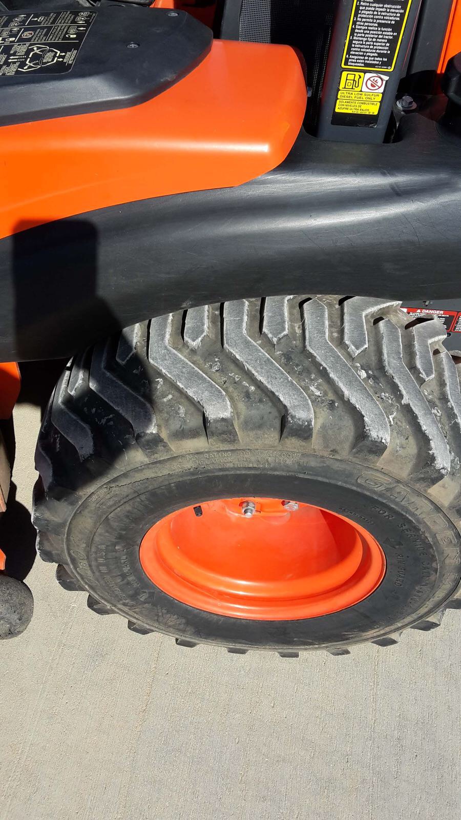

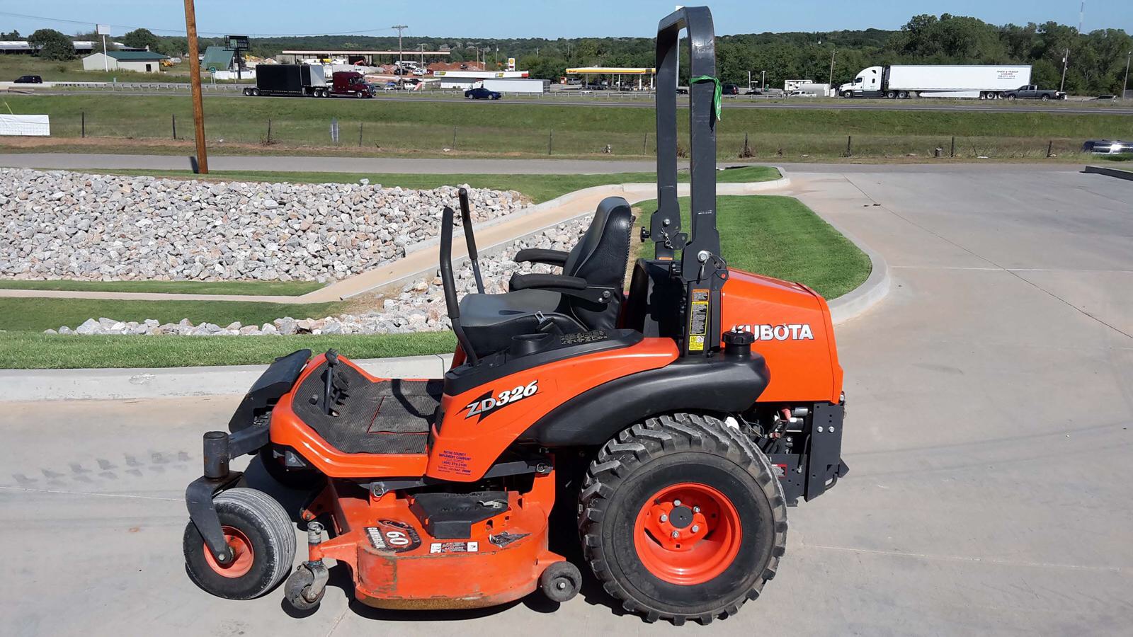

Here's the Carlisle WT300 profile from their website. Rounded corners make it a little less aggressive on the turns.

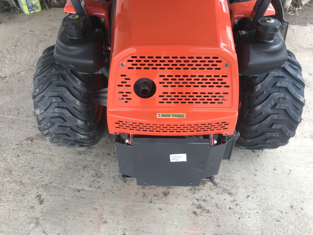

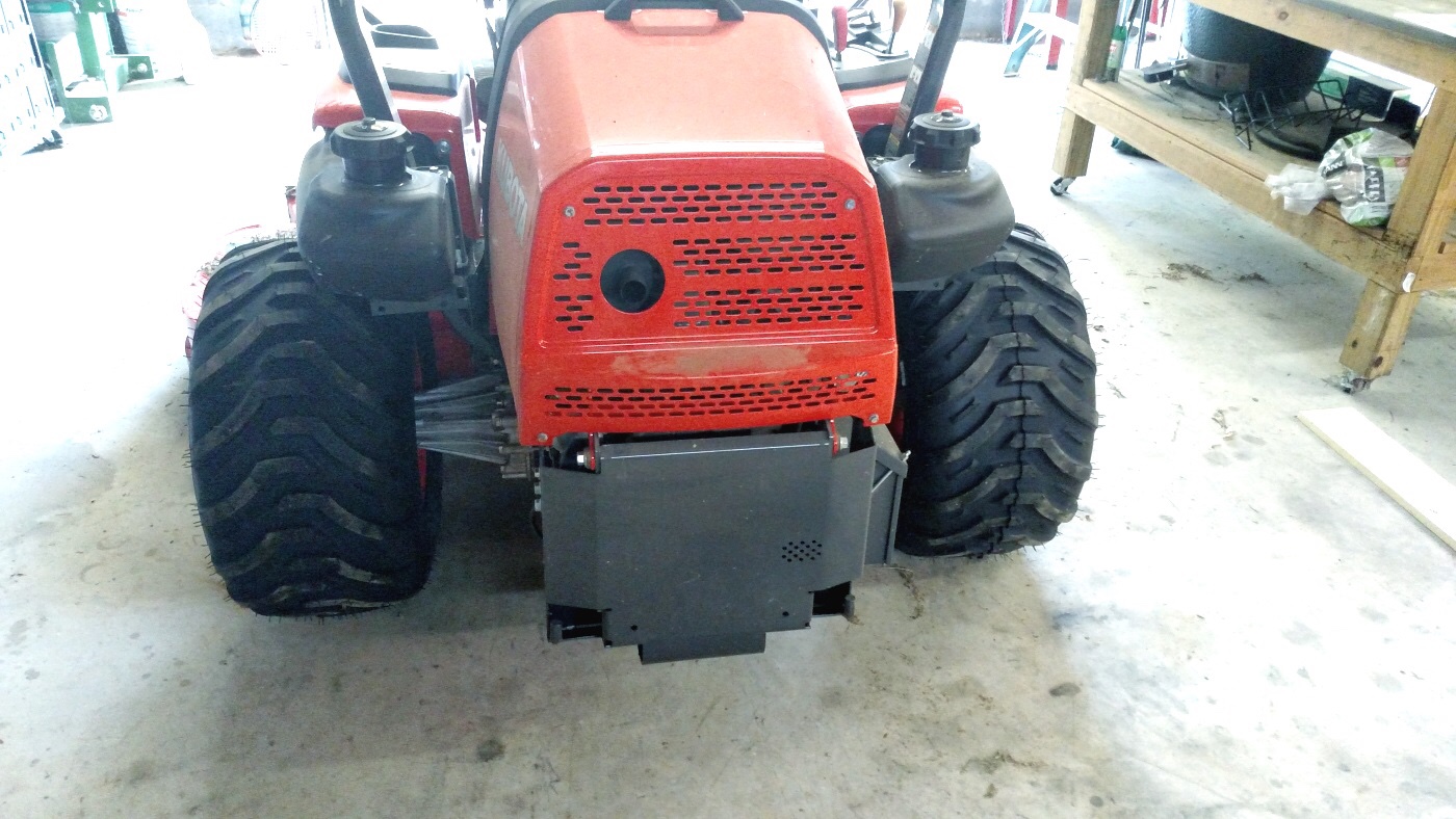

I just put WT300 tires on my ZD326P this spring and really like them so far. Much better traction and they don’t seem to scuff the turf as bad as the original tires that came on it. If been running ZD machines since 2002 so perhaps I operate the machine better now than when I got my first one. I’m glad I upgraded

Looks great!! I may need to get a set! Were they hard to mount like mentioned in blog post above?
