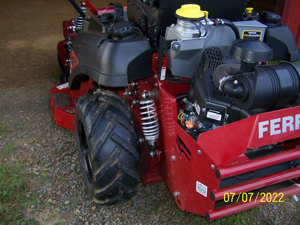

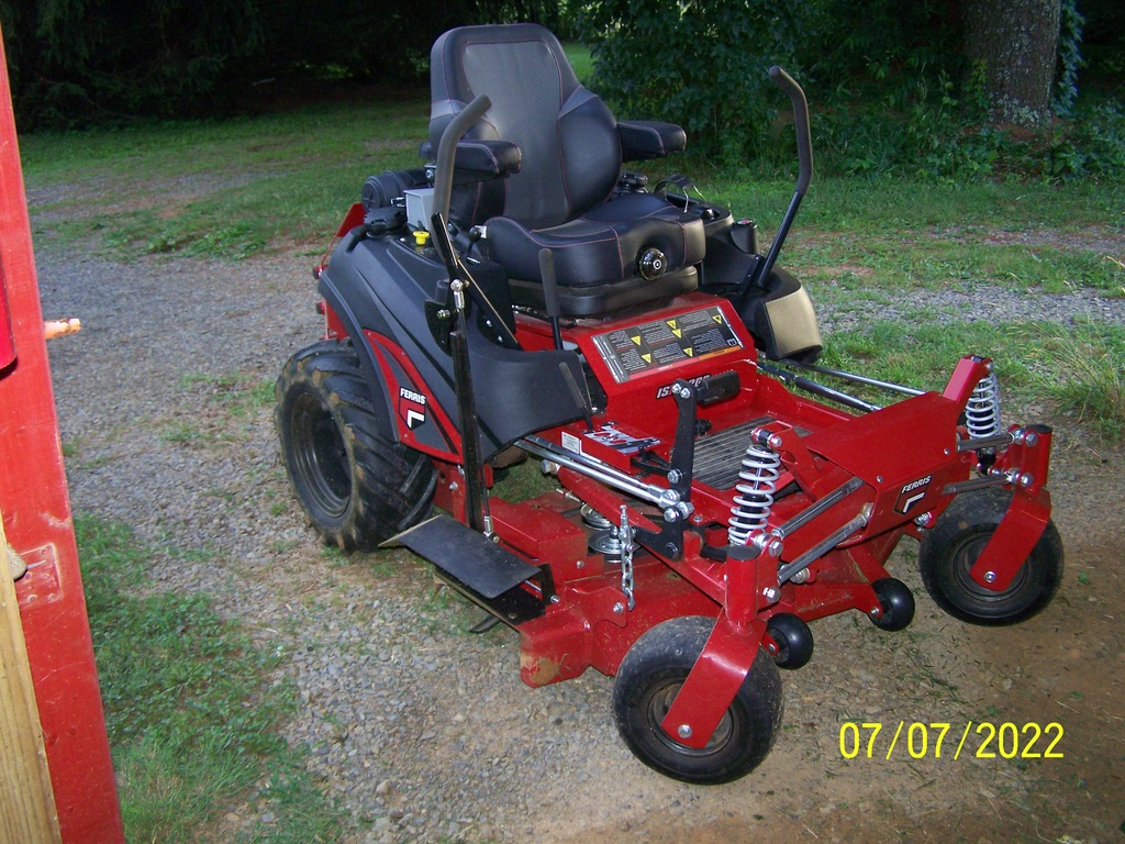

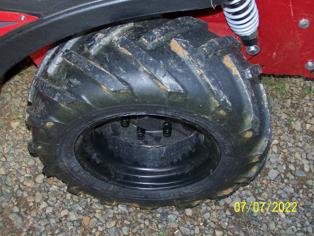

Well I got my tires today. They are a big improvement over the turf tires supplied by Ferris. I've run this style of tire for about 18 years without issues so I thought another set would be a safe bet. Judging by the responses to this thread others have had good luck too. I mowed today right after a heavy rain, only place I had some turf damage was pulling a hill. BTW they are rated at around 1,300 lbs ea.
I thank you all for your input!

Switching to Carlisle AT101 bar tires was the best improvement I made to my zero turn. You should be happy with your new tires, similar design. The AT101's eliminated wheel spin but introduced whip lash because the zero turn just went when you threw the bars forward! Never going back to normal tires.
   / ATV tires on a Zero Turn? #27
Can't argue with that style of tread, it definitely works. And usually on a tractor forum when people are concerned about leaving marks they're talking about MUCH heavier machines. I think most zero turns could drive all over the place with those tires not leaving any marks unless the ground is wet, or you're turning sharply. Glad you got what you wanted out of the upgrade!

WOW, independent front suspension with shocks even. That is one mean machine.

Take a look at photo #3 these new models have four wheel independent suspension. The seat has an adjustable suspension along with lumbar and tilt on the back.
The vanguard engine has a separate oil tank that holds 5 qts. of oil along with the filter and allows for 500 hr oil changes . This also allows the engine to run at 45 deg. tilt without issues. It's a lot more complex than my old 1000z rigid frame but it rides sooooo much better. It's a lot more mower than I need, but should be my last.
   / ATV tires on a Zero Turn? #30
I was looking at the pics trying to figure out if the rear was independent.. figured it would be strange to lock them together since it's two different transaxles with two different sets of controls in the first place. 4 wheel independent suspension.. heck yeah man! That may be the kind of zero turn i'd actually appreciate. The ones without suspension i've used on my property (i fix mowers for a cousin occasionally) have been too rough-riding to take advantage of all their speed on my lumpy land.
Having a separate oil sump which is usually tall and narrow to provide a consistent oil feed regardless of tilt/bumps etc is called 'dry sump oil system' on cars and is usually reserved for expensive race-ready types of vehicles which slosh their oil up into the crank on hard turns, or dedicated off-road vehicles that tilt to extreme angles. To have that on a lawnmower is pretty dang cool.
Looks like a pretty sweet machine!
