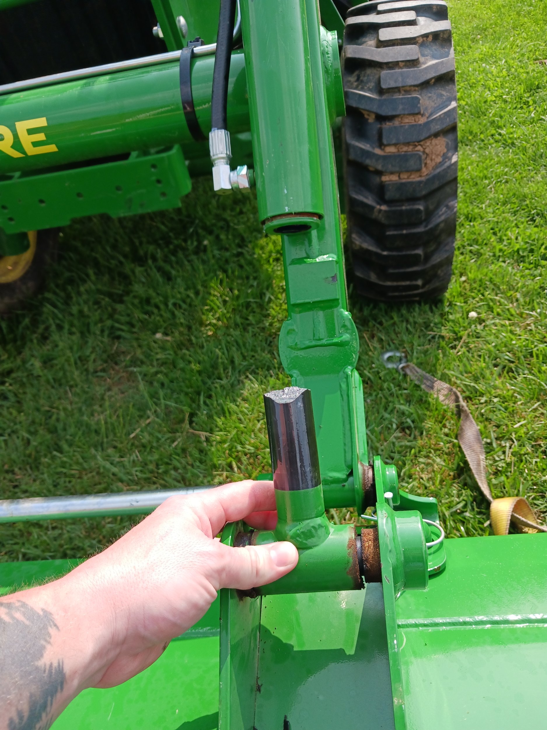

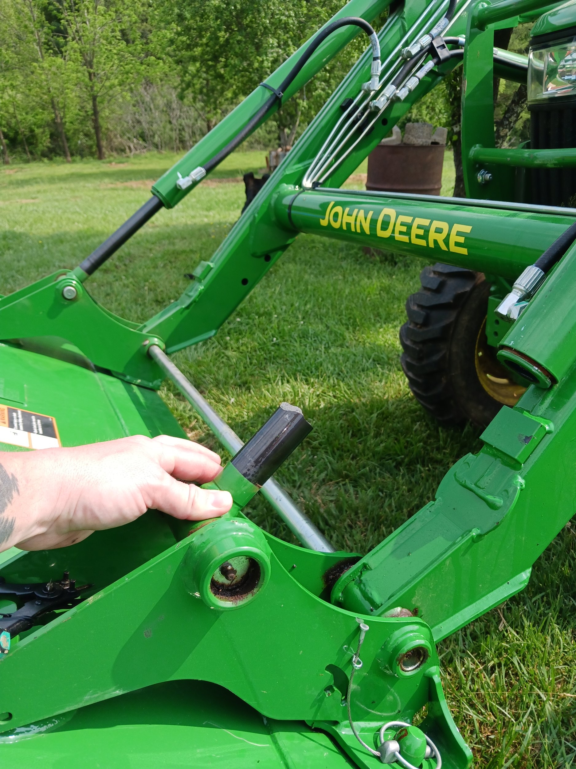

Hello all, I'm new to tractors and hydraulics as a whole. I have experience with most other things though. Yesterday the left cylinder piston on our front loader snapped in half. Of course the replacement part is about $1200 that we don't have right now. I really want to use the brush hog this week for clearing some brush. I plan on getting the cylinder repaired/replaced once the money is available. My brother and I removed the cylinder to try and get the remaining piston rod out of the cylinder but can't seem to do it yet. So what I need to do is figure out what to do with the supply and return lines that went to the cylinder in order to run the tractor without risk of damaging the pump or something else. Is there a way to do this? I figured I could couple the two lines together and it would work but I can't find any info on this. Also worth noting, I lost a lot of hydraulic fluid when the piston cracked in half and retracted into the cylinder. I didn't realize it cracked before retracting it too far. Any of your help would be really appreciated. It's a 2022 4044m with a 400e loader. The cylinder part number is AHC13628
Thanks!

I would plug each line separately do not tie them together.
Then, that should be a quick detach loader. Carefully remove the loader from the tractor which is then completely usable.
You could take the cylinder to a machine shop and have the piston rod welded back together.
Just guessing that you were back blading with your bucket when this happened.

It looks like there is something wrong at the rod end connection. There is a lot of rust and the cross pin looks out of place, to deep towards the middle of the loader frame, like a piece is missing, flanged bushing, etc. Maybe something went south at that connection and that's what caused the cylinder rod to bind and then break.
Yeah I'm not sure if something is missing, I'm going check the other side and see if anything looks off. I don't have a good eye for hydraulic stuff so thanks for pointing that out.
