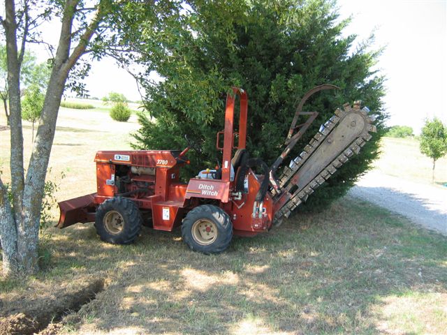

I dug more than 600' of trenches in about 4 hours today, but managed to cut my phone line. Twice.
There is a telephone pole and the phone box on the south side of the building, so I was very surprised that my phone line comes in from the north and then goes around the building. I don't know what to do about it other than to splice it.
I learned that there is quite a bit of hand digging involved, so I am nowhere near finished tonight. There is dirt in the ditch everywhere that I dug a T one trench into another. I think it would have been better if I had not intersected the trenches and dug a little by hand, although the ground is like concrete.
I had been concerned about digging through the gravel drive, but it turns out that was the easist part of the whole thing. I guess there was more moisture under the driveway.
I will be missing church in the morning because I need to try to get the pipe in while I can cover it with the Ditch Witch, since it has a front blade that goes up and down and also will angle.
It was so hot today that I basically could not do the hand digging without getting exhausted. I have this to do, I didn't realize there would be so much hand digging, as it just too hot and I am getting too old to be doing that.
I think the heat index was like a 110 today, and the actual temp was at least 102, when I looked at the thermometer.

I frankly was not all that impressed by this trencher. I had to go very slow, like an inch or two at a time, and I musta killed the engine 20 times. This thing is supposed to dig much deeper than the 24" I was trying to dig. Frankly, I got maybe half of it that deep, some deeper, and some as shallow as 12 or 14 inches. This trencher did not dig easy at all, but I did get about 650' done in about 4 hours.
The thing is very loud and the hydrostat did not work very good. It has no brakes. There is a forward and backward pedal, plus a hand control for the same thing. But the backward pedal would not work, you had to use the hand control. If you let go of it, it would slip out of place and the next thing you know it would be going forward.
These things take a beating. I'd hate to have to maintain one. This one had 882 hours on it. I see where the rental yard has them for about $25K used, but I wouldn't give $500 for it.
The good news is that I got my water lines in today. I trailered the trencher at 10:0 tonight. Fortunately I got some help from my son-in-laws' dad, and we got it done after cooled down to a mere 99 or so after 6:30. I am beat. Won't be tackling another project of this magnitude for a while.

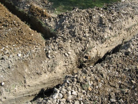

I finally downloaded Picasa and got my pics below 100K. Using XP it is usually easy, but for some reason these pics only shrunk to 110K or so. So here are some pics of my trench. I now have all of this covered in and water at 6 new hydrants. Works great.
