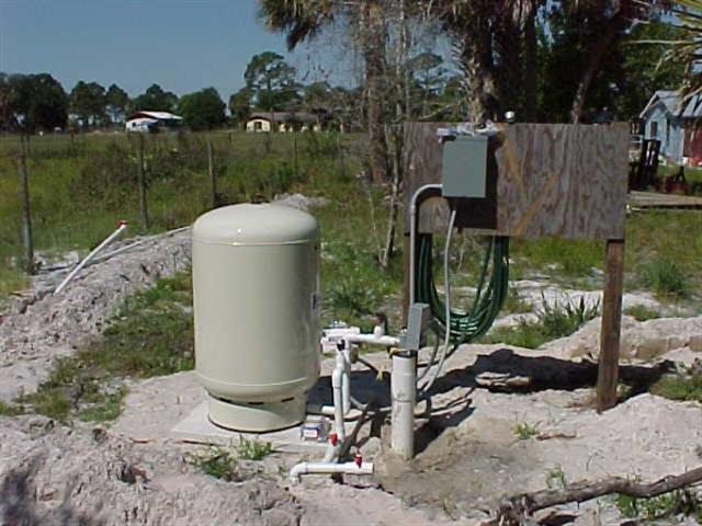

   / Running Water Lines #25
Your pressure tank issue is the reason a Master Valve/ Pump Relay setup is used. The Pump relay bypasses(parallels?) your pressure switch, and turns the pump on or off.
Here is a page with lots of good info Strykers irrigation page
   / Running Water Lines #26
I backfilled with the FEL on my tractor; the walk-beside trencher didn't have any sort of backfill blade and even if it did, it would be way too slow. The walk-besides are NOT very maneuverale. If you're lucky, you'll get a fancy one with hydraulic steering; even so, they steer about like a pencil through a pound cake.
I got my bell-end pipe from a specialty company, Okeechobee Pipe and Fittings, which does exactly what their name says. I think the bell-end pipe was slightly less money than the straight pipe with a coupler, and it was twice as fast to have only one joint at each coupling. LIke Eddie, I used purple primer and clear glue.
I don't have any problem regulating the flow; but maybe the size of my pressure tank has something to do with that. See attached.

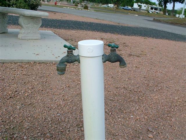

A jump from 1.25 inch pipe to 2 inch is HUGE! You gotta realize that a general rule of thumb in guaging pipe is that for every half inch in diameter that you increase, your capacity increases 2 1/2 times.
Distance, friction and elevation also factor into this, but thats where the engineers come in to play. I've looked the formula up on the internet once, and was totally lost. For me, and for your application, this is good enough.
If your pump is cylcling and having issues with 1.25 inches, 2 will be way too much. The added volume in 2 inches would be important if you wanted to have a certain level of preasure at the outlet, but for jus moving water from your well to your pond, your wasteing your money.
If you wanted to run sprinklers, then the 2 inch line would help because it will allow you to build preasure at the outlet when you reduce it to half an inch, which is the size sprinkler heads are. Greater volume allows for more preasure over long runs. Going down hill works even better!!!
The picture is from an RV Park I visited in the Kerrville area. They have a 3/4 inch pvc pipe coming straight up into a PVC T, then two spickets.
The PVC pipe coming up is wraped in insulation. The 4 inch pipe you see is a sleeve that covers the insulation.
No hydrant or anything expensive. Total cost is gonna be around $10. Cheap, effective and simple.
#28
Thanks for the picture of the "frost free" rig , Eddie. Now I get it, looks like a great idea.
