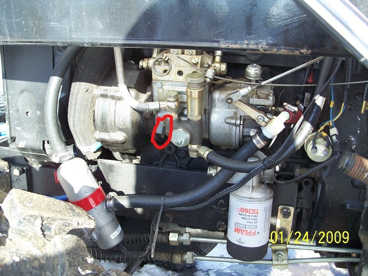

Speaking of lift pumps, does your tractor have a hand primer pump? This is usually a knob that turns to loosen, then the spring pushes it up. You open a bleeder screw or crack a fuel line, unscrew the knob and then pump in and out with the plunger to purge any air trapped in the system. If you forget to push the plunger down and tighten the knob it can be a source for air being sucked into the system.
Here is a picture of my injection pump. The primer plunger is the gold colored cylinder above and to the right of the red circle. The bleeder screw is the screw with a ring through it up and to the left of the primer pump.
I don't know how a loose or leaking primer pump could be temperature sensitive but we haven't determined for sure if the temperature is the cause or just coincidental to to run time it takes for the problem to show itself.
If you don't have a lift pump or a primer pump all this doesn't matter.
