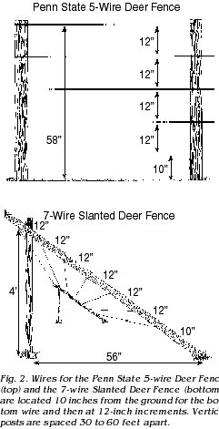

pub138fig2.gif works and is far cheaper then 9 10 or 12foot fence

I suggest this periodically and few have taken it up but I live in a dense deer population state. Pa has a million and a half (conservative estimate) deer. They have jumped over my 7 strand 4 foot high electrified high tensile steel beef cattle pasture fence for years. USDA Wildlife Services estimated the deer population at over 300 in the square mile at work(not where I live).
I use 20 lb monofilament fishing line stretched between fiberglass posts. I use two or three strands at about 2.5 feet, 4 feet and 5 feet.
The deer may destroy it a few times until they realize where it is (I doubt that they can see it) but they then leave it alone and don't cross it. It is effective,cheap and easily installed. I have been using it for 3 years now. Hard to believe? Well I'm not really worried if you believe it or not as it has solved my problem in two 1/4 + acre gardens. The fence line is marked by electrified polywire at 5 and 11 inches all around the garden, so the deer can see that and get a shock if they touch it as well. The polywire keeps out all the little critters. Great for anything that the deer eat. I raise up to 70 varieties including corn and english peas, and deer love them. www.nunamakerfarms.com
