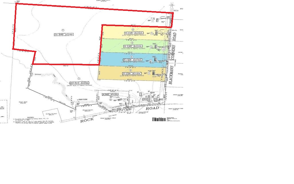

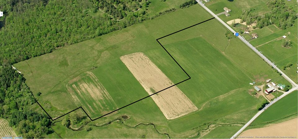

Hey all, newer to the forums.
We purchased 32 acres and are planning on placing the house to the back of the properties (or the middle to be more precise) so we can enjoy the open views. That being said, it means our driveway is 1300' long. Which in turn means an EXPENSIVE electrical run! The local utility (National Grid) is estimating $25k to run my power 1300 feet from the road to the house.
Anyone have a similar situation - what did you do? Can I dig it myself to save money and have them place it? I've looked at going off-grid, but the batteries don't tend to last long enough for a good ROI. Even the new Tesla batteries I'm a bit uncertain of.
I also need to run cable/internet feed as I work from home!
Thoughts/Suggestions?

Ask about going halfway overhead primary line and the second half secondary underground.See what the savings might be.

Is that the buried price? Can they do it on poles?
Do you have to do water too? Sewer? Phone?
It will cost you a small fortune in gravel to do a 1300 foot long road. Look up RDrancher on this forum for that. He's the best I've seen.

I had to bury my lines from the nearest pole which is on my property 2,500ft away. I was not allowed to use poles even though I own the land they would be on. I had a contractor come dig the trench and then cover it once the line was installed. I would call around to a few excavating companies or even ask a few locals if they know anyone who would dig it for you. Chances are someone will want a bit of extra cash and it will be much cheaper on your end too.
   / Rural Living #10
Wow, $25K seems high. In 2012 we paid a hair over $2K to run a primary about 600' from the road into our property, then get a transformer installed, and another 100' of service wire to the home. At the time that was a lot of unexpected money added on to the construction cost, since normally the power company does not charge for hookup at all. But in retrospect, it seems extremely fair considering the amount of trenching, wire cost, and transformer cost. I am sure the actual cost was far higher than that, and the power company may have only charged us for whatever overage is higher than typical -- perhaps the transformer and some wire.
So all that leads me to believe $25K is the full cost with no subsidy from the power company. I guess I'd want to discuss it further with them and see where the costs are and where they could be reduced, or shared, or maybe you can do the trenching to save some. In our case, the power company subs the whole thing out to a third-party, and they just show up with a mini-hoe, wire, and transformer on a truck. There wasn't anything special about the trenching that any other person couldn't do with the proper equipment.
