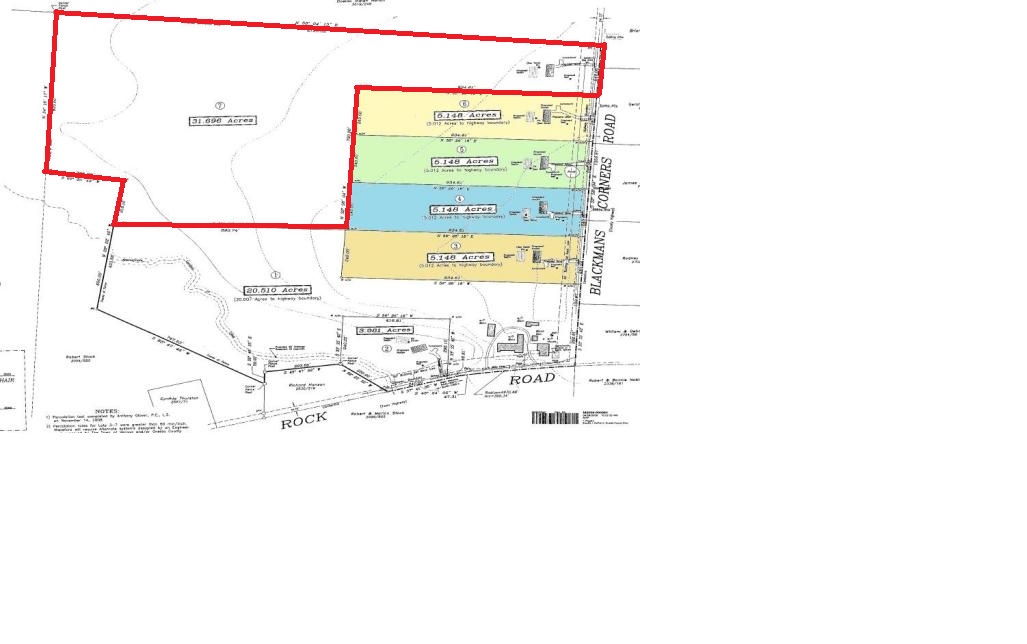

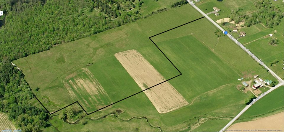

Here are a couple of pics...of the land. First is just the surveyors map, second is an aerial view which will give you a better idea after looking at the first pic! Driveway comes in off the road, we turn left at the property marker, go in about 250 feet and the turn right - heading another 50 feet back. That's where the house will be. LH side of the property from there will be for haying. RH side (and along driveway) will be for grazing. 6 cows, some sheet, pigs, etc.
