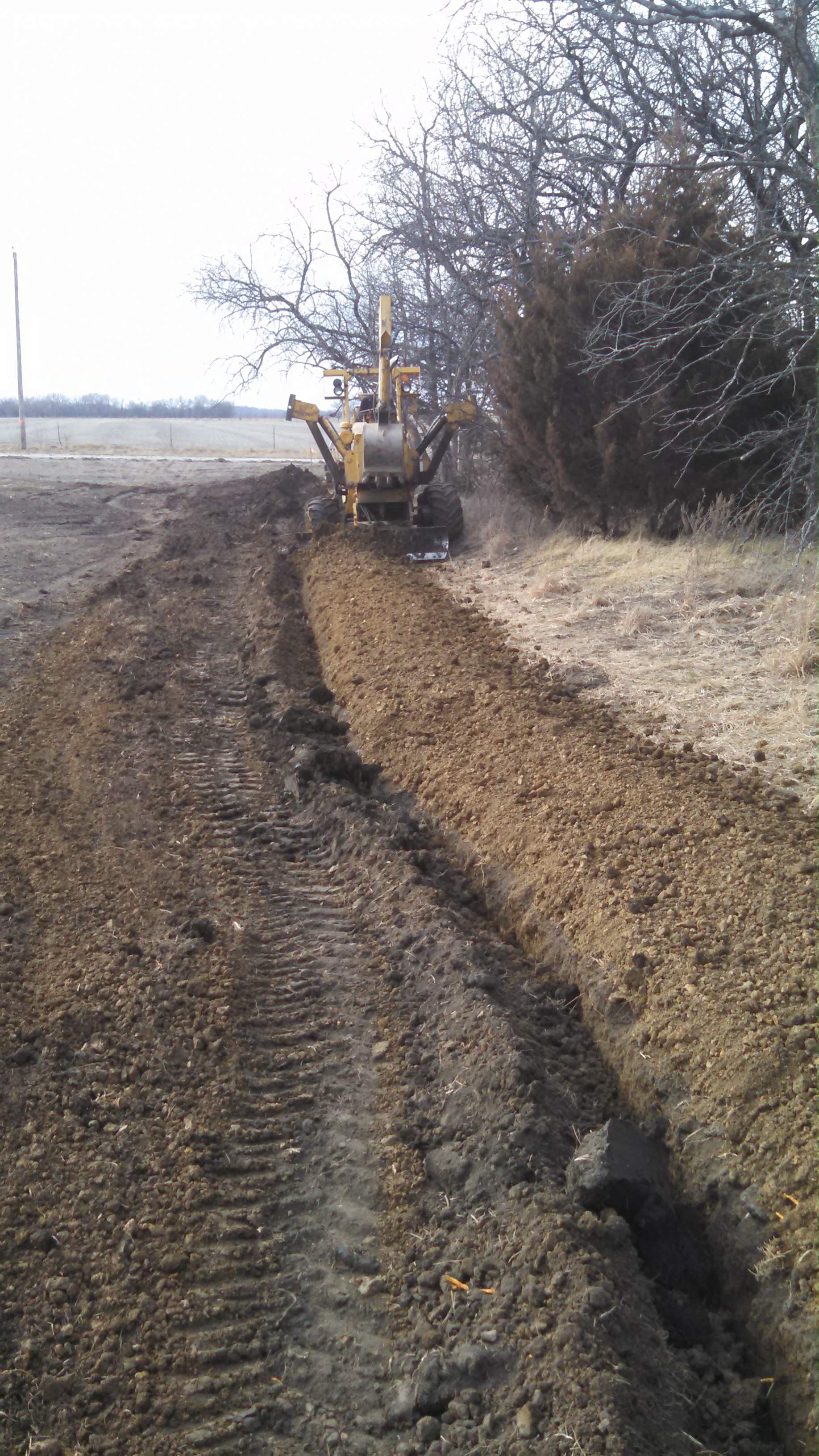

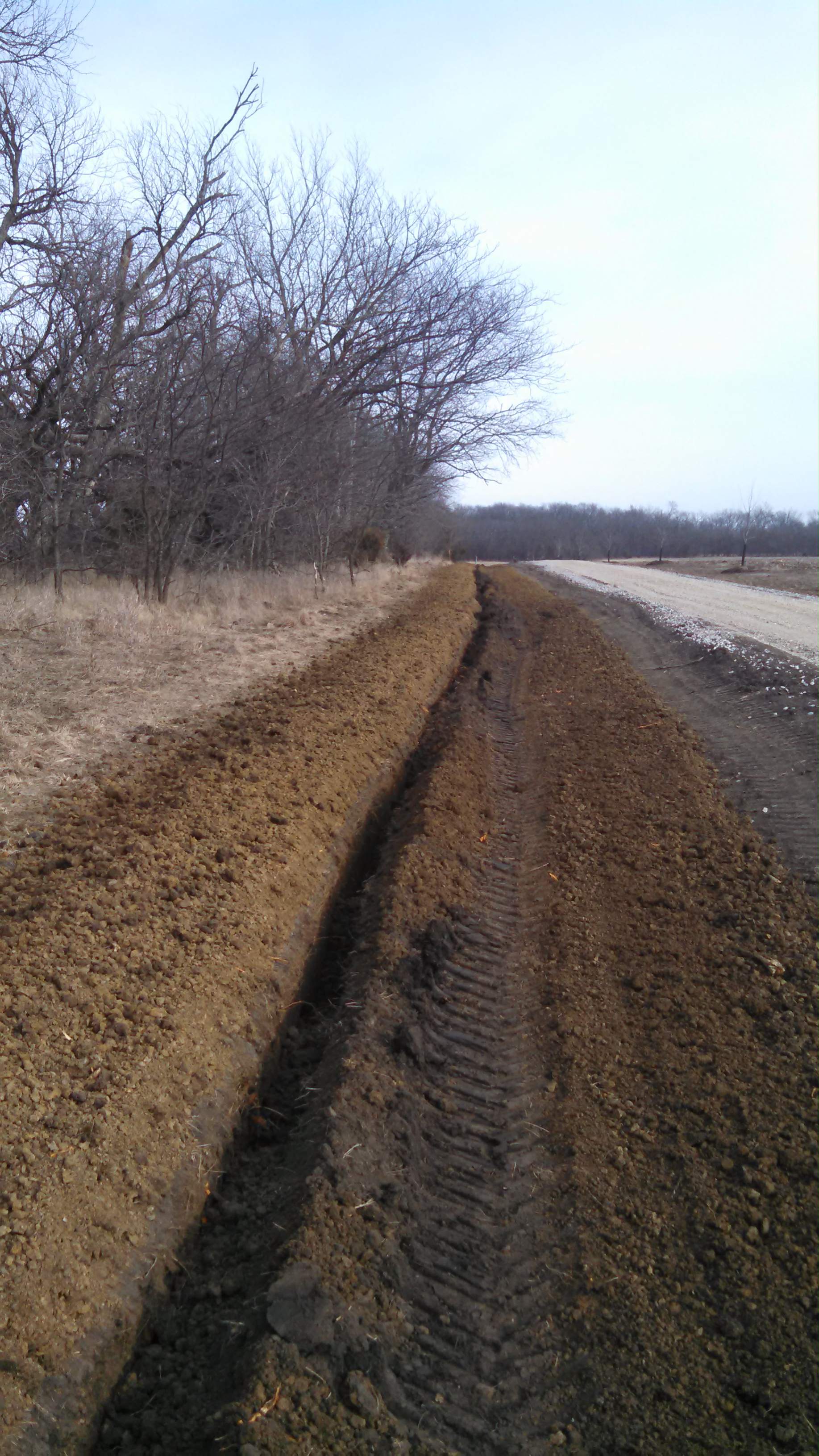

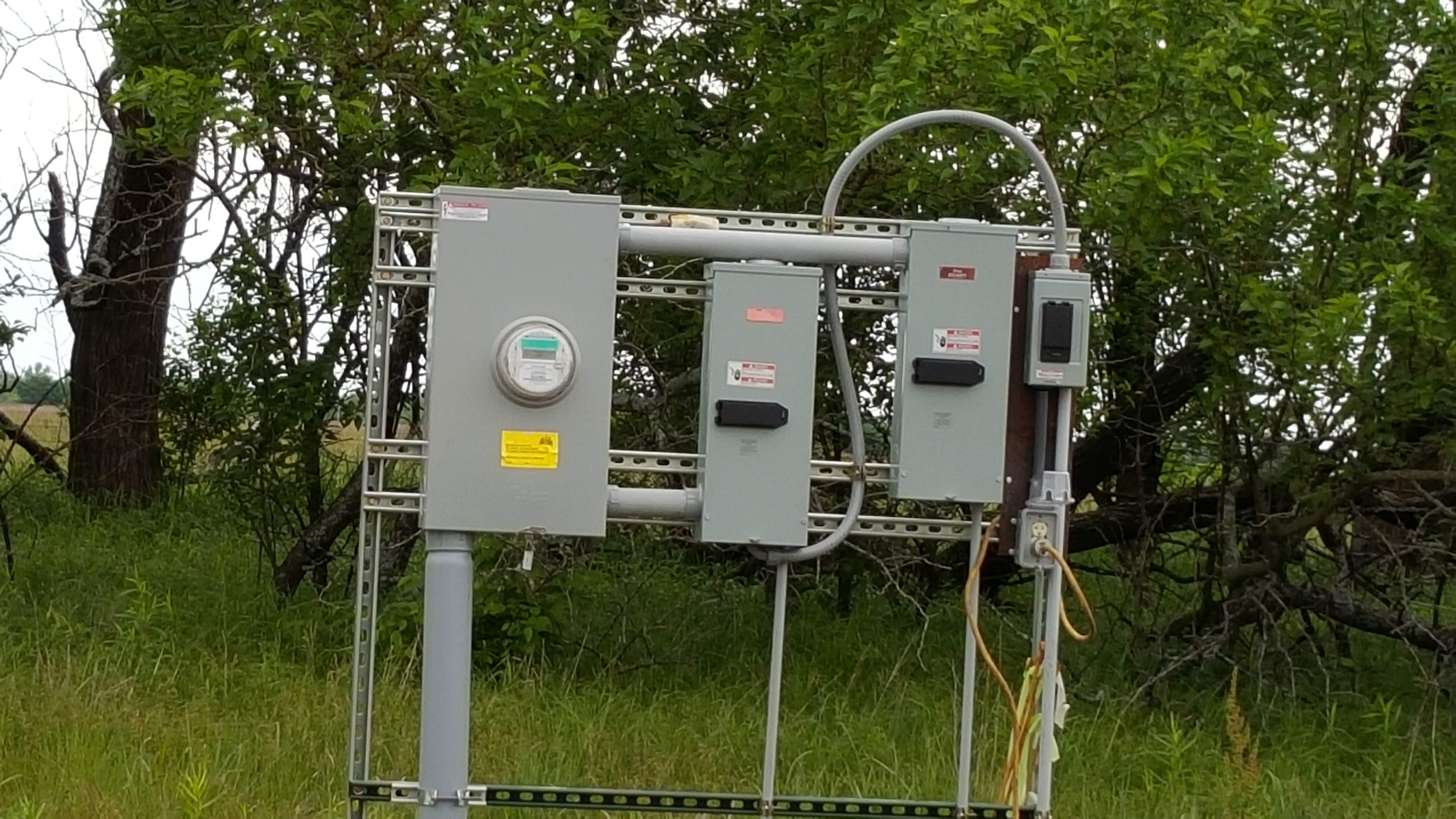

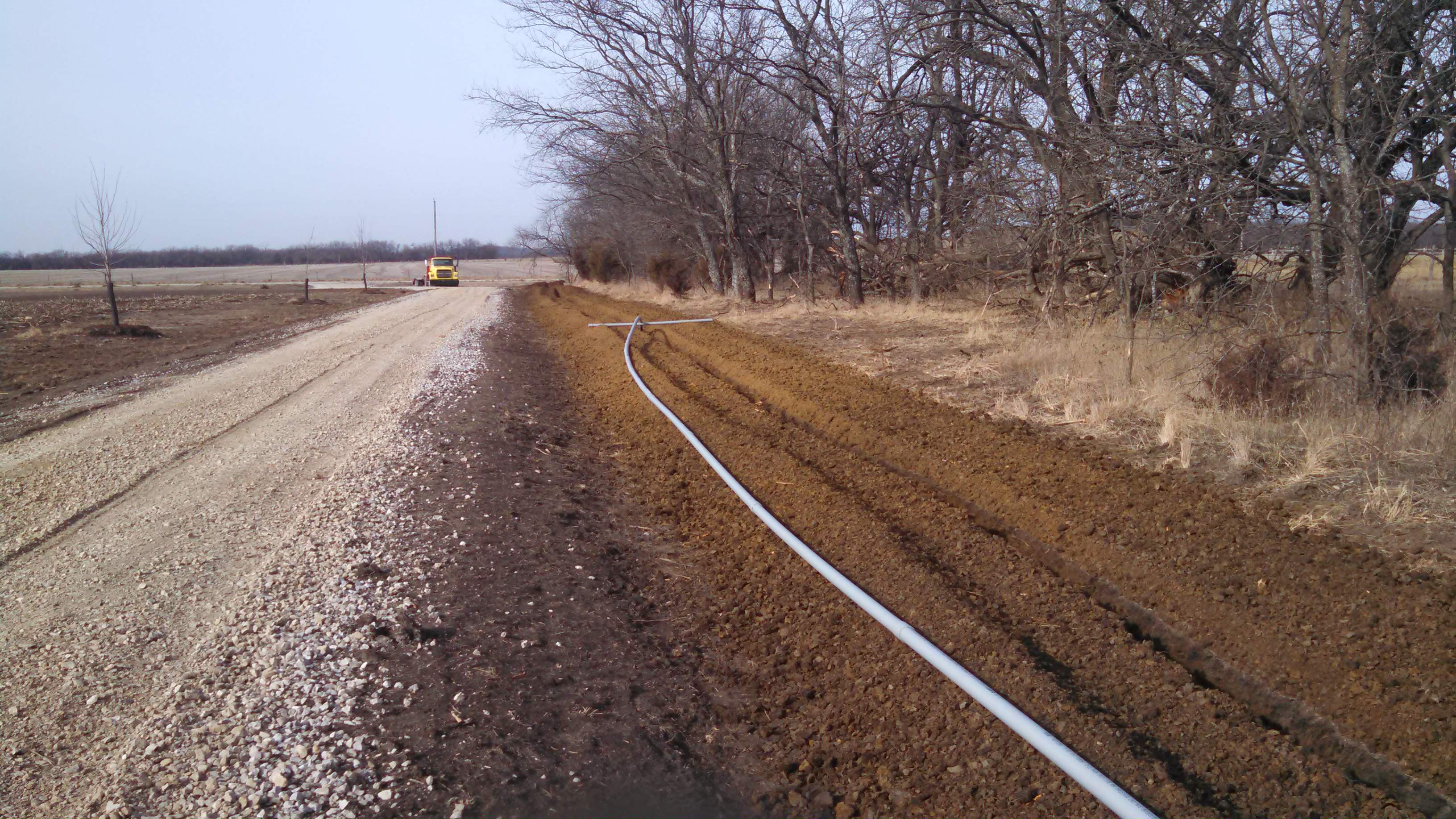

Every power company is different. Mine covered the cost of the pole to bring power across the street, the primary wire, a pull box, and the transformer. I'm in the middle of building a house on our 92 acres and wanted the house 1100' back off of the gravel road. The power company planner came out and I showed him where the house was going. He marked a spot for a pull box and another for the pad transformer. I hired a guy to do the trench and I worked behind him putting string in the pipes and gluing them up. The trench cost me $1100 and the conduit, sweeps, and string cost about $700. I also purchased a 320 amp meter can and two 200 amp disconnects. Since they charge for temporary power, I purchased a small 70 amp breaker panel and did my own temporary power outlet. The electrician wanted $6500 to do everything and I did it myself for around $2200.
Try and find out what you are allowed to do yourself. This is where you will save some money.
