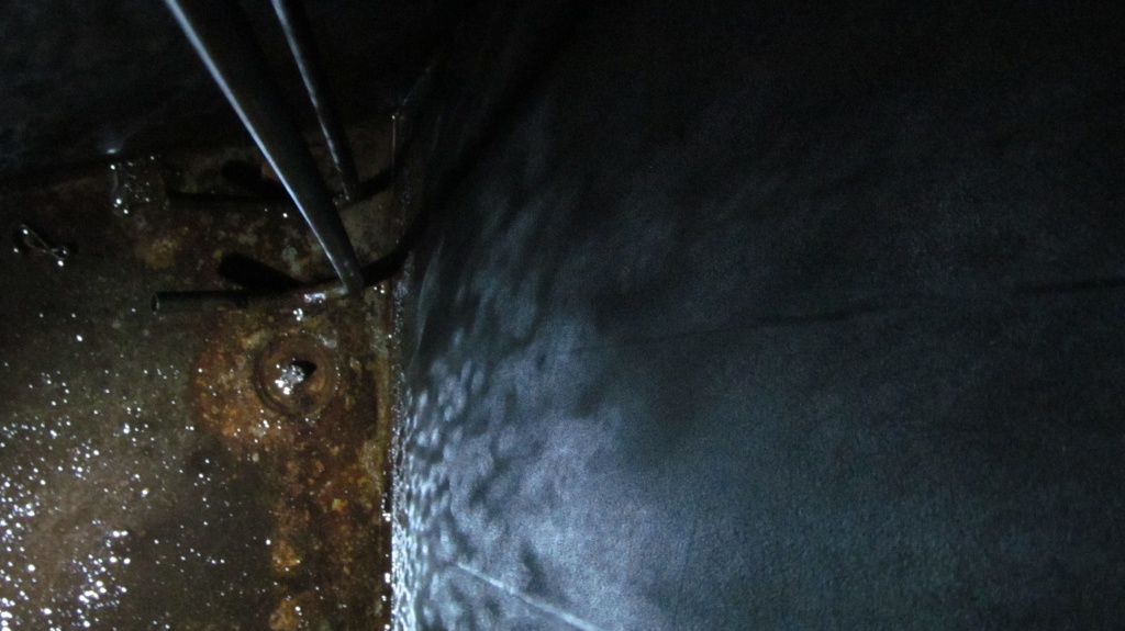

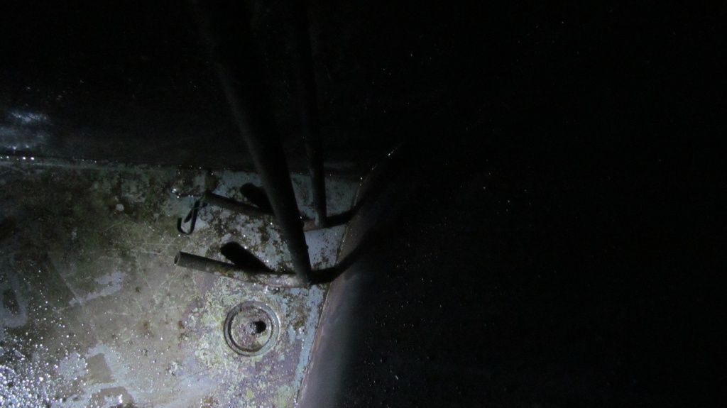

My backhoe had the fuel system clogged with rust when I got it. The tank was just rusty on the bottom. I cleaned it out with a pressure washer and put a mixture of 50% water, 50% vinegar in it and let it sit a day or so. Washed it out with the pressure washer again and dried it out with a heat gun. I added a small engine fuel filter on the supply line so I could monitor if it got more rust and had to change that once or twice but no problems since.

   / Rust in a fuel tank #33
Before View attachment 496324
After View attachment 496325
Amazon sells a 45degree angle adapter for pressure washers that works well, it quick connects between the wand and the nozzle.
That might make it easier to get around and into the corners.
