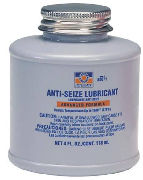

I use Permatex anti-sieze on the lift arms and top link threads.
